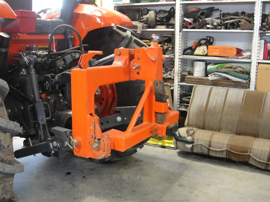

This or some variation of it. Mine will fit my QH on the Kubota or hitch to the 3pt on the Ford.

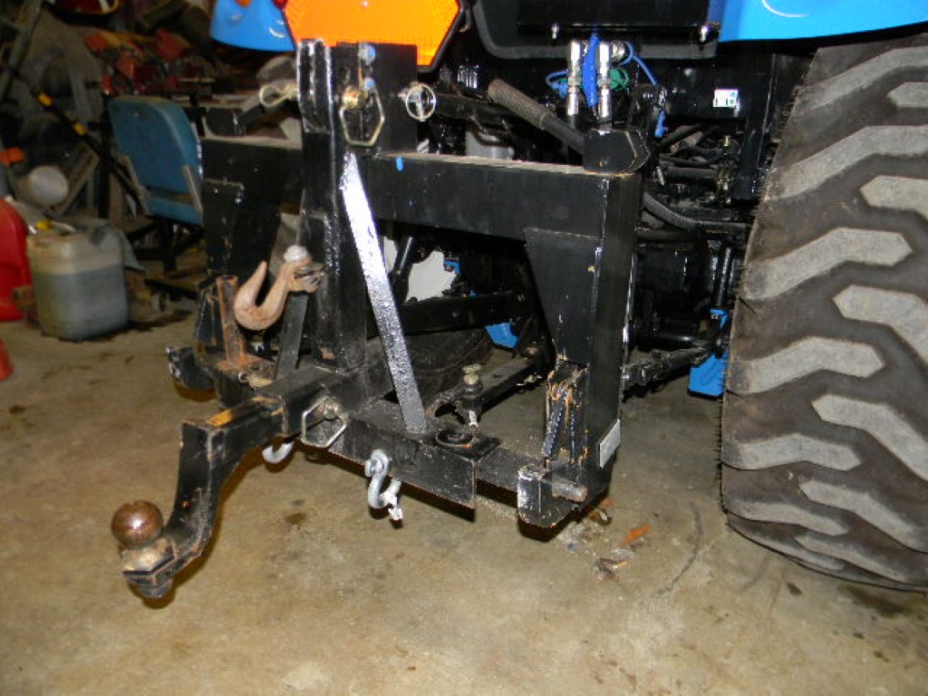

I built this one for moving trailers around. All my trailers have a lot of tongue weight so I don't worry about the 3 pt. arms lifting. Made mine from a used draw bar between the lift arms, angle steel, used Reese type receiver, some square tubing. Basically just stuff I had laying around the shop.
The coolest part about these is ease of use. Right behind that is versatility. Look at George's and mine. We have accessories welded to them to use on multiple tasks.
For the OP, he describes a situation of moving a dollied down trailer in/out of a building. Perfect setup for these hitches. Forget the trailer jack. Simply pick up the trailer hitch with the 3pt and move.
I placed a large ball on top of the tower of mine so I can move my GN. I've pulled my GN several miles hauling pipe using this setup.
When splitting a trailer load of wood I use it to spot my trailer mounted splitter and/or the trailer. Hitch/unhitch and never leave the tractor seat.

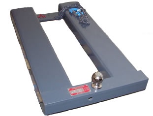

I would put it on the loader. I have a contraption that slips over my pallet forks and we use it to move trailers all the time. Works great and is really easy to put the trailer where I want it as I am going forward.
We have about six trailers and at least one or more of them gets moved weekly this way from the single axle bumper pull to my 32' tandem dual gooseneck and even my 53' semi trailer.

I would not recommend it. I did this and while it worked the heavy tongue loads on some trailers bent that fork with the ball in it down slightly. Not a lot but it is maybe 1" lower than the other fork. Makes it a pain when trying to pick up things with the forks as they are no longer even.
Just weld something up out of channel that slips over both forks and has a ball in the middle. I built mine from scrap in less than an hour.
