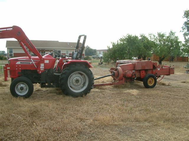

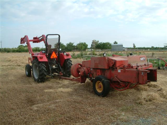

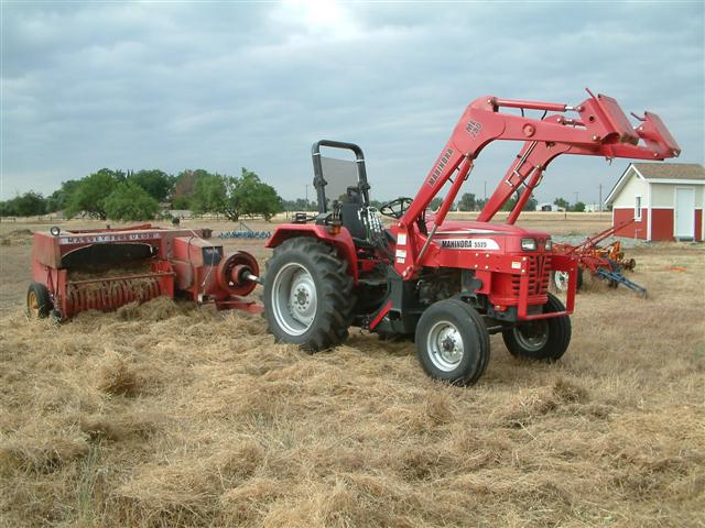

I bought my Massey Ferguson 124 baler (two twine, small squares) several years ago right out of the field--the seller baled 30 acres the day before I bought it. Cost: $2K
Stay clear of balers that have been "field stored" any length of time unless you know enough to evaluate the condition of such balers or have a friend you trust inspect the baler before you buy.
I'd get the seller to run the baler for you (bust open a few bales and hand feed them into the pickup) to make sure it works OK. Check the baling chamber for excessive rust on the walls (which is a problem if the baler has been stored with hay packed in that chamber).
Check the slip clutch on the pto shaft for worn face plates (I had to replace the plates on my baler right after I got it home).
There are a lot of JD and NH balers around and you can get parts pretty easily for these. Check parts availability before buying other brands.
Good luck
