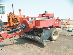

Case IH 8555 baler with new knotters and several wear parts replaced
I've never used an inline before, but after reading up on it I think it'll be ideal as I recall years ago farming this place we had really thick windrows then really sparse windrows in the same cutting.
It's just about impossible to get a consistent windrow without a ton of raking. I plan on doing mostly horse hay orchard/grass but I'll have spots with oats and alfalfa too.

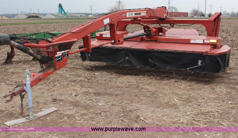

1340 twelve foot hydro swing mower conditioner
I've only used the old style sickle cut never a drum style and I'm nervous about rocks! How do the drum style handle rocks and gopher mounds? I don't want a rock to take my head off, should I bolt a piece of ply-wood to my ROPS?
:laughing:
I don't have a ton of rocks, but being river bottom it has a few spots with small to cantelope sized round river rocks. Normally I can pick up the implements and miss most of it, but you know how you miss a few here and there......
I love the idea of easy to replace cutters, those sickle styles were a pain in the rear, I riveted on a ton of knives and guards and that's no fun.
Also, how are these on hay that's lay'd down? Had that problem before where the old sickle swather wouldn't pick it up very well (plug up) then the baler played heck trying to feed long stems and stop it from picking up.
Now I'm thinking it's too much for my tractor to handle 4x4 M6800 Kubota

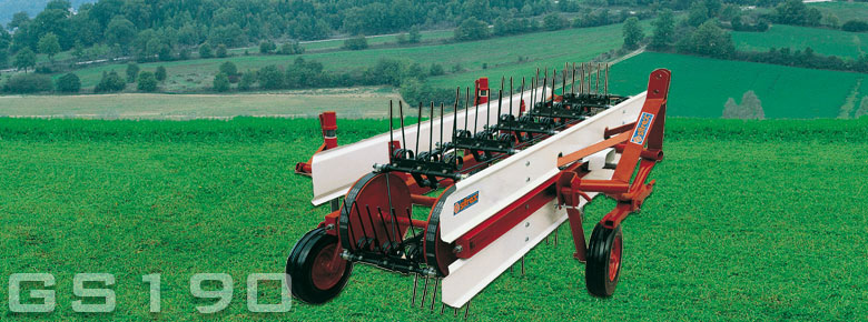

2013 sitrex belt rake bought new last year
Assuming it's the smaller version, how do these work on less than perfect ground with gopher mounds and such?

Disc mower conditioner is definitely too big for your tractor, baler probably is. Sitrex rake is probably too small for the disc moco. 12 foot JD 'seeder' with grass box could be a 60 year old VanBrunt drill or a nice 8300. It's impossible for anyone to give meaningful values on 4 pieces given 3 photos. You can look at for sale ads in TractorHouse, IronSearch, Fastline and other ag marketplaces for comparables AFTER you inspect the machines you are being offered.

If the discbine is "no way no how" not gonna work then no since pursuing this.
/ baler,swather, rake, seeder combo help #4
I agree with Rick about the cutter being too big for a M6800. I think your tractor could handle the baler.
