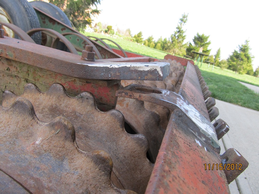

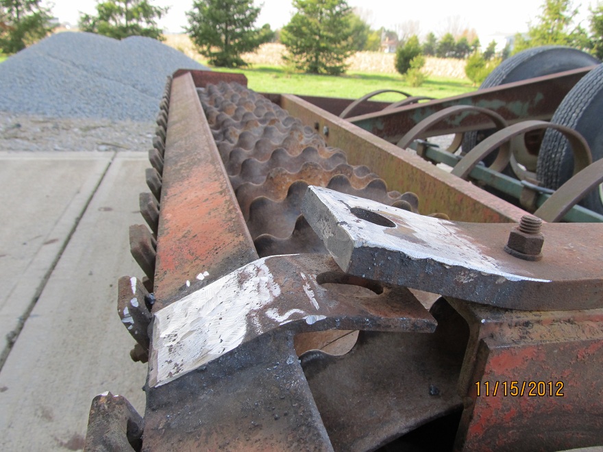

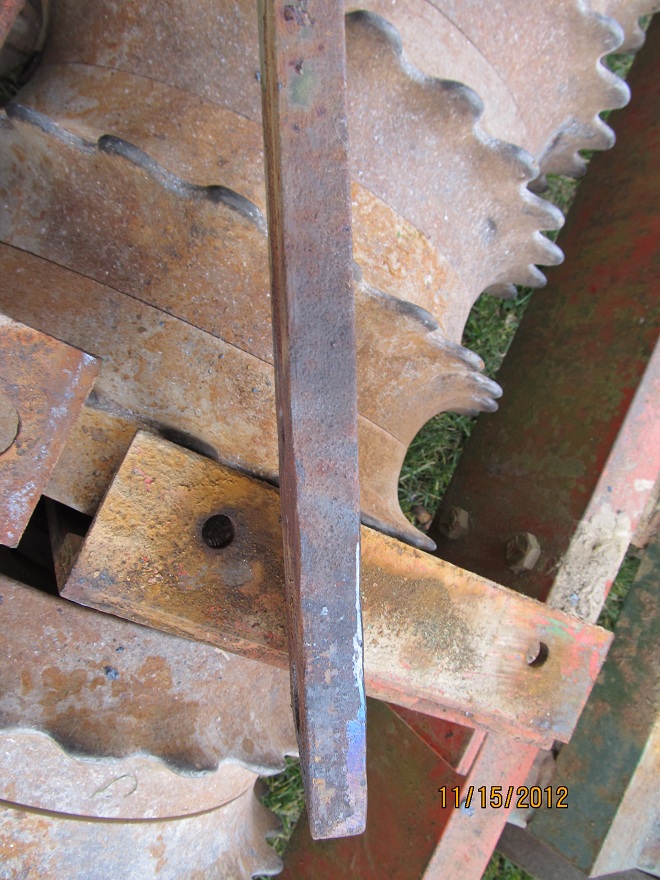

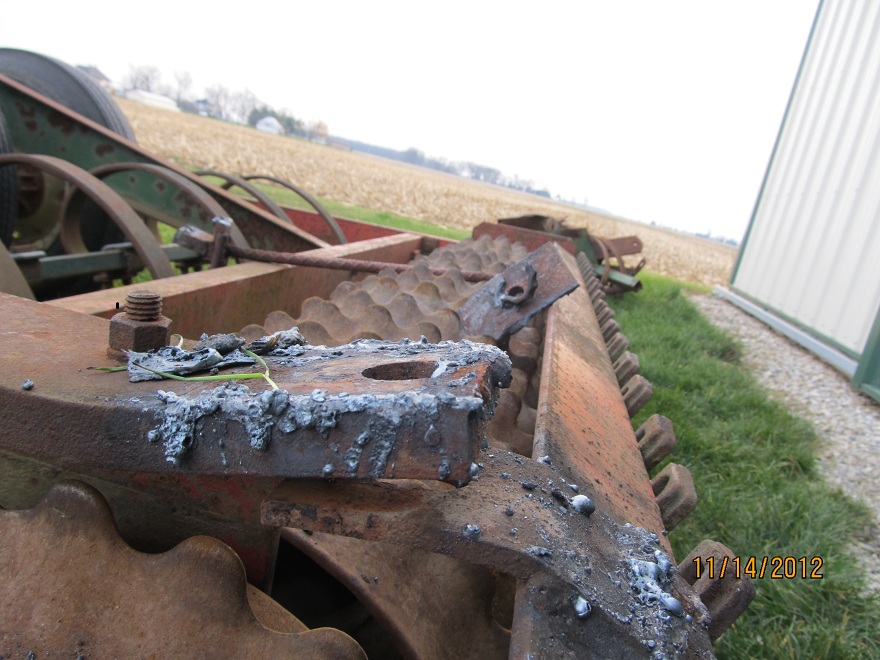

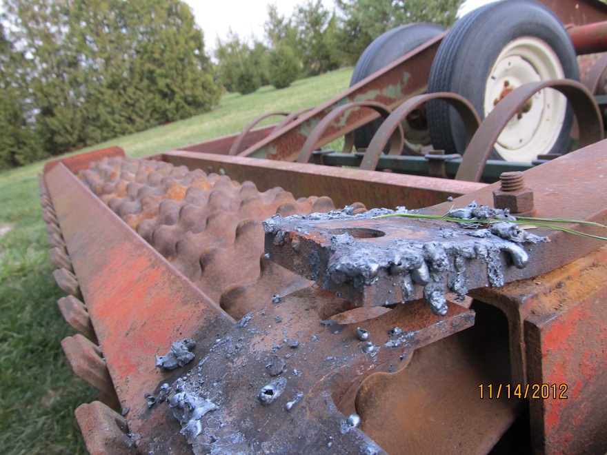

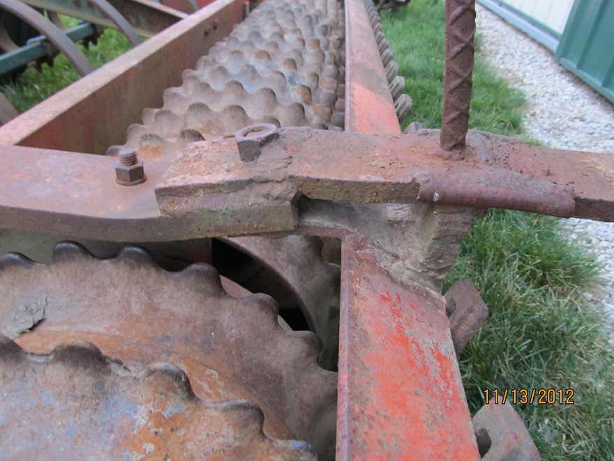

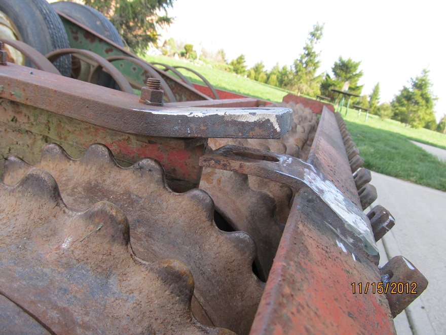

Considering all the beautiful welds posted here by real artists, I thought you might enjoy these photos of a piece of farm equipment I bought. I have already burned the offending pieces off and ground the areas smooth. A little touch up this spring and ready for paint.
The photos show the weld was so cold I was able to torch and grind it off with ease. I'm only an intermediate welder but stuff like this amazes me and it's all over the place, especially on farm stuff.

Well, it looks like a patch it up and get it back in the field job. The welds are not as bad as the fit up, but I understand where your coming from. Good job with torch. Look forward to repaired and ready post.

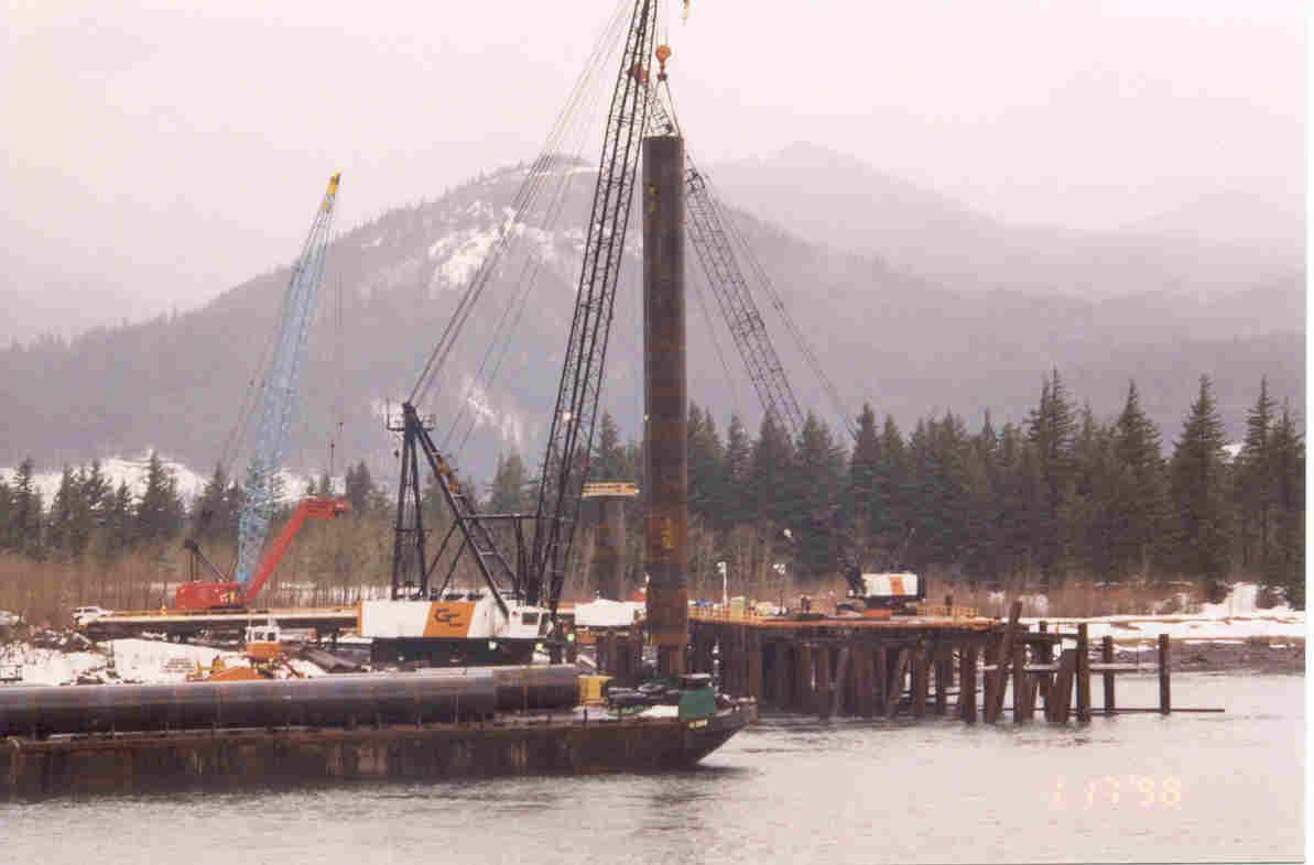

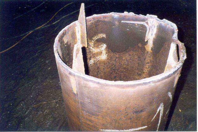

You want to see a bad weld?:laughing: This is probably the worst weld I've ever been around. We were just getting started on building a work trestle that would provide access to a work platform roughly the size of a football field on the Washington side of the Columbia river. I was out in the river about 100-feet from shore over seeing the rig up of the derrick that would drive all the water pile. Very good friend of mine was over seeing the driving of the land based trestle pile. They were driving short pile, if the blow count didn't come up to spec the welding crew would add another section. This buddy of mine called me on the radio, and asked if I would come to the beach and help the weldor set his machine, (wire feeder). Take note, this is a certified weldor! When I walked up first thing that crossed my mind was WTF! Only took a few seconds to dial the kids machine in for him. But his weld looked like sheet! I walked over to my buddy and asked him if that pile was driving real hard, he said no it was going out of sight. I replied he should have that weld cut out, and start over! But we were so far behind schedule at this point. We decided to go ahead and drive it. I went back out to the derrick. When the crew swung the land driver over to drive this badly welded pile I walked over to the side of the derrick to watch. By the 3rd blow of the hammer I knew we were in trouble! Pile broke, pile went one way, hammer went the other way. Amazing no one didn't get hurt. But the hammer fell on the hood of my company pickup, drove the engine right into the mud.:eek:

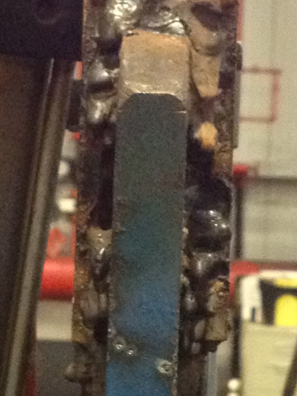

Danggit boy! It's all fun and games till somebody gets hurt :) I have one on my other phone of a stringer on a staircase at a plant. Weight of the hammer or bred of the dog is the only ify part. I'll try to find it and some others.
Mount for pneumatic cylinder, when they hired me they asked "are you sure you can weld" when I showed up I knew why.

So booger welds do really look like boogers.

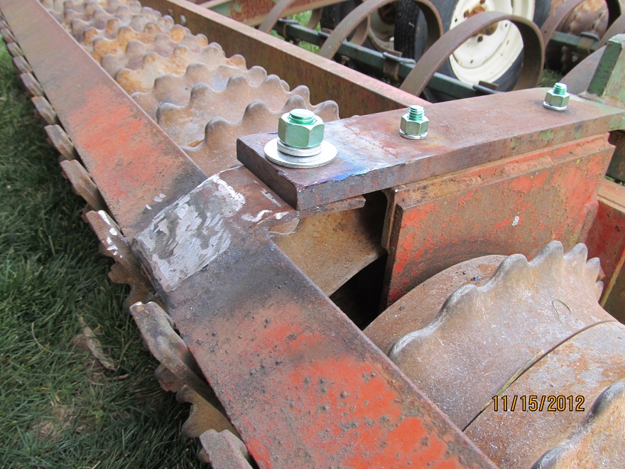

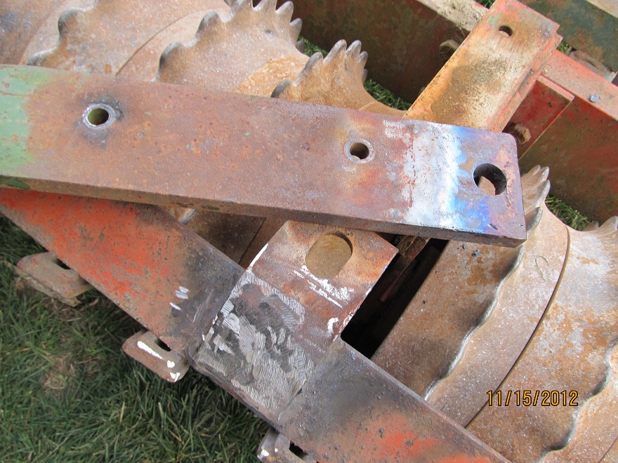

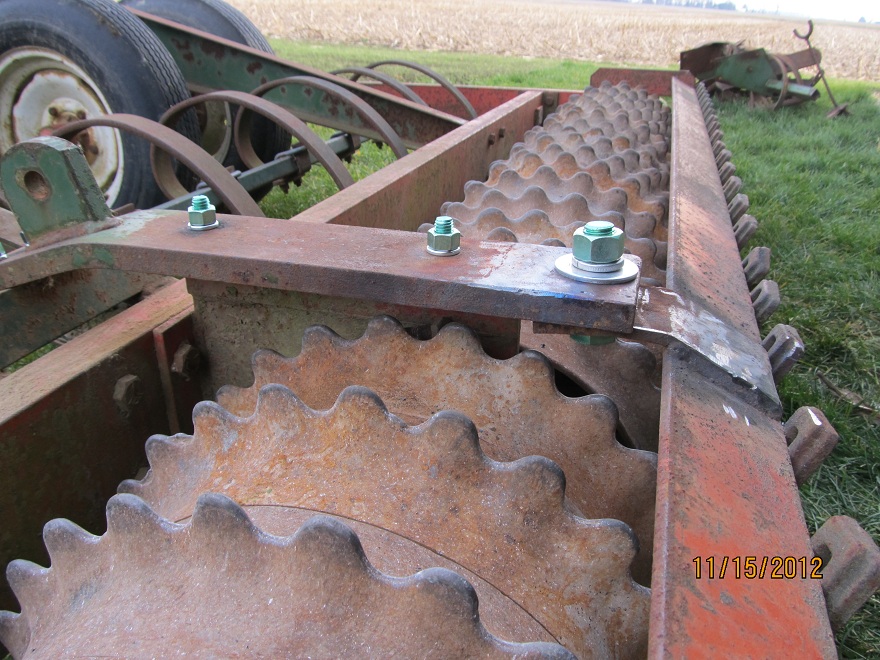

Here it is ground smooth and metal pounded flat again. Some of the pieces welded to the frame broke loose with a whack of a 2 lb hammer.
Very nice, very nice. Well done sixdogs.
