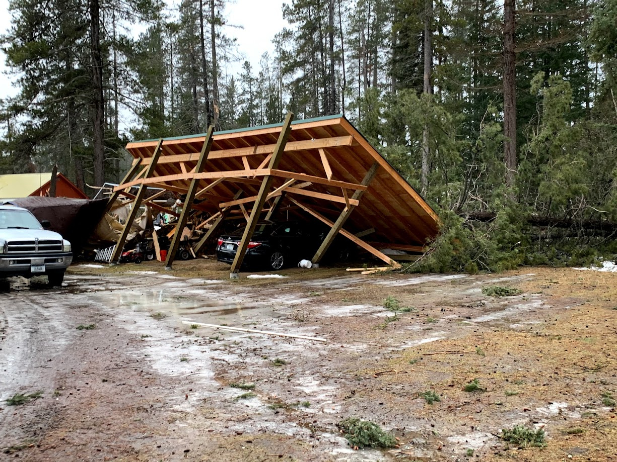

January 13th, 2021 My house is the red tip on the left, this was my wife's uncle's pole barn, erected 3 months prior.

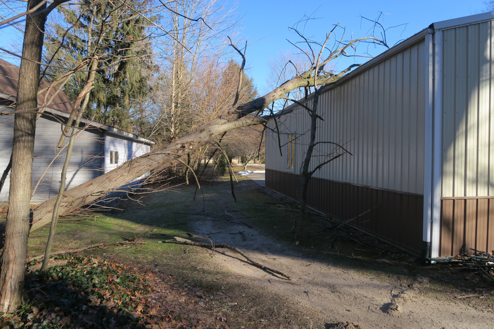

Yesterday I found a tree on my pole barn. It was actually on my neighbors property. I noticed it was dead last year and thought about suggesting we take it down. It would have been tight to get it between our barns, but I wish we had tried now. I have to call the insurance company but I think I will probably take it off myself since it's hard to get tree services on short notice. It doesn't look likely to roll or twist on me. Since I have a ceiling and insulation, I can't tell if there is structural damage but it looks like one or two purlins might be broken.

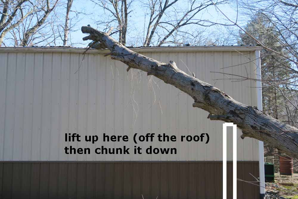

Build a 4x4 a-frame and put under it about 4 or 5 feet from the side. You should then be able to cut limbs off the building side. Then hook a chain to it up to it close to the a-frame and pull it over, cut up, split and enjoy a fire
Monday-morning quarterbackin'......
