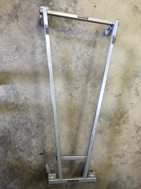

Here is the BX BH dolly. Note 4 wheels, a cross support for the bucket, and locating stops for proper positioning. It rolls under the mounted BH until it contacts the tractor. Then you use the hydraulics and pull the connection pins. Fairly easy to do.
Seems to do the job well. Any pics of the hoe on the dolly? How much does your hoe weigh?

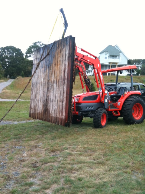

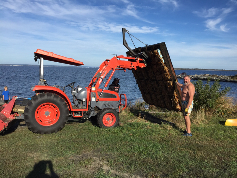

I'll find some better photos of my tree boom when I get home. I have a photo of my tree boom lifting a swim float (and my neighbor) on my iPhone so will post that.
No problem with garage doors as the tree boom can be set either above or below the level of the bucket.
Photo shows the tree boom lifting to max height but I could just as easily "dump" the tree boom down to pick up something at ground level.

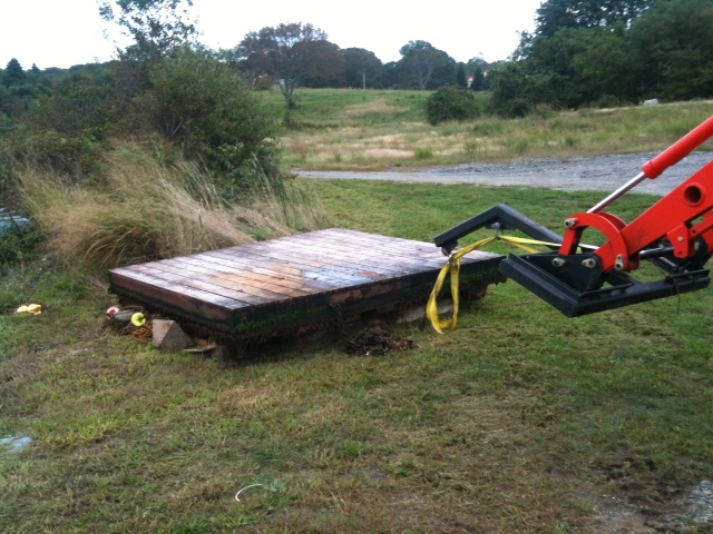

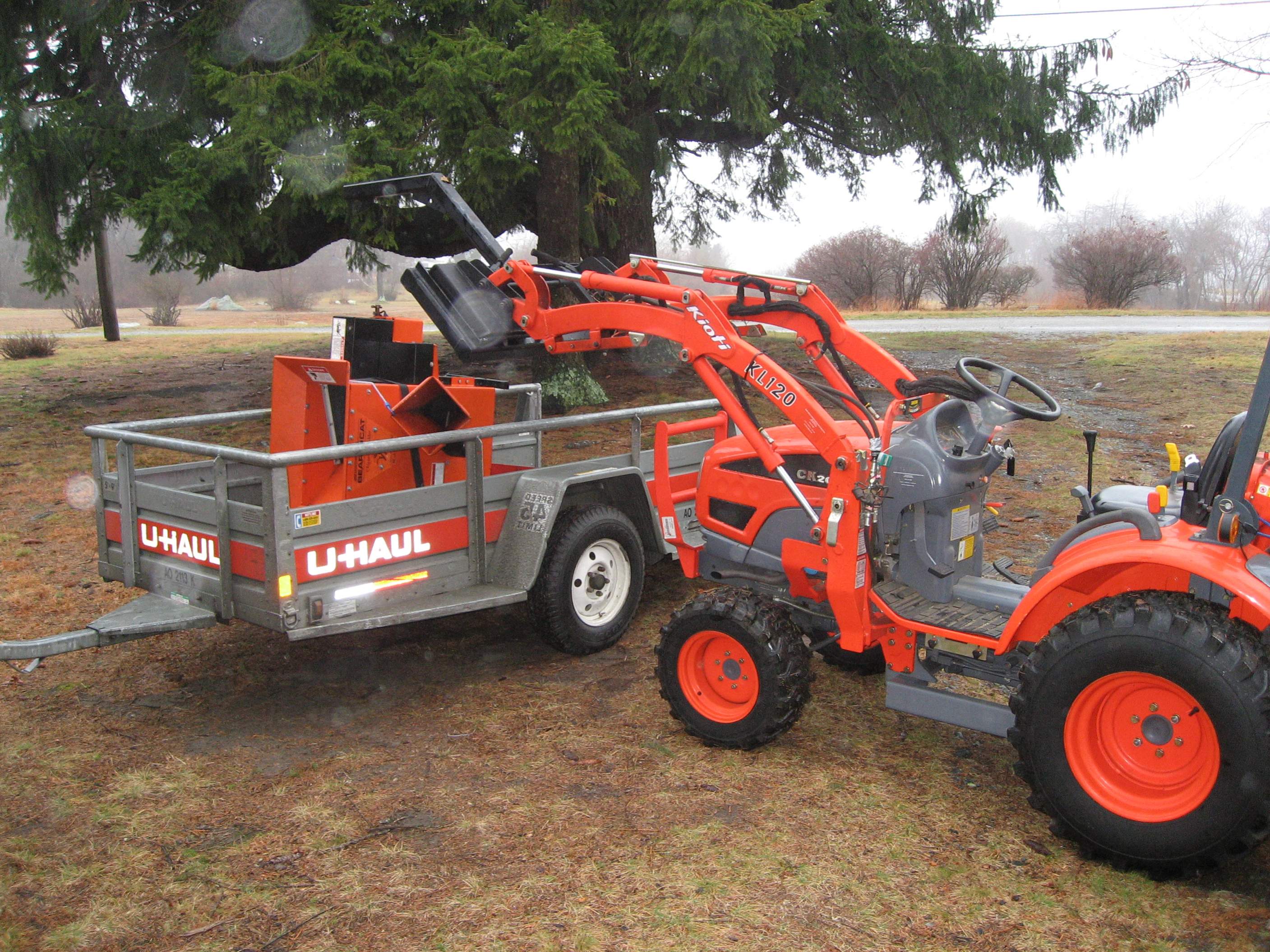

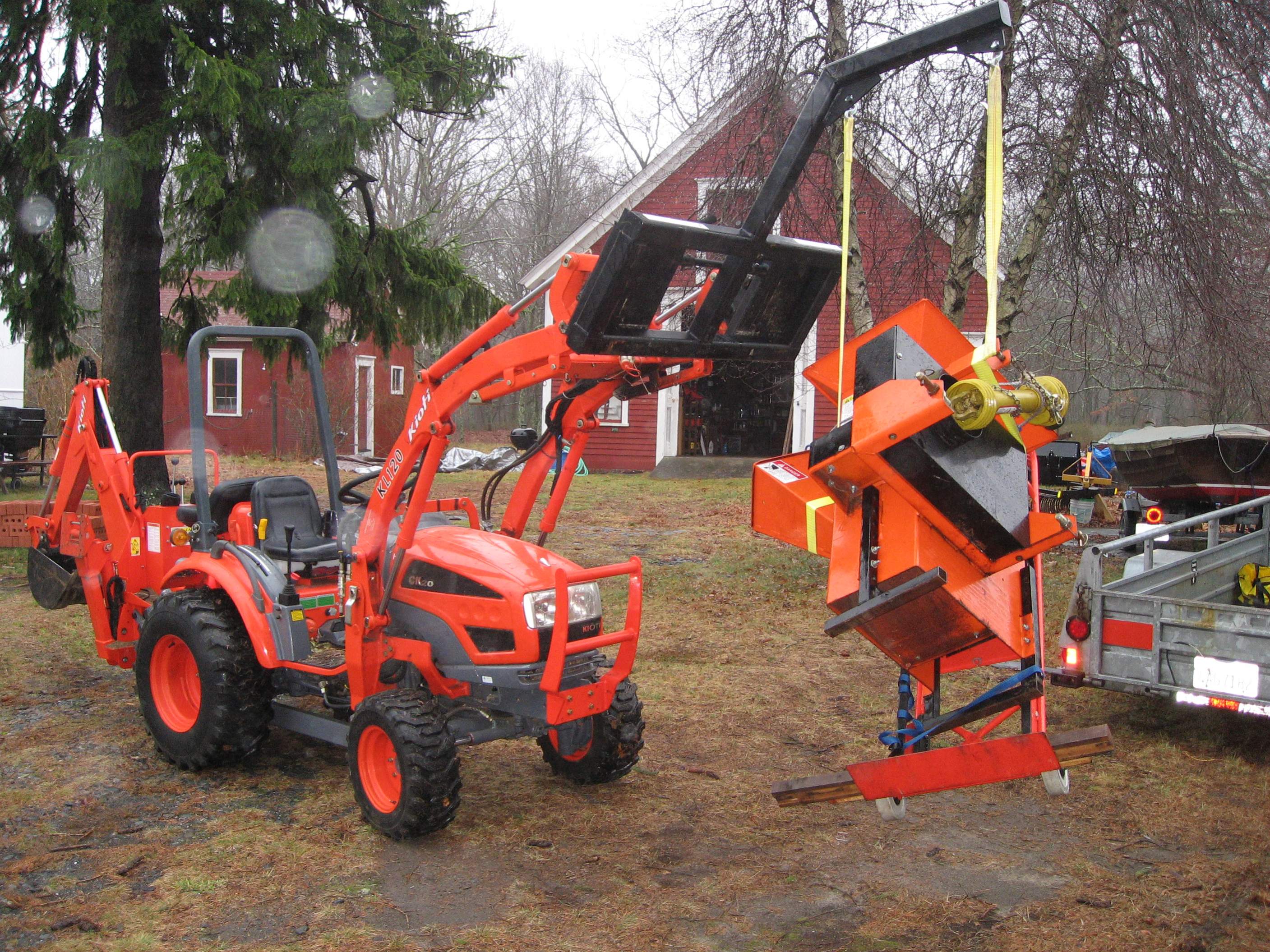

Here are some better photos of the tree boom. It is a SSQA implement with no moving parts other than a couple of shackles. There are two attachment points on the boom, at the middle and at the end. It essentially converts the FEL into a mini crane. I've used it to lift a number of pretty heavy items and I find it much better and safer than lifting top heavy items with forks. I use both chain and sometimes straps to attach to the load. We pull the swimming raft (1500lbs) up over a seawall by dropping the tree boom over the edge then curling and lifting. I use it to move implements on and off a trailer. One thing I have never used it for is moving a tree root ball which is where it got it's name.

That thing looks useful but dangerous.
   / Bad day: flipped backhoe, then almost flipped tractor...
#36
Looks good! Who makes it? Thanks for the pics too. I can't make out the brand name on the pic with the boom on the ground?
   / Bad day: flipped backhoe, then almost flipped tractor... #37
It's a fairly generic implement. Mine is from Millonzi but they have been out of business for years. I just did a quick google search and found one at palletforks.com for $295.
It is also an ideal DYI project as there are no moving parts or critical tolerances.
