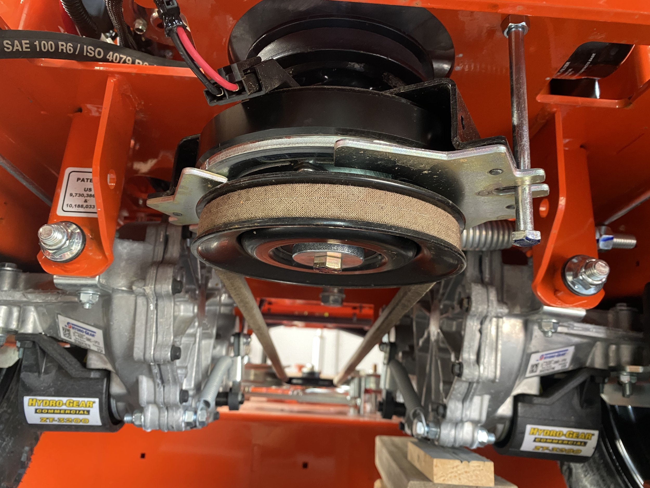

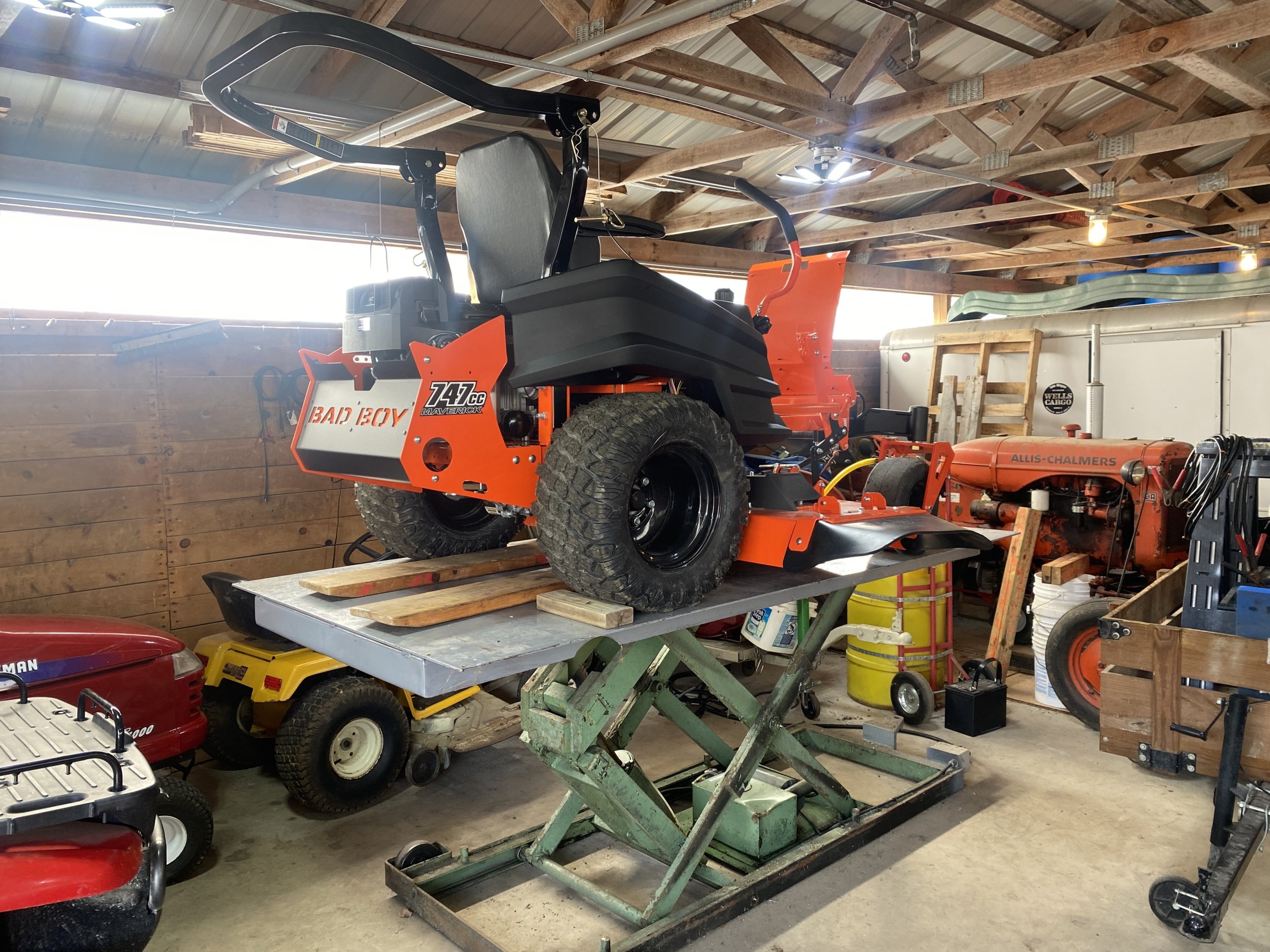

I don’t find removing the clutch & pulley much of an issue but I don’t lay on the floor anymore, I have a lift
Drain the oil, remove engine & lay on work bench to replace seal
I use a small manual chain hoist to lift engine from mower or get someone to help lift off mower

I believe you have to remove the pto clutch before the engine can be removed.
/ Bad boy crankseal #8
Yes the clutch and pulley needs to come off first

Some come off of their own free will but if you do enough you’ll find older ones that can quite stubborn.
/ Bad boy crankseal #10
Yes this is true, I always use never seize on reassembling, if not for me maybe someone else in the future
