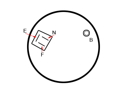

how would you hook up the alternator without the wiring harness? we have an alternator which looks like this
which connectors do we hook up to battery positive? negative?

just make up some jumper wires with proper terminals and plug them in singally not using the plug/harness. you can look at the harness at the vreg and the plug to figure out what goes where.

The B terminal will go to battery positive but where do the N, E and F terminals go? the wiring diagram isn't that clear to what goes to Ground. at the moment the positive battery terminal is hooked up through the starter to the B terminal and then the N,E and F terminals all go to the regulator and then from there i assume they some how find their way back to the battery but i'm not sure. any help would be appreciated. i can post the wiring diagram if someone could help.

not sure about the 'n' plug but the 'e' plug is the ground to regulator 'e' basically means earth ground external ground as well as others the 'f' is the field this is going to pass power from regulator to alternator and reverse again as soundguy stated just make jumper wires from one to the other and test this away also with volt meter with tractor running by touching the 'f' and 'e' should test unit as to full field and go into overcharge post back what happens
