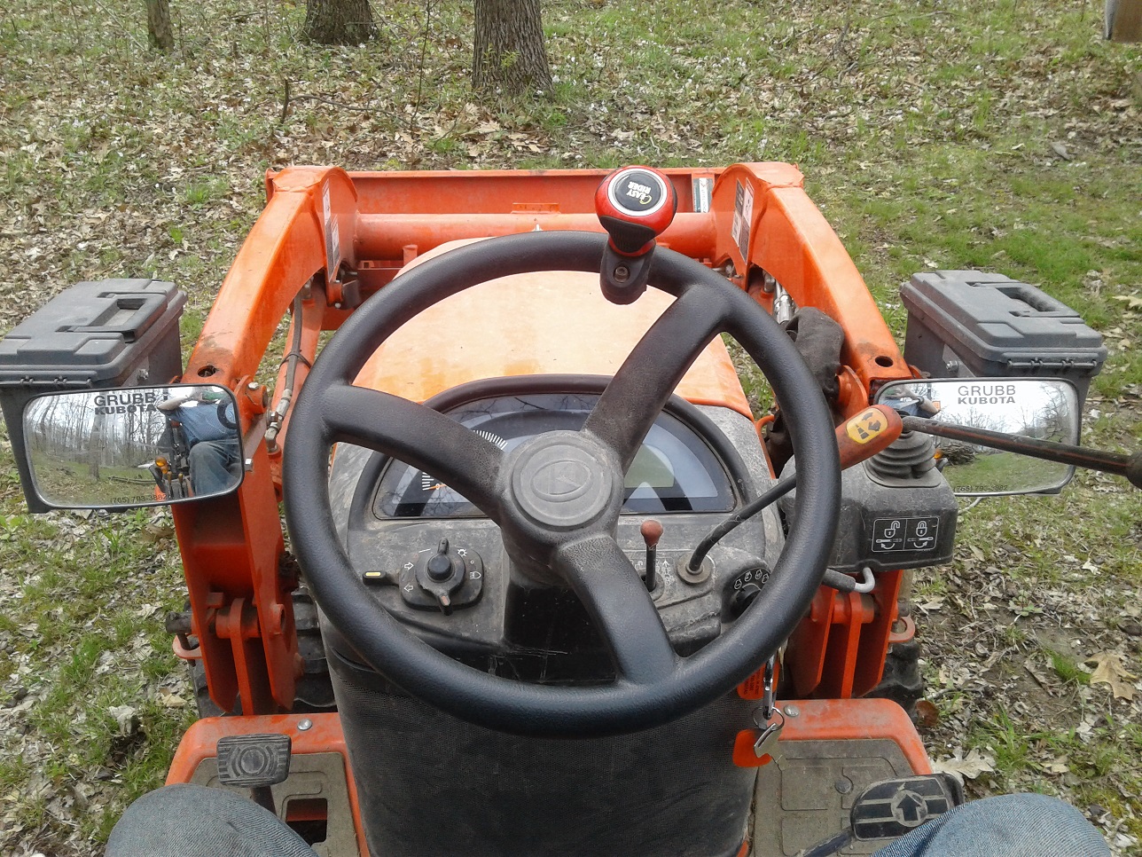

I have tried to mount a mirror various places with no satisfactory results. I tried on the roll bar and maybe mounting on the hood or either side of the hood. If anyone has attached a backup mirror I'd love to hear where you installed it and how. I am 71 and have a difficult time turning my head around when backing up. My tractor has front loader and backhoe attached. Thanks for any advice. Pochie
   / Backup mirror for 2004 BX23 #2

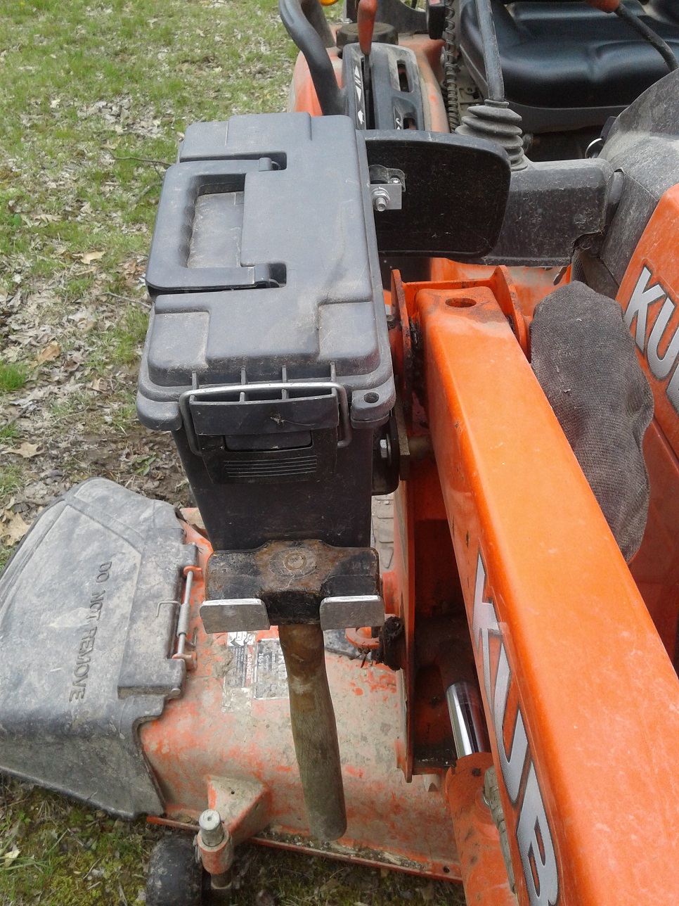

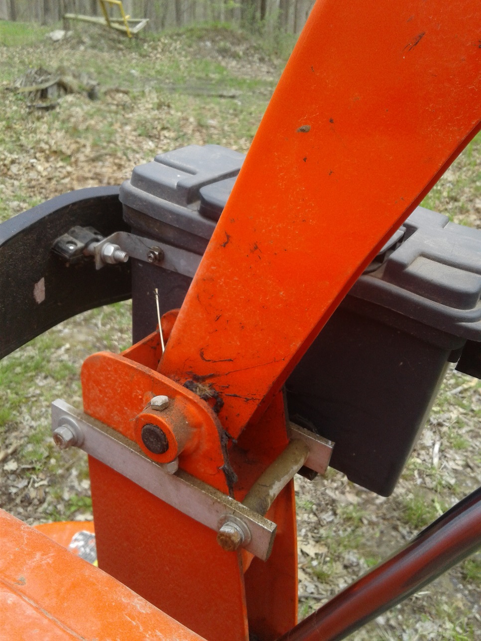

I used bar aluminum, bolts with tubing (to prevent rubbing off paint). 1st priority was added storage for tools, ratchet straps, ect. Wide angle mirrors added behind ammo boxes for mirror protection. Drop FEL lose mirrors.
Others have found and installed golf cart mirrors.

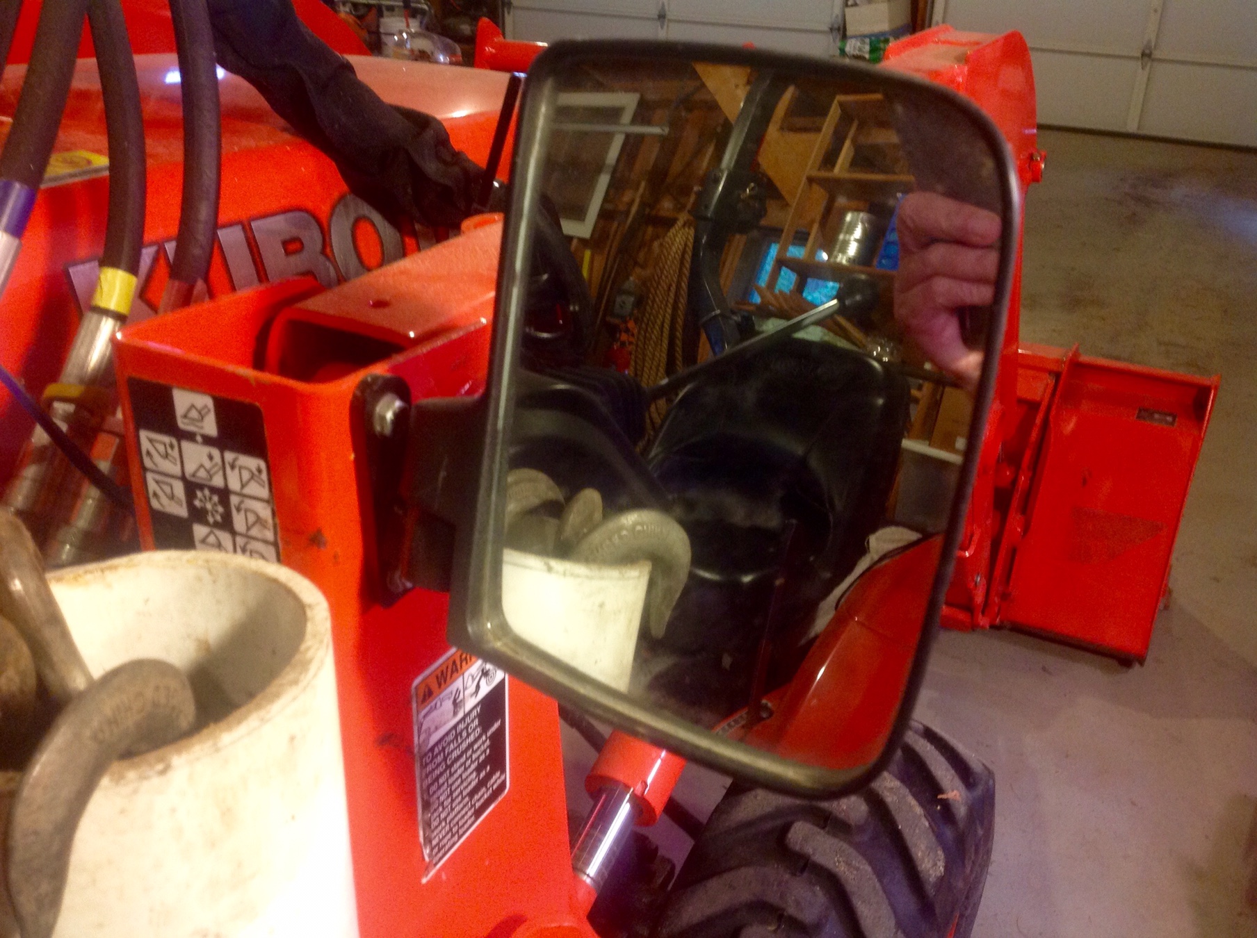

   / Backup mirror for 2004 BX23 #5
Yep, on the FEL loader post. I used a 'van' type mirror that I found in the local auto-parts shop. The mounting bracket was fabricated by a local metal fabrication shop and I cut up a floorboard mat to use between the bracket and the arm to act as anti-vibration. Works great!
