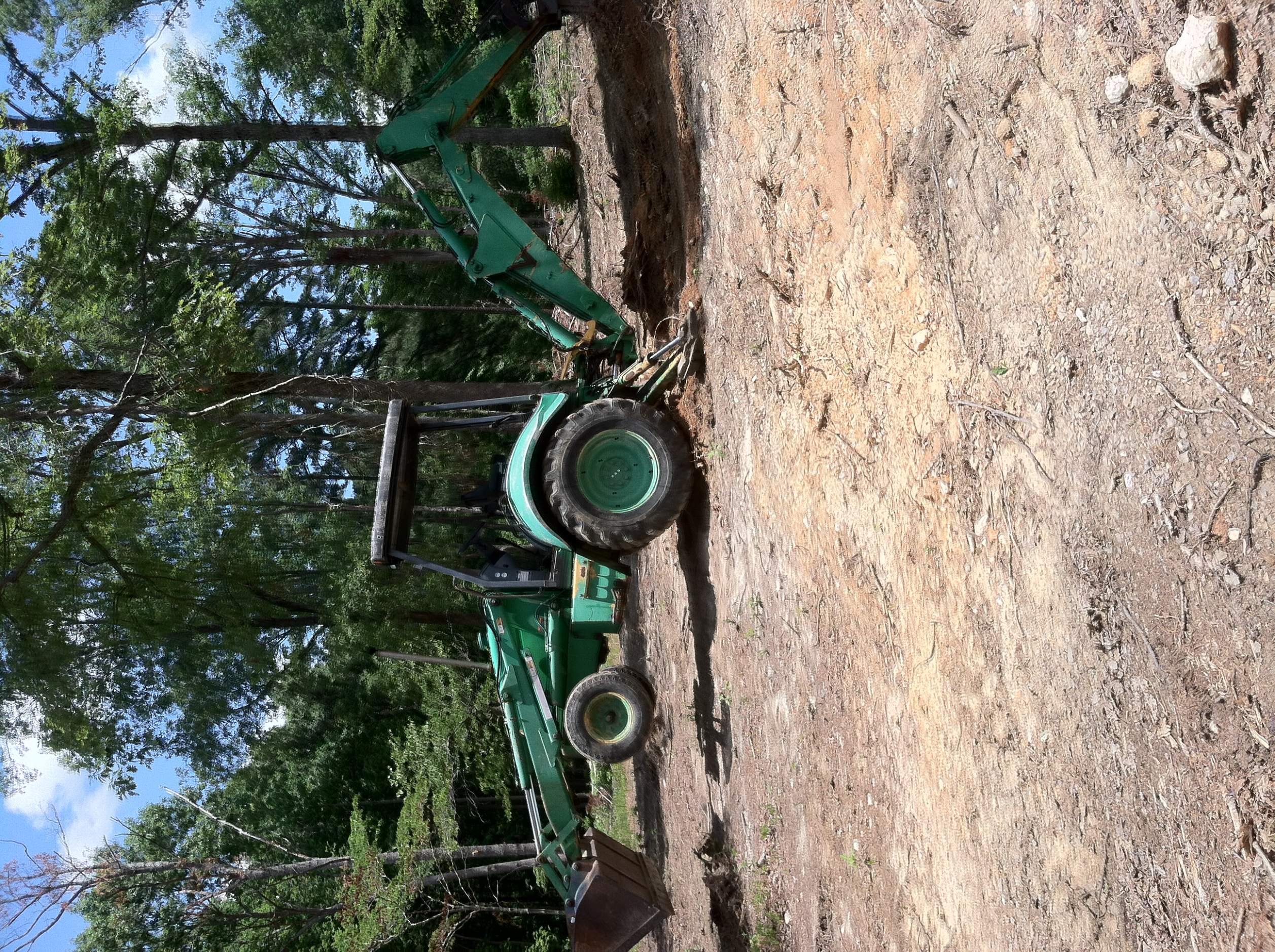

IMG_1820.jpg Hope this picture comes out just as four foot around and 6 -7 foot pine tree tap root finally broke loose the front end came off the ground. It seems to pull out hard woods a lot easier than the huge pine trees them tap roots are a killer.

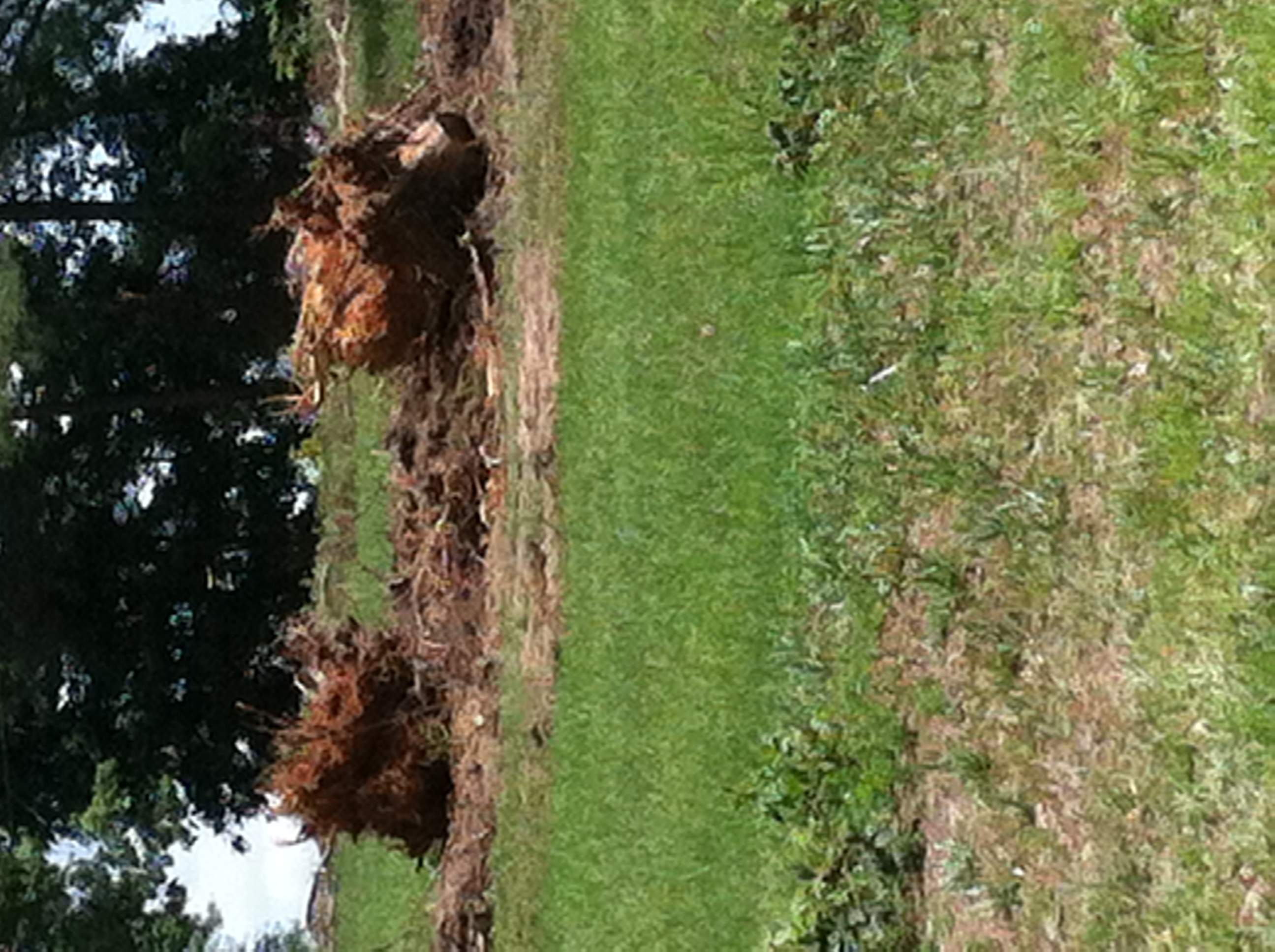

IMG_1822.jpgIMG_1822.jpg It is nice how it just cuts a line across the root ball with out removing much dirt at all. I have pulled out about 35 stumps so far since I built this bigger blade type ripper at 42 inches.

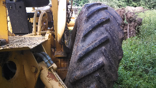

Dang the bad luck! I was pushing up a brush pile with the backhoe today and I heard a loud pop! Then the backhoe was leaning on its side! Thought I broke an axle! But I broke the inside of the rim!
/ BACKHOES LETS SEE THEM #428
You never like it when these things happen and you wished that they did not. But on the other hand better a broken rim than a broken axle.

If you plan on welding the rim back together be sure to take the tire off first. Remember that a weld bead shrinks as it cools when you try to true the rim. Less than an 1/8 inch run out can be done without much trouble.
