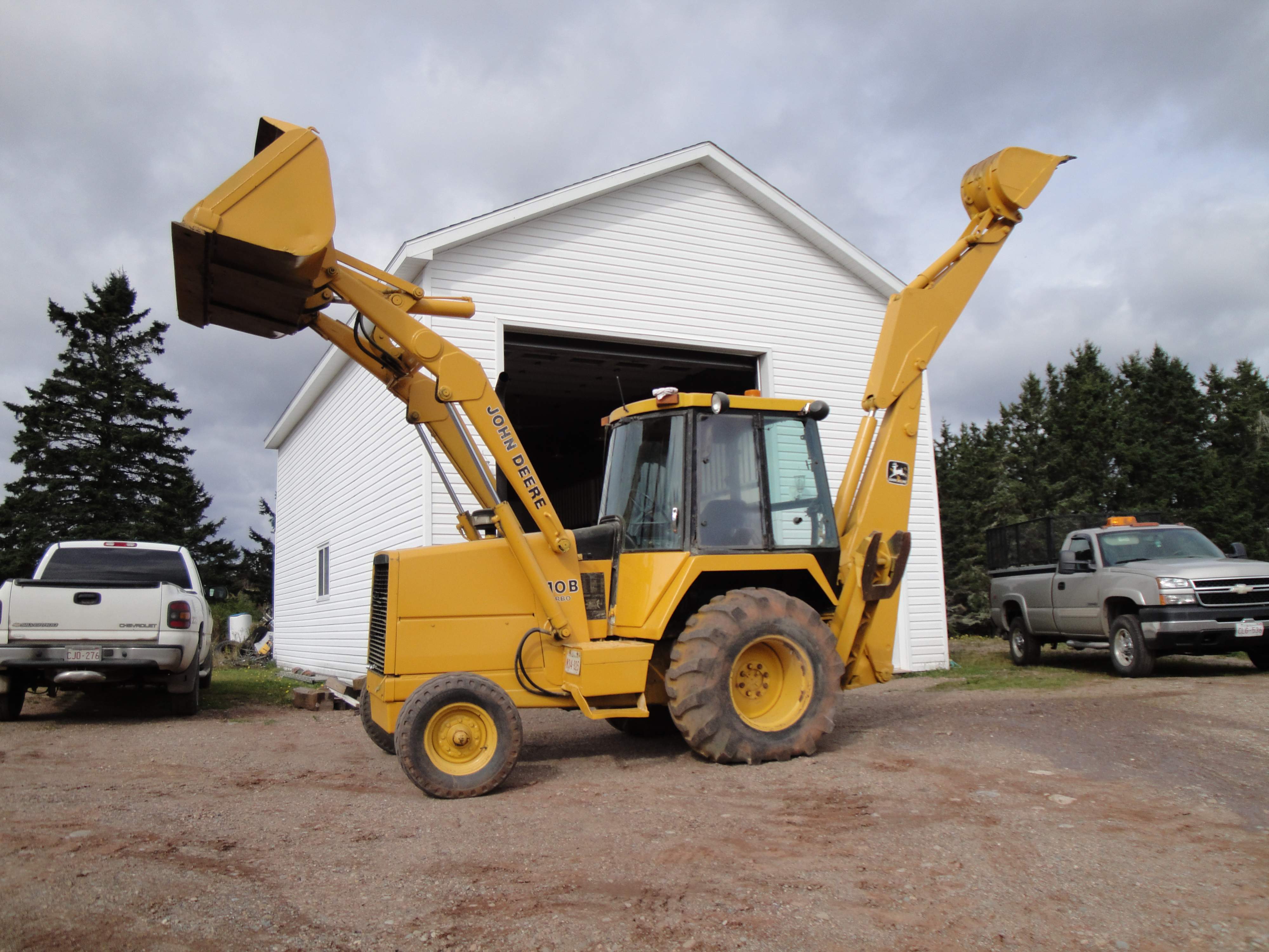

Here is a picture on my JD 510B. Old, but works great. I had to change some bushings, the last owner didn't know what a grease gun was. Handy machine to have around.
