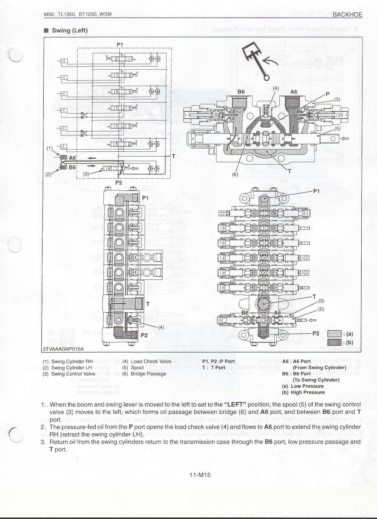

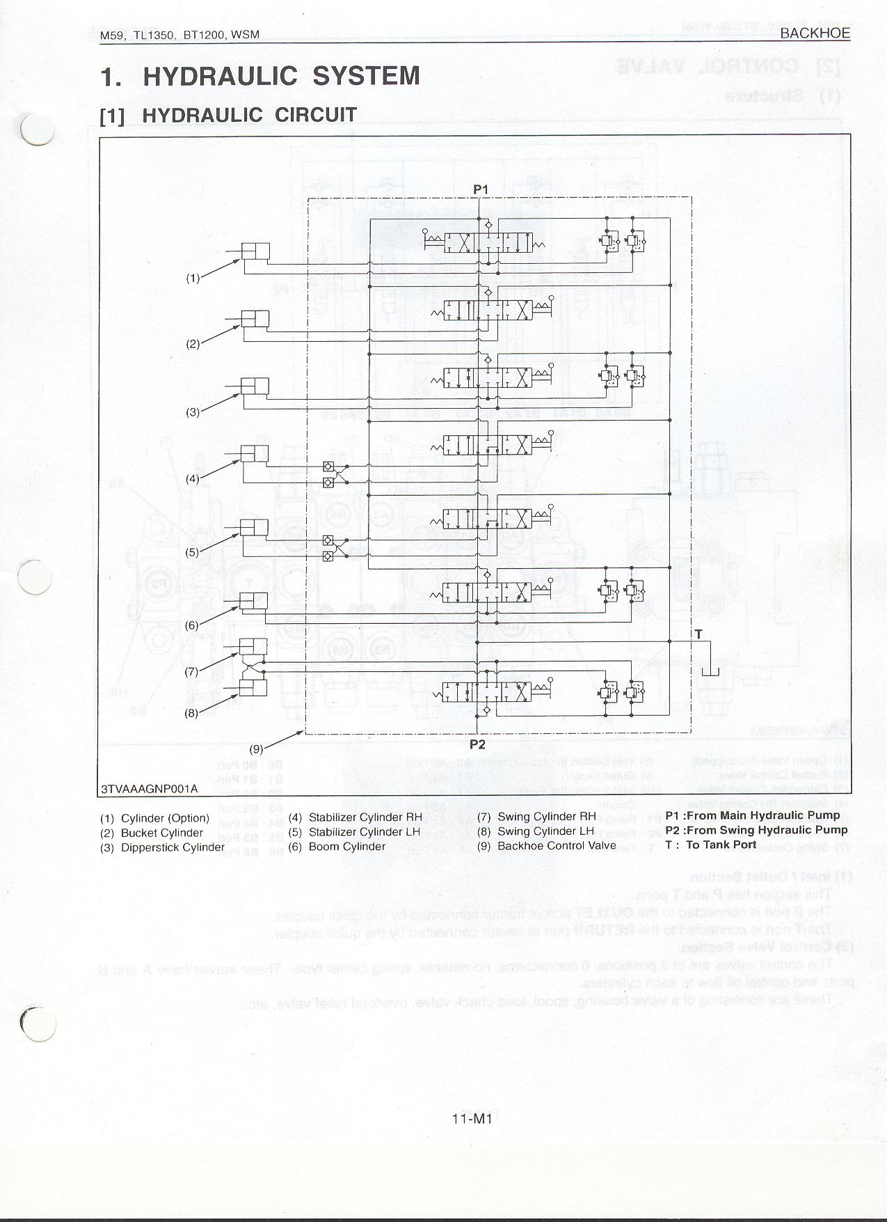

I really don't know what happened, but I am guessing a cup seal caught the flow and thereby got reinforced.
But I really don't even know if it has cup seals in the cylinders. I don't know how it is piped. I don't know if it is in parallel (one piston side in parallel with the rod of the other cylinder, etc.) I used to tell folks that telling me what they don't know is not helping...so I will heed my own advice and stop right there.
I was wondering if I was talking out of my hat with my analysis, but I have found a hydraulic diagram that supports my theory buy searching "backhoe hydraulic diagram" on Google.
HYDRAULIC SYSTEM DIAGRAM (SERIAL NUMBERS 319995 THRU 342573 ONLY)
Compare that diagram to my comments earlier, and do tell us if it matches yours (vis a vis the swing cylinders only), if you don't mind.
