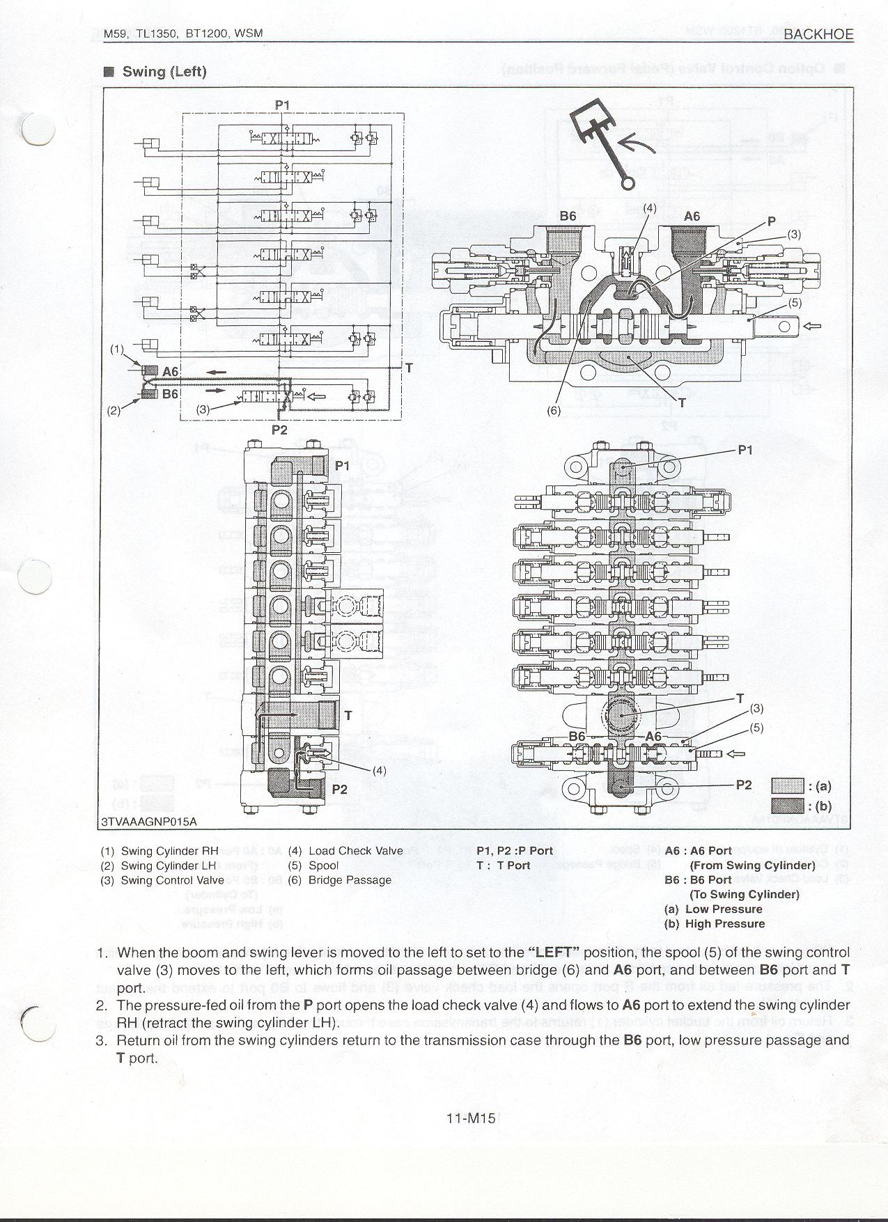

The M59 does have a separate swing pump. The main hydraulic pump powers the boom/dipper/bucket (and loader etc.). The main hydraulic pump has a separate section for the power steering, hence the tractor essentially has three hydraulic pumps.
It could be that there was foreign matter in the valve, preventing it from fully opening in one direction. Moving the lever and swinging the boom back and forth may have eventually cleared it out, allowing normal flow.

IF you look at the diagram again, a man could simply switch the hoses at the valve, and if the thing then swings the OTHER direction but not the previous (that used to work fine) then it is not the cylinders, but in the valving.
Ahhh!!..That's a very good idea. I've done the swapping things across before, but missed that it would work on this system. It is a good way to diagnose.

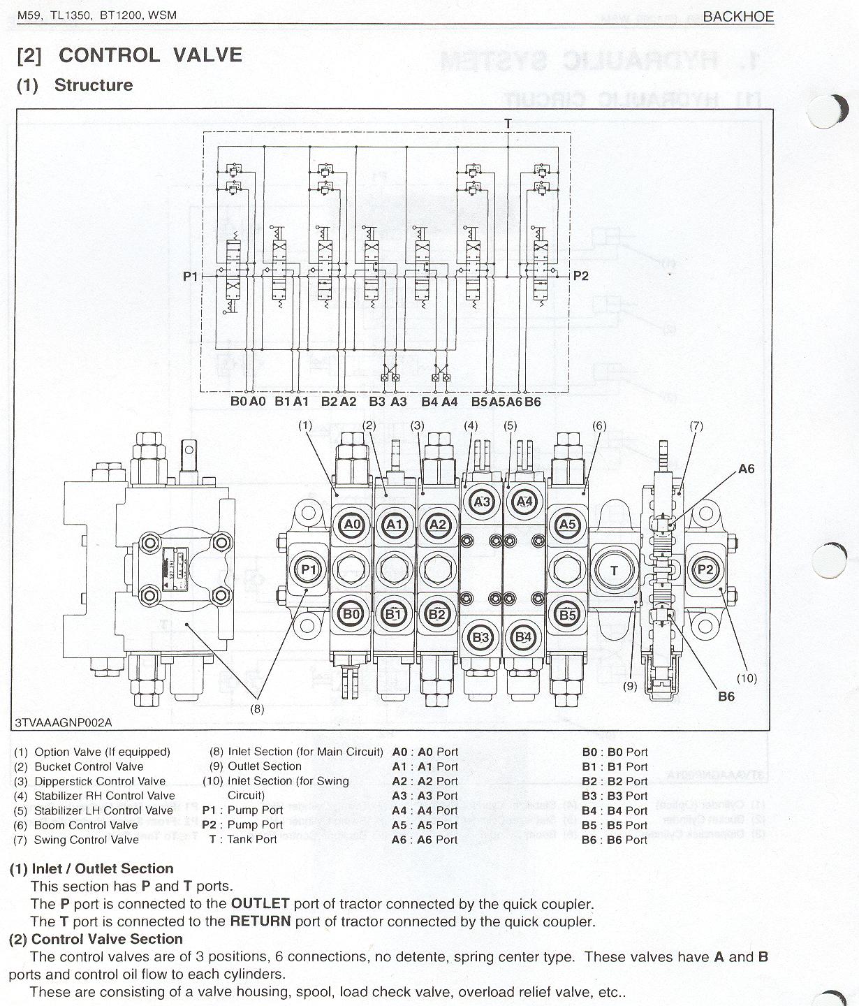

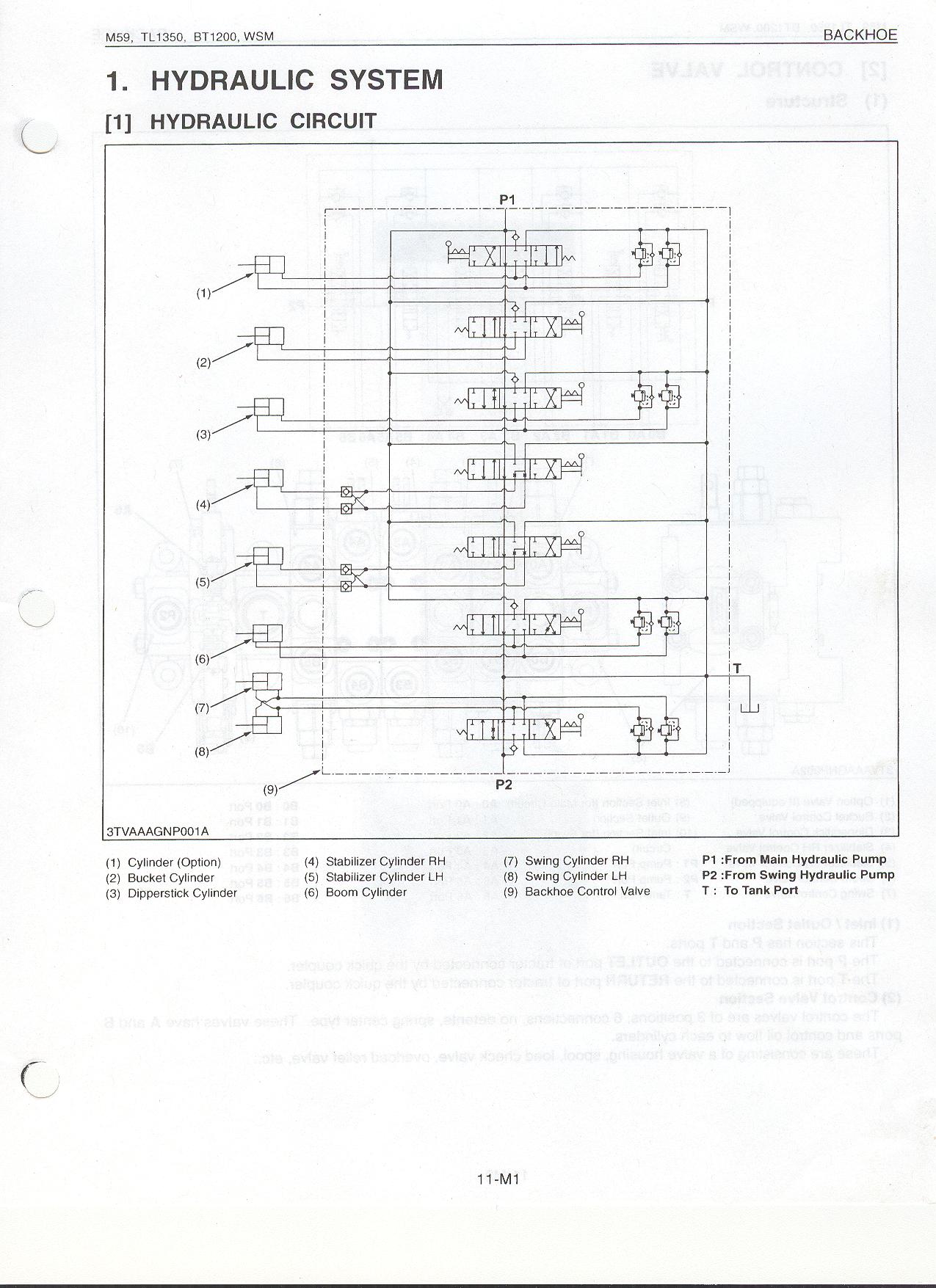

Yes, the swing has it's own completely separate pump from the boom and bucket functions. There's the that complexity again. You can P1 and P2 in some of the picture below from the shop manual.
I uploaded some nice pictures that Oldnslo asked about. This is an interesting hydraulics discussion. Take a look at the modern M59 workshop manual versus some of the old hand-drawn workshop drawings (Yanmar)!!

I will look at it more tonight, but so far, it is interesting that both pumps contribute to most functions(wrong), but only the one pump does the boom swing(right). Whether a piston leak could consume all flow depends on the actual flow of that pump...but I would not be surprised either way since booms need to swing fairly slowly, else a person could extend a full scoop way out and really make a heck of a crowbar out of a full extended hoe arm...a man might be able to twist off a stabilizer or do all sorts of crazy stuff if that boom start whipping side to side (edit: and the reliefs would protect the system, but not stop the momentum.)
Some of the additional complexity is a relief valve for each circuit. The reliefs could participate in a problem, and could participate in the problem you were having. Switching the lines can still be diagnostic, but I will have to consider it a bit further...since there are free flow back checks associated with the reliefs, and I haven't figured out what they enable. I have seen them before, but I always have to apply their appearance to the actual function of the apparatus to see what they help. They could allow free wheeling, etc.

Thanks for posting the schematics. Would suspect one of the reliefs got stuck open. These relief valves are there to protect from shock or surges caused by the sudden stopping of a swing function. The inertia of the boom and bucket can cause intense pressure spikes. The check valves in the RV's are to allow the cylinders to draw in oil (prevent cavitation) while moving under vacuum in the above scenario.
The reason for a separate pump for swing is for consistent motion regardless of the other functions on BH. This is a safety concern when operating around people or buildings.
