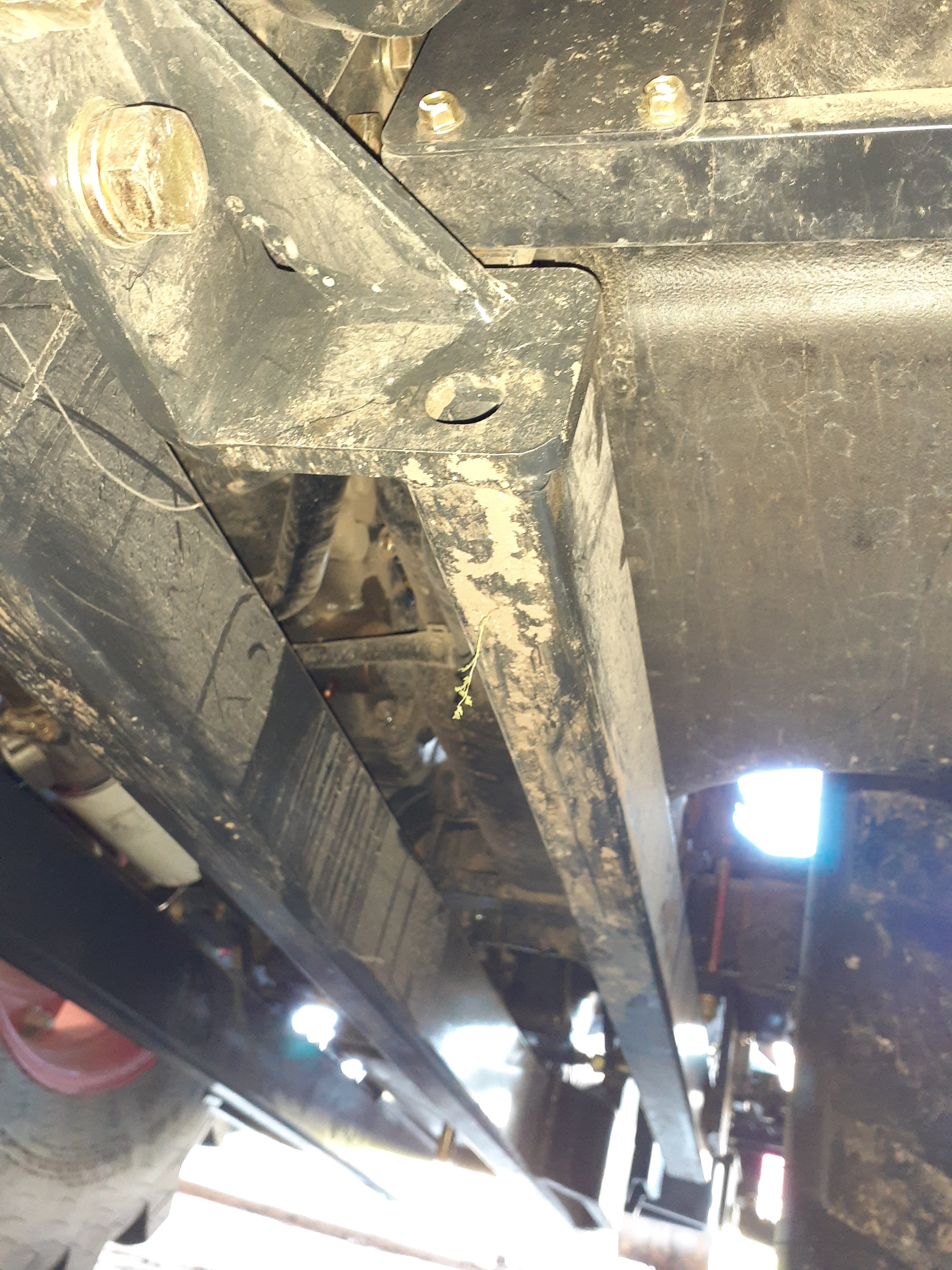

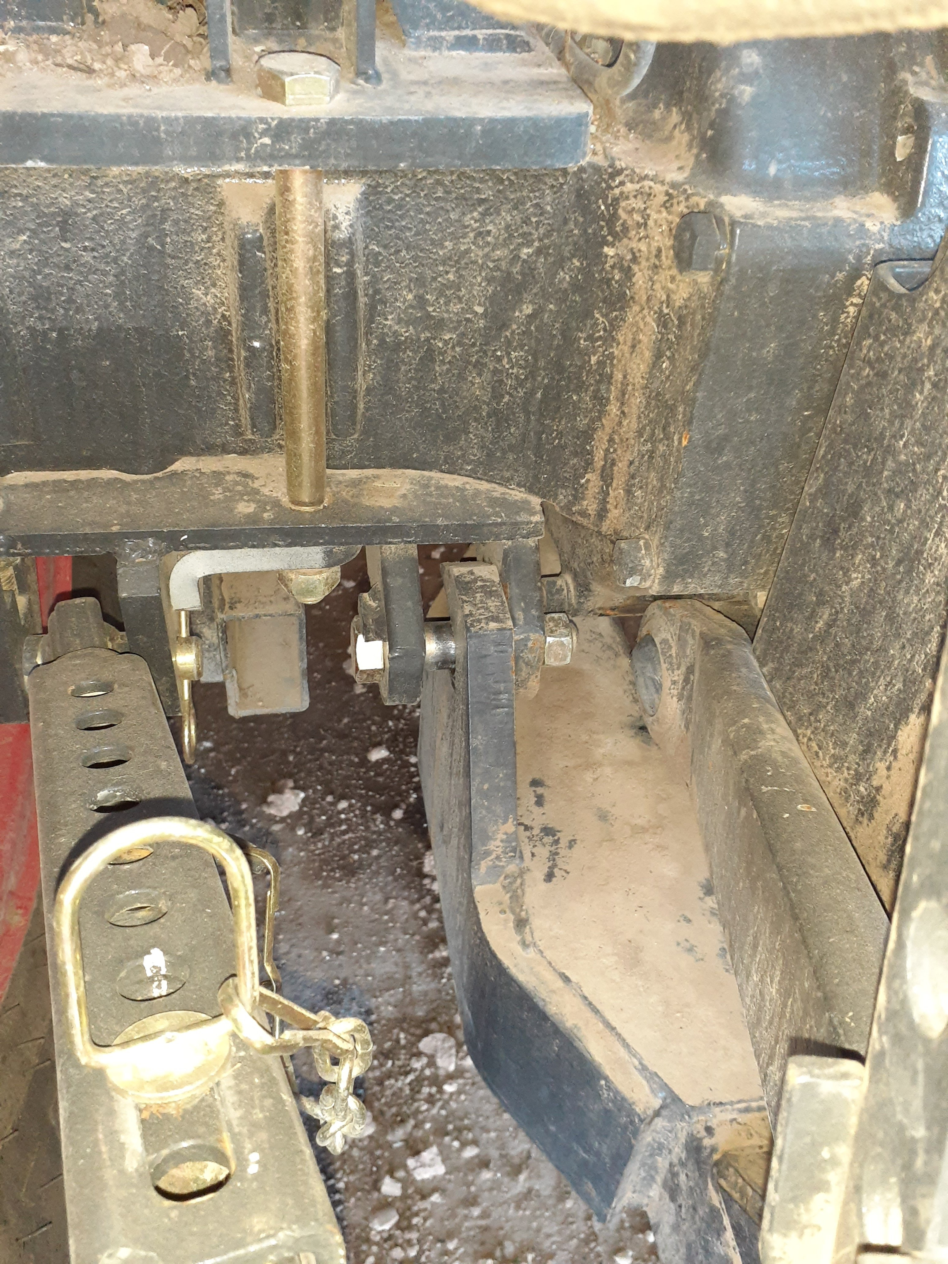

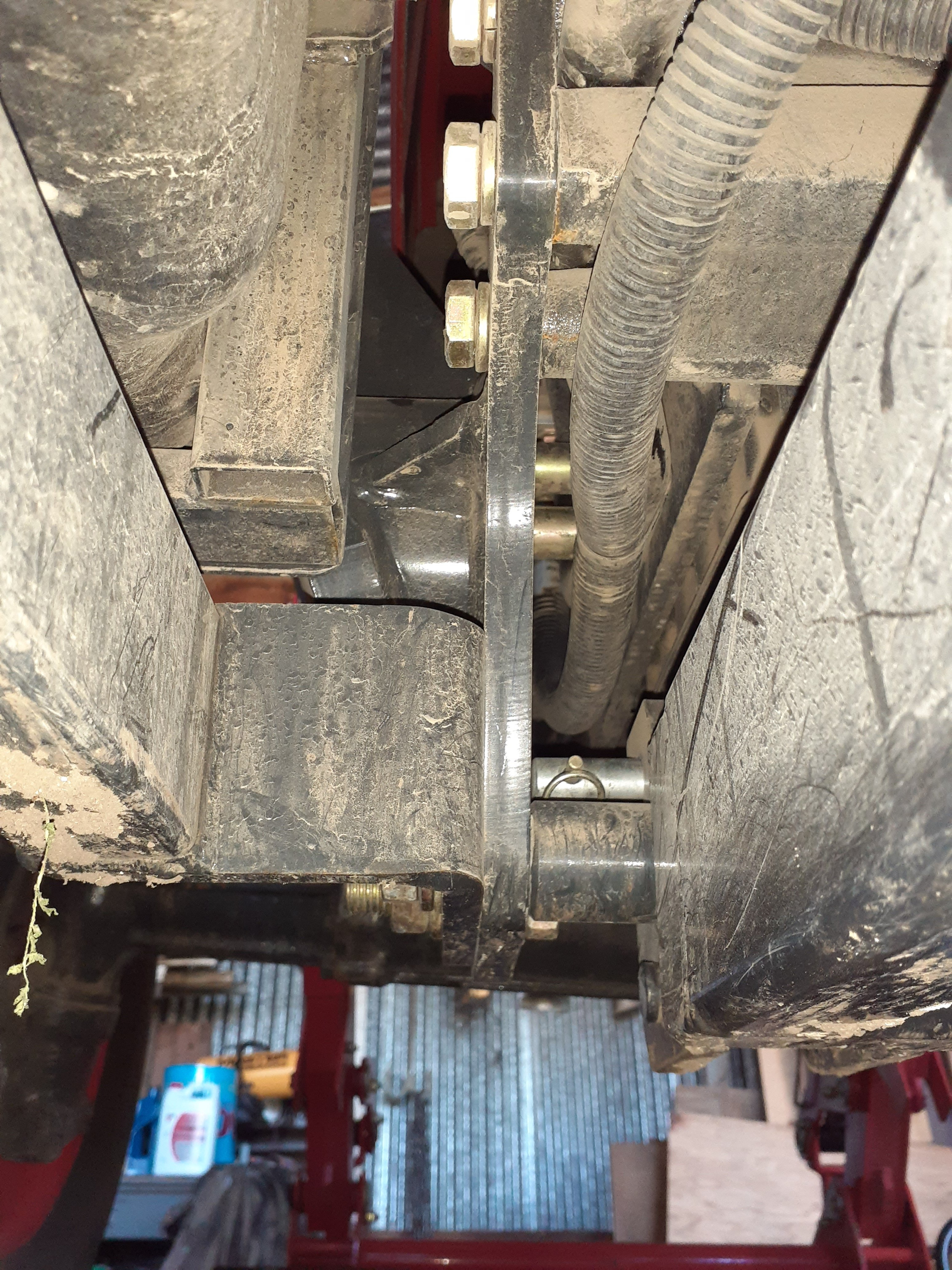

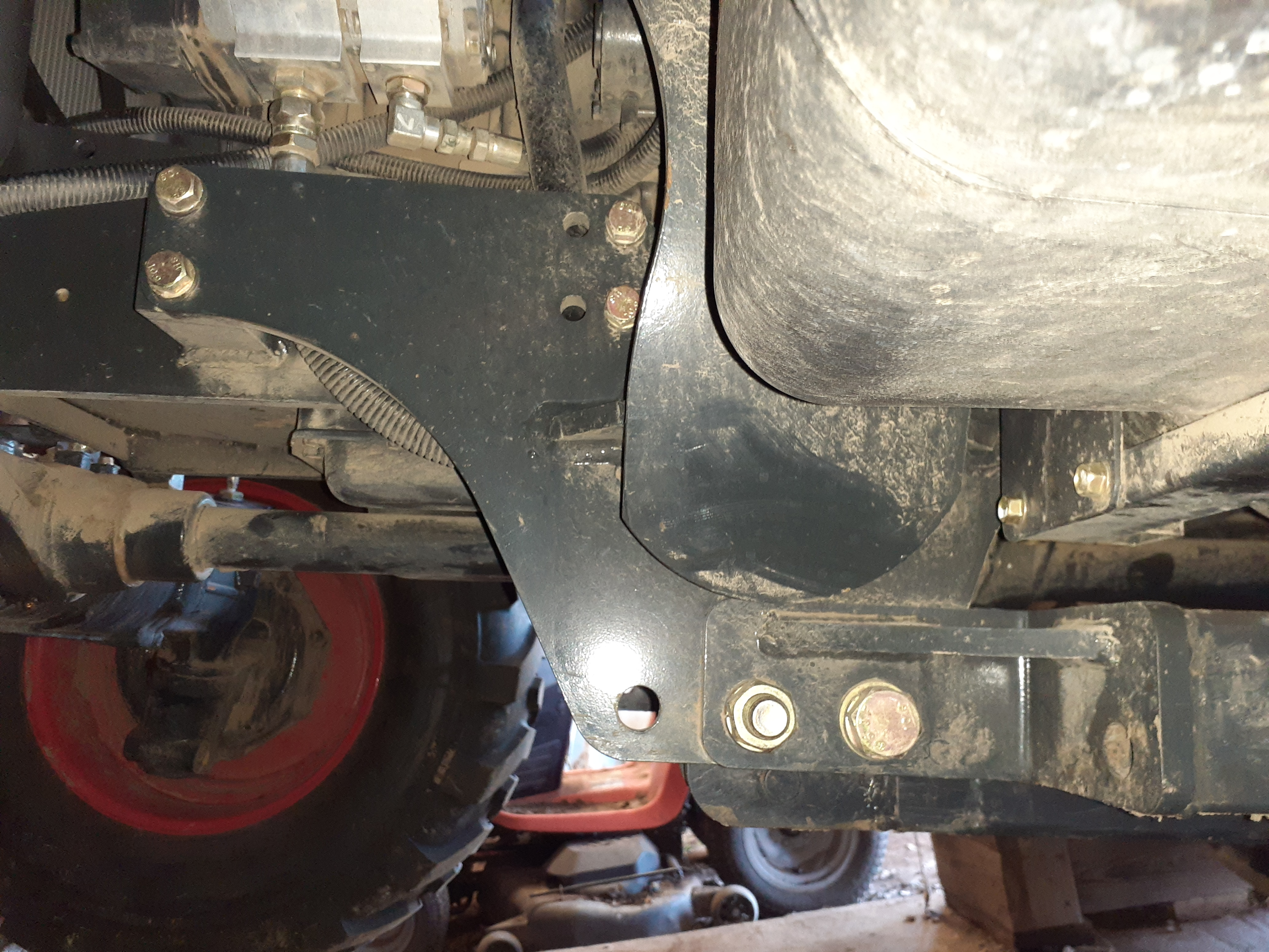

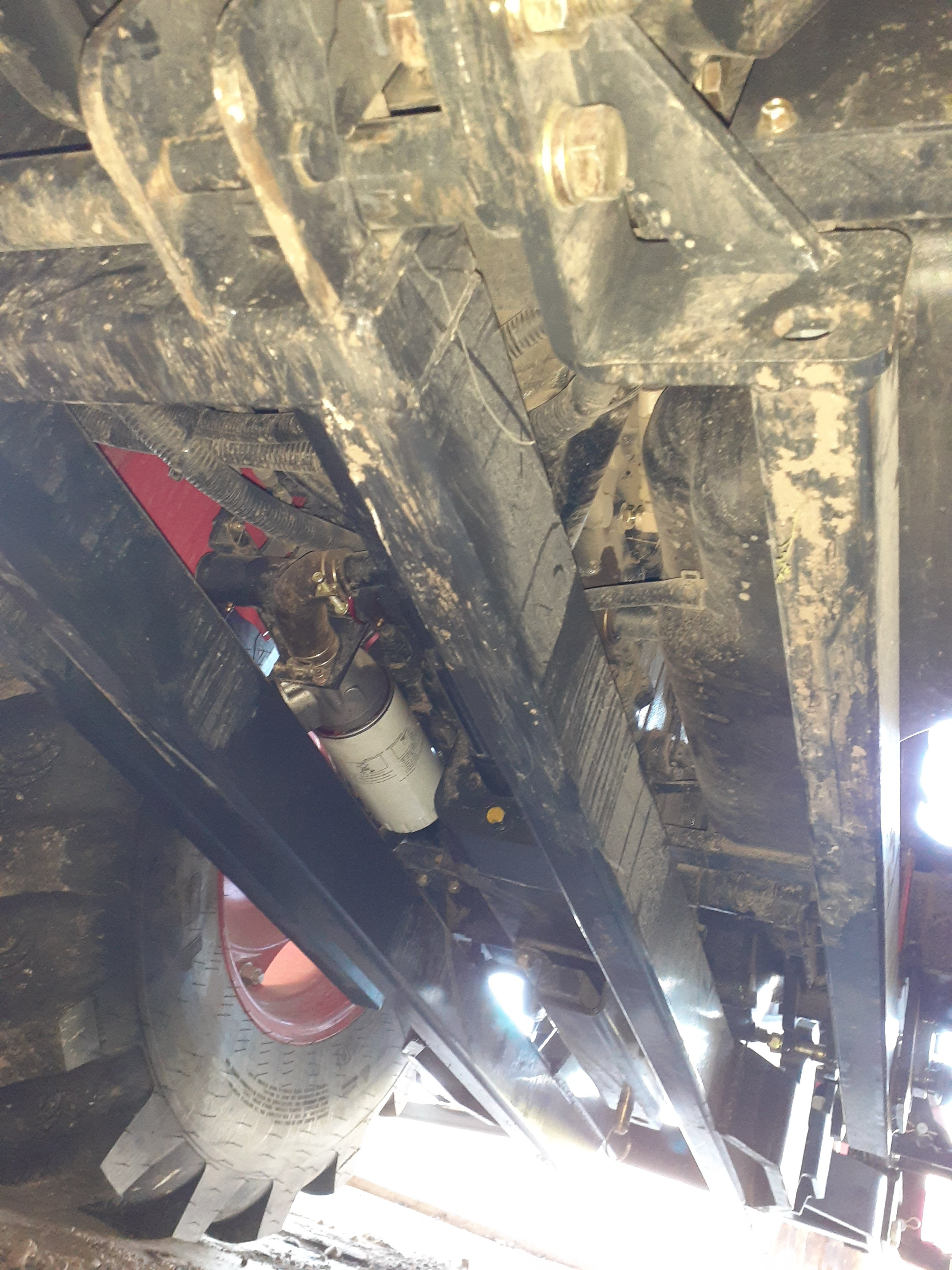

My factory BH looks like a 3pt BH with a frame. The frame is basically two big retangular tubes that connect to the BH where the lower links would go on, then run under the tractor. There's two forward facing hooks that once you remove the lower links, hook over the bolts that they mount on under the axle. The frame extends forwards nearly to the engine where there is a round cross member on the frame. They hook over that and lock down with a latch that you pin in place.
On the BH end here are some braces that angle up from the subframe to the BH. I use a turnbuckle top link when the BH is on, per dealer recommendation.
When I get a chance I'll take some pics.

I will be working mine today so I will try and get you some pics. B.
