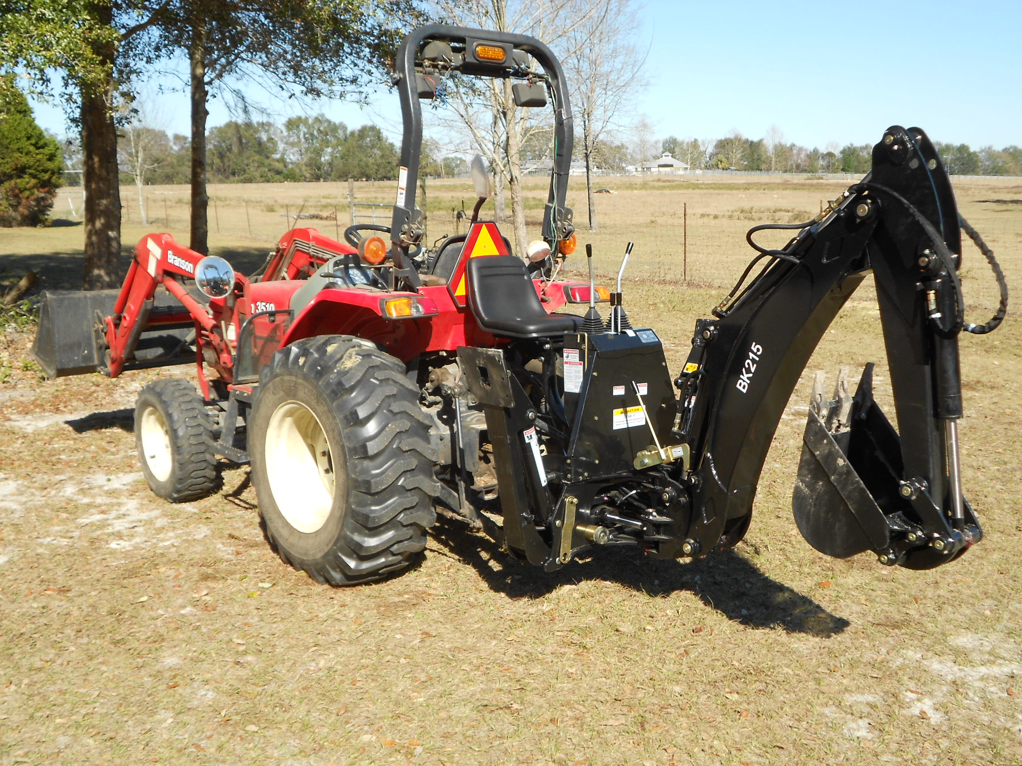

You need a subframe to keep from breaking tractor in half at the bellhousing.
I bought this Hoe new and made a subframe for it. I don't have pics of it.
Also you are better off using the tractor hydraulics, I only run my 3510 at 12-1400 RPM and have plenty of power.

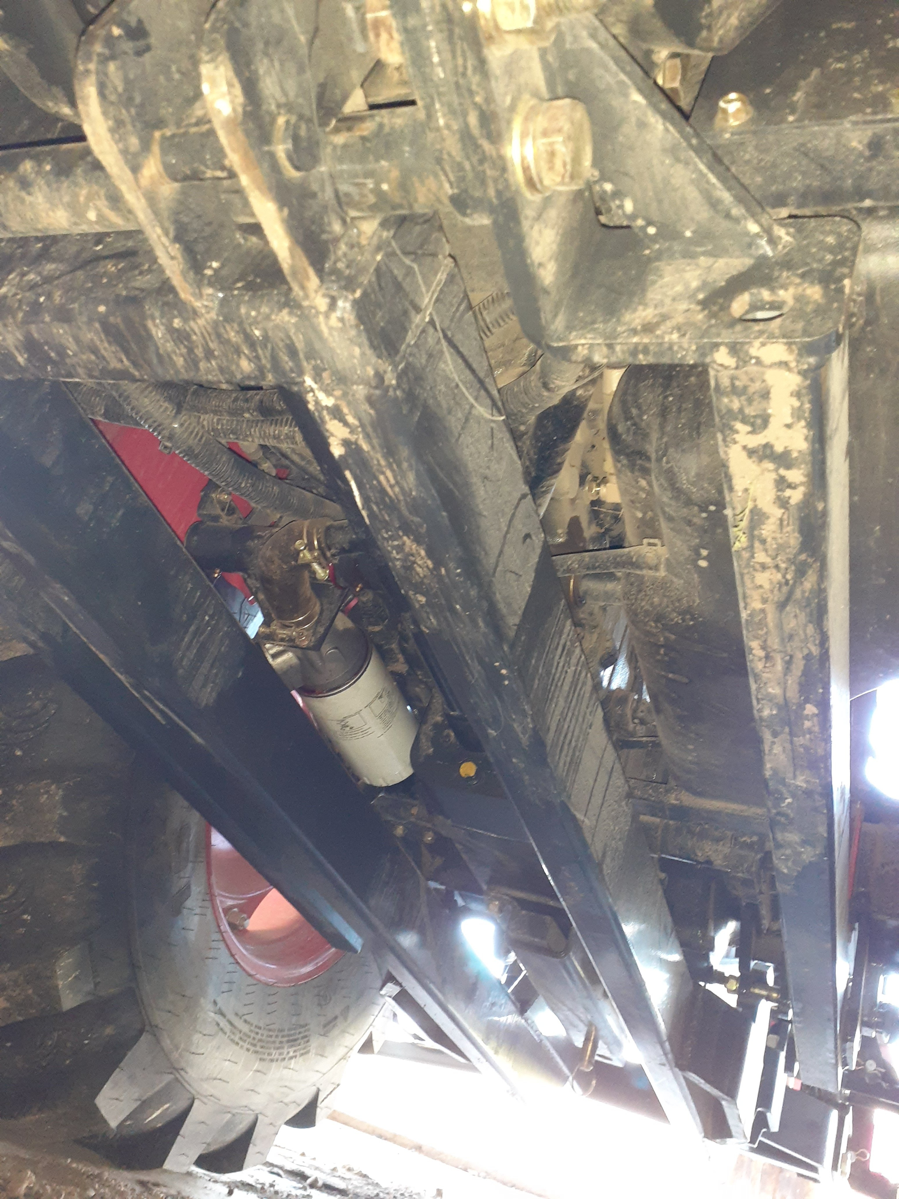

StimW or anyone else with a ho-made subframe care to elaborate? Do you have any more specific pictures or care to be a bit more specific with your build? I really want to get a backhoe on my tractor but I WILL NOT run one without a subframe. I have decent enough welding skills and would be able to modify an old subframe or build a new one. Can you give me a better idea on attachment points to tractor, what the subframe looks like where it meets the back hoe?
/ Backhoe Subframe #11

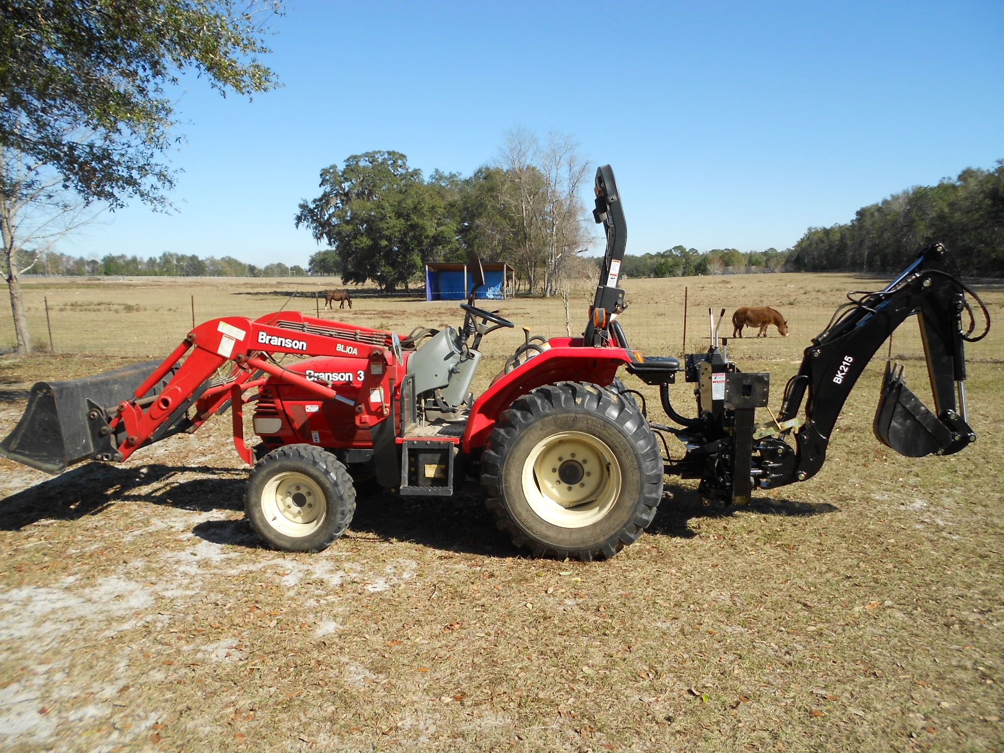

My factory BH looks like a 3pt BH with a frame. The frame is basically two big retangular tubes that connect to the BH where the lower links would go on, then run under the tractor. There's two forward facing hooks that once you remove the lower links, hook over the bolts that they mount on under the axle. The frame extends forwards nearly to the engine where there is a round cross member on the frame. They hook over that and lock down with a latch that you pin in place.
On the BH end here are some braces that angle up from the subframe to the BH. I use a turnbuckle top link when the BH is on, per dealer recommendation.
When I get a chance I'll take some pics.

I will be working mine today so I will try and get you some pics. B.
