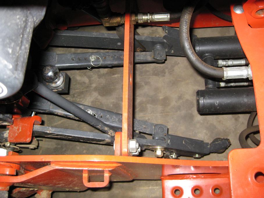

If I lower my B3030 arms and let them swing to the center position, they slip right inside and underneath the BH80-X frame. I don't have to remove anything... even with the telescoping ends (I never keep the top link on anyway). See pic below.
Have you ever actually tried this? Not sure why it would be any different on your L.
Also, curious why you have the PTO pump... your tractor hydraulics are more than adequate to run the BH, in which case the PTO pump is way more trouble than what it's worth.
It sounds like your backhoe is plumbed to the tractor's hydraulic system. What happens if you were to move the 3-pt position control lever while having the BH attached? Is the lever's hydraulic flow neutralized while the BH is attached or is it a best practice not to touch the lever because it too is alive?

The 3PH is the last thing in the loop and the pressure relief is ahead of it.
So, what would happen is the arms would stall on the frame and the PR valve would go into relief and squeal at me until I lowered it. Just as if I attempted to lift something beyond 3PH capacity.
Can't say I've ever accidentally done this though, but that's exactly what should happen. :thumbsup:

I will have to take a look and see if I can do this with my tractor... the pto pump/hoses/oil reservoir might be in the way... I will have to experiment. I got the PTO pump solely based on my dealer's recommendations. I have dealt with him for a number of years and he has always been fair and supportive, both on price and service, so I don't think he just wanted to make the extra $$ for the PTO pump. He said that it had been his experience that the PTO pump (with the L3400) provided more power and better response than the tractor hydraulics. I also like the idea of keeping implement fluids isolated from the tractor hydraulics... maybe an unreasonable concern on my part.

What is your ground clearance when you do this ,, I go through heavy brush and stumps and would worry they would hang up..???
It isn't easy to tell from the angle in my pic, but the cutout that the arms pass through/under is higher than the rest of the BH frame... in other words, the arms do not hang below the frame, the frame is still the lowest point. The arms of course hang no lower than they would if the BH wasn't there with the 3PH down.
So there are probably more things to be concerned about getting hung up on going thru stumps and brush... like an HST filter :eek:
