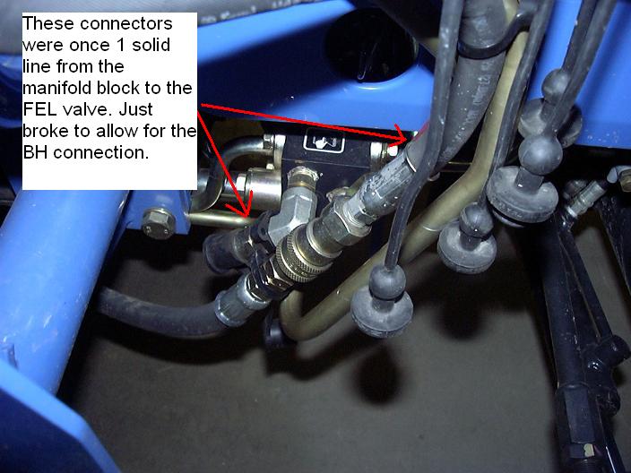

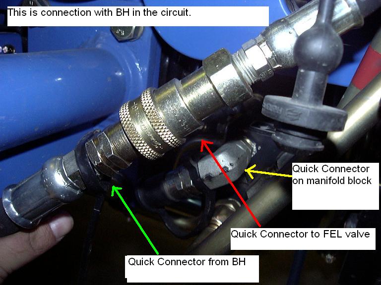

I think my setup is the same as Pineridge's setup. Remember that we had all solid steel lines to the manifold before the modifications were made for the BH.
I think this should work for you.
If you need any more pics let me know. I took these in a hurry. Might be able to get better pics of manifold in the daylight and the FEL in the air.
Hope this helped. /forums/images/graemlins/smile.gif

I went to my local dealer at lunch today. I showed him Hanks pictures and he agreed that is the common way to do it. He is going to work up a part list or kit and price for me just to compare my options.
I couldn't tell from Hanks pictures, but does the hose coming from the FEL replace one of the metal tubes, or does it run out of the power beyond port in the valve (which I assume usually has a plug in it). A picture here might help.
/ backhoe plumbing #27
Hi,
I don't have any pics of my tractor before the dealer modifications, but I would bet that it did have a steel line in place of the hose from the FEL valve to the manifold block. I think they just replaced the line with hose so I could easily switch back and forth.
Hope this helps and let me know how you make out.
