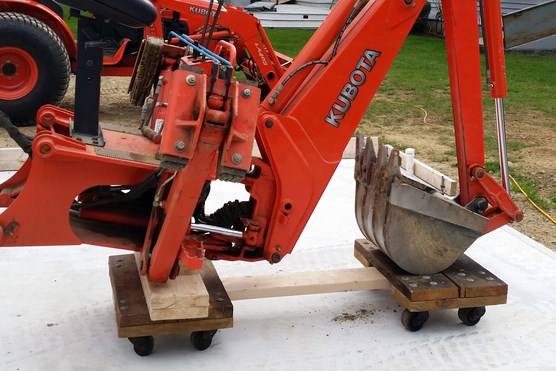

I'm designing a dolly for a backhoe on a new B2650. I've seen enough videos/photos to understand the basic design but here's my question: how high should the rear of the dolly be compared to the bottom of the backhoe as it sits on the tractor? Should the dolly just sneak under the backhoe with as little clearance as possible, or doesn't it matter? How much clearance would be too much clearance? Does it make much difference whether it's 1/2" or 2", for example? Thanks.

Here's what I use. I had the backhoe off this past weekend to aerate the yard.
I have the wood about 1/2" below the bottom of the frame. Just so you can wheel it under.
There's a narrow piece that's within the outriggers that's up close to the underside of the backhoe. It's a little hard to see it in that picture. I don't use my stabilizers at all to take it off or put it back on.
All the wheels swivel so it's easy to move it around in any direction you want.

BigBoyToys: Based on how it comes on/off the dolly, would you say it would be ok to have a bigger gap than 1/2"? Based on which casters I use, I may have as much as 2" clearance.

That must make it a whole lot easier when it comes time to remount the hoe too. I'm getting ready make something up for mine but don't have a hard pad to use, just gravel. Maybe it would be worthwhile to put some pavers down.
With the gap kept small it allows me to keep the footprint of the dolly tighter. The casters you use really shouldn't make a difference. I just added "height" with wood added on top of the dolly under the hoe. The guy I bought the tractor from gave me the two dollies in the picture. I just used a 2x6 to join them and then added a couple 2x8 pieces and a piece of 3/4" plywood to get the the spacing under the backhoe where I wanted it. I'll take a couple pictures of the dolly this weekend and post them.
You should be OK with a 2" gap. You might have to use the outriggers to get the lower pins up high enough to pull the hoe away from the tractor. Again I don't see why you couldn't make the spacing whatever you want it to be.

if the mounting is similar to BX ...
you just need enough clearance for the pins to be above the carriers when you lean the backhoe away from the tractor and onto the dolly. this way you won't have any sudden drop but you have clearance to wheel it away.
keeping this tight clearance also means less fumbling and no need to use the stabilizers to mount the backhoe. when you mount, the pins will be just above the carriers and you can easily transfer the load from the dolly to the carriers with the backhoe arm when you stand it up toward the tractor.
