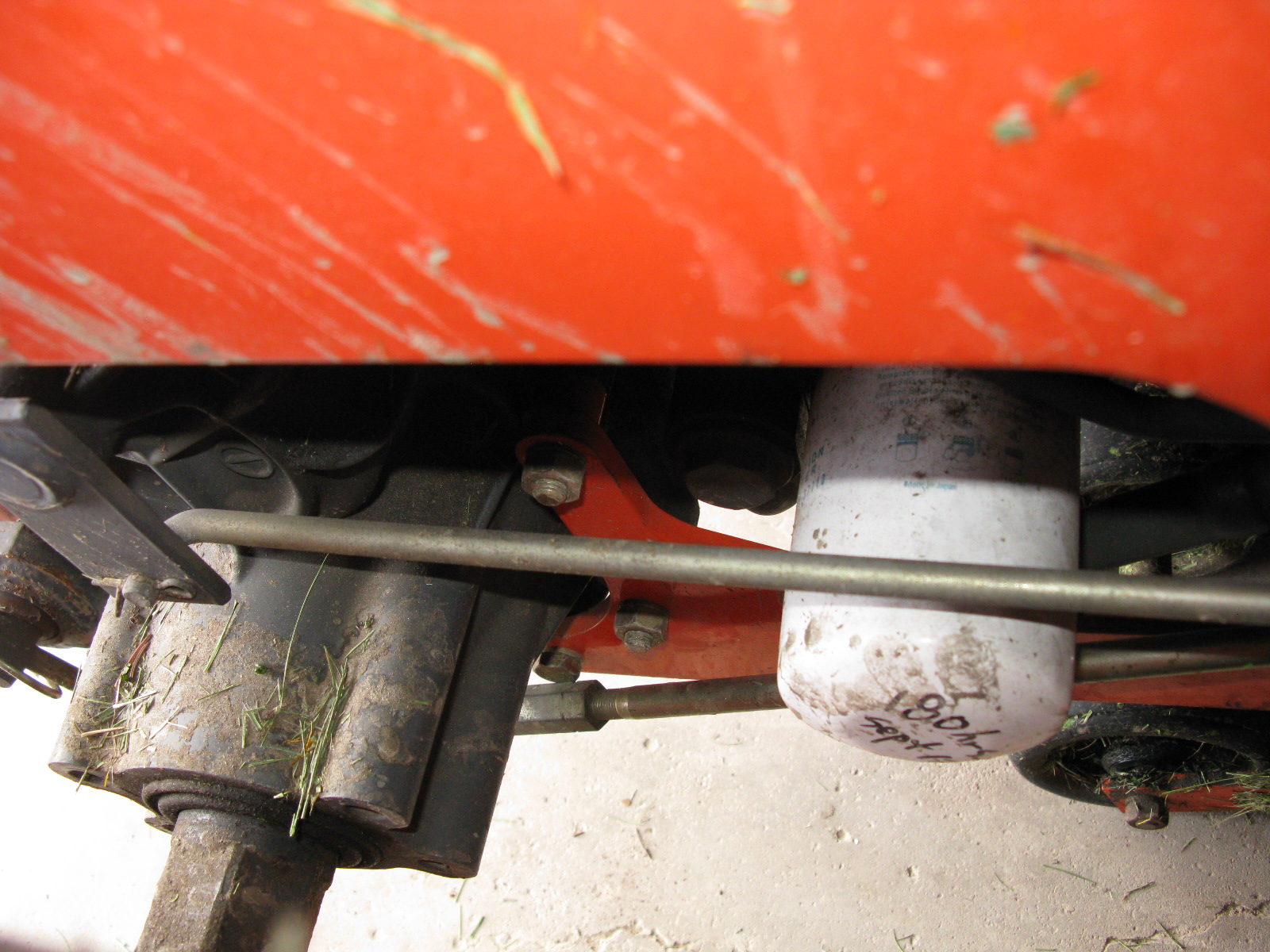

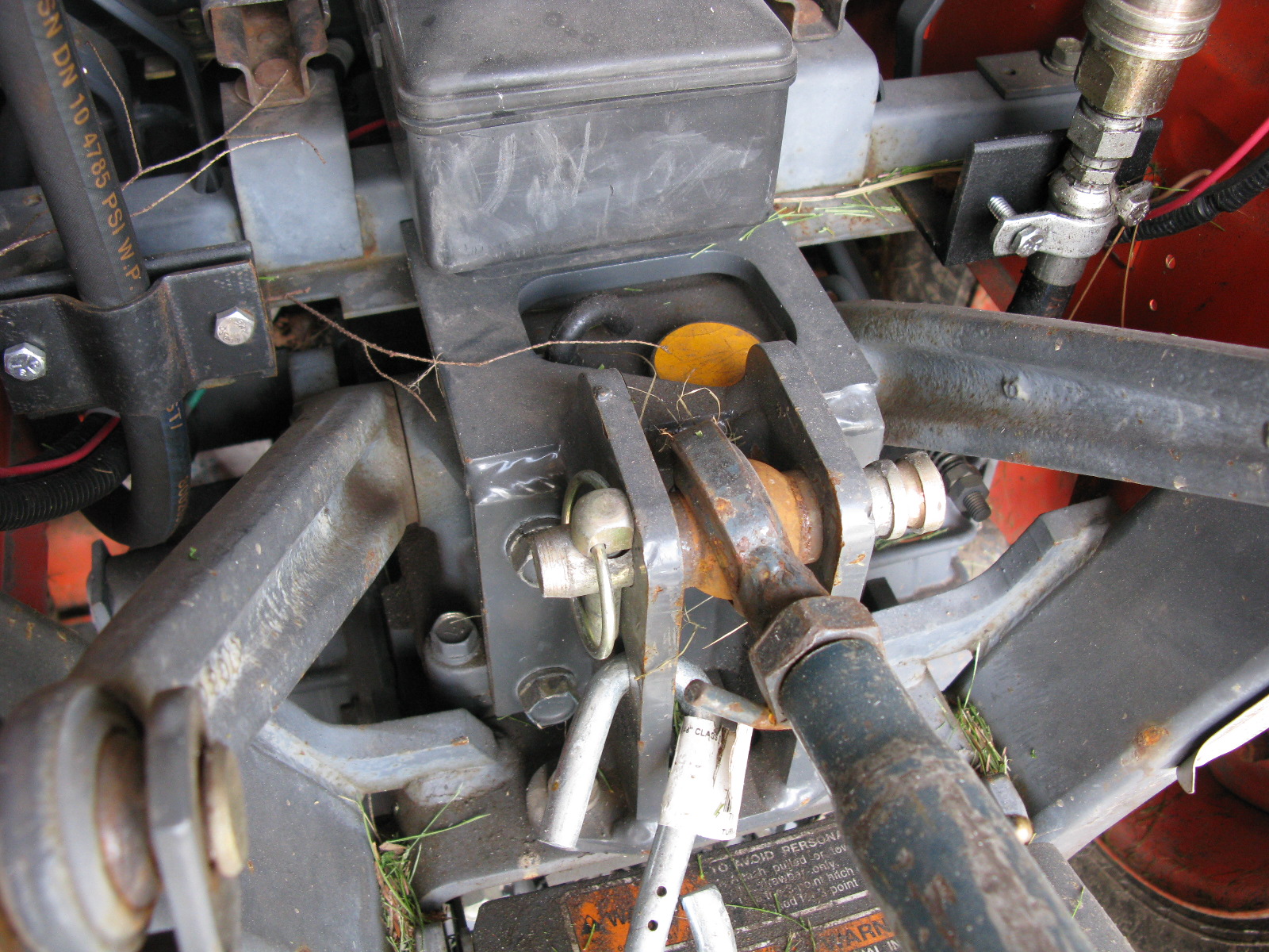

I'll let you know in a little while I'm just mounting a 3pth one on mine this week. Make sure you get the heavy duty top link part # 70050-540. There is also a frame stiffener bracket that should be added aswell part # b4681. I can take some pictures if that helps. The top link bracket should have 8 bolts in it. If you look under the tractor there should be an orange bracket on each side of the frame that runs from the front of the rear axle to the loader mounts. Kubota recommends both of these for the b4672 backhoe.
Could you provide the part number and or a picture of the orange frame bracket. I bought an used 4672A and am trying to attach it to my B7510. I have called 3 local dealers and each says they don't know what I'm asking for. The B4681 is the top link mount.

Its hard to get good pictures or the frame bracket because the mower deck is on I'll try. Basically it bolts to the sides of the rear axle and runs parallel to the frame and slightly lower and the bolts up to the front loader mounts. I was very surprised that my dealer knew what I was asking for. I'm sure someone here sent me a pdf with the part # and installation guide, I'll try to find it when I get home.
/ Backhoe OK on a B7500? #9
Here are a few pictures of the b4681 support frame kit. The last picture is of the upper link support, it differs from the original as it wraps over the top of the rear axle casting and has to extra bolts that come down from the top.
Hope this helps
