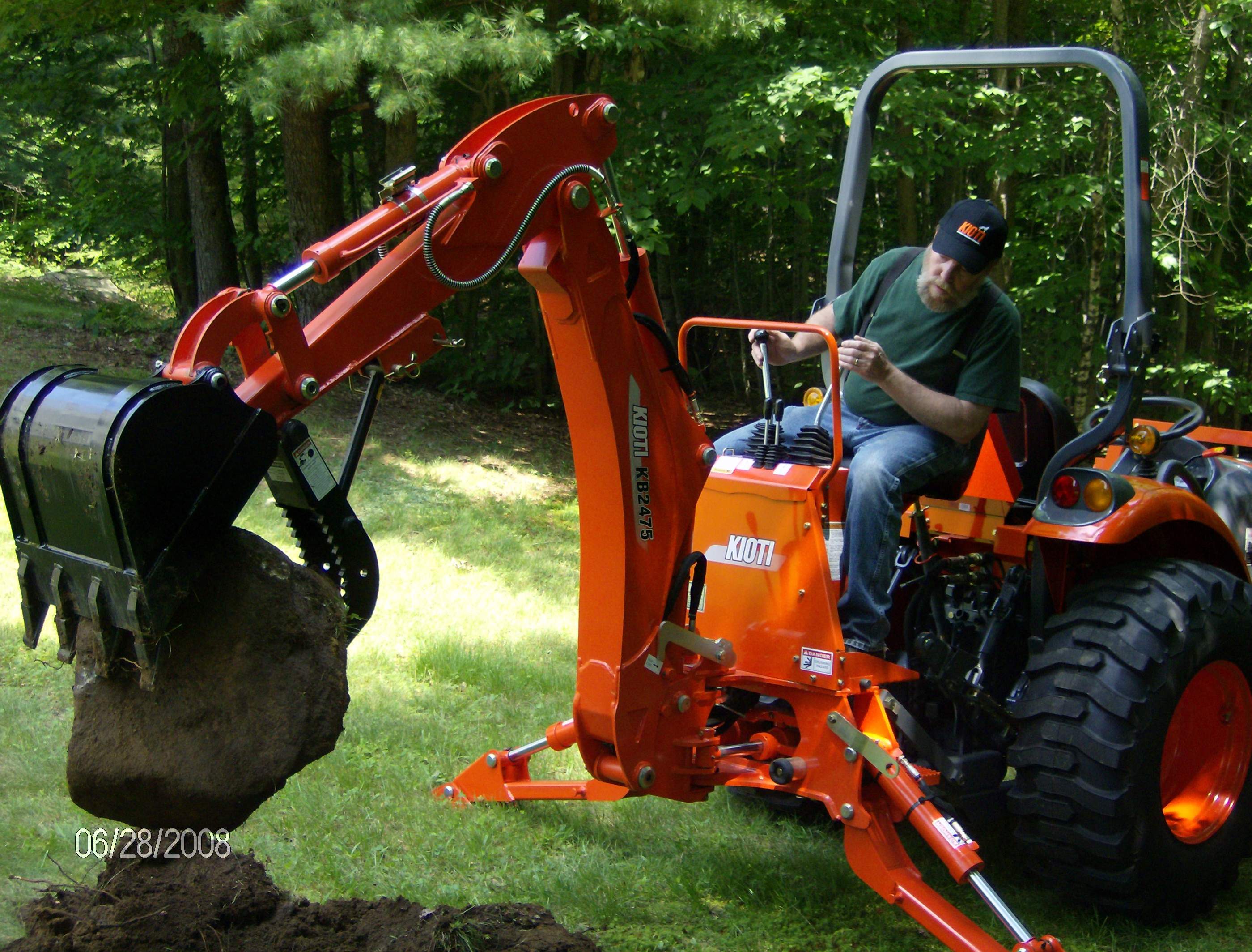

Here is a picture of the mechanical thumb on it's first day and first rock.

Well, the MIE Thumb arrived Thursday and I got to installing it today. After a couple of hours of work I'd give it two thumbs up. (Pun intended).
My opinion is that a thumb shouldn't be an option but a standard part of a backhoe package. Now to the hydraulic vs manual debate. IF money is no object definitely go for the hydraulic. The convenience and time saving make it a worthwhile option. It will be on my short list of additions. That said, I got some real hefty rock moved that I couldn't do without the thumb. I can also see some finesse placement issues that would be facilitated with hydraulics so that's another argument for it.
In the mean time, I'm going to get stuff done that I needed to so I'm a happy camper.
Thanks to all who provided guidance.
Bruce
