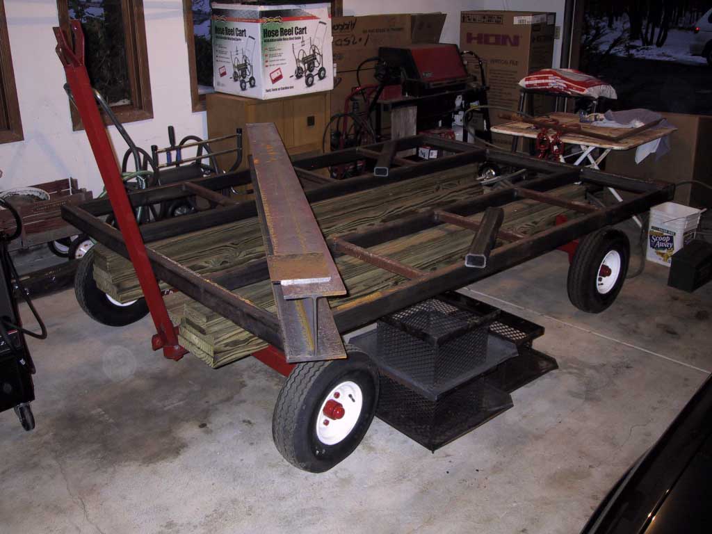

On the dump trailer, both the Provonost and the KingKutter units seem really nice. I'm using an E-Z Trail Jr.running gear to build mine - I got the one with the wider tread width (60") because I was concerned about tipping it when fully loaded. I wish I had also gotten the optional wider tires. In hindsight the narrower (48") unit might have been better for use in the woods. The bed on mine will be 70" x 96" when I get it finished. I think I will have around $1K in it for everything - running gear, steel, wood decking, hydraulic cylinder & hoses. Attachws is an image of the bed deck welded up, sitting on the wood for the decking and sides, on top of the running gear itself.

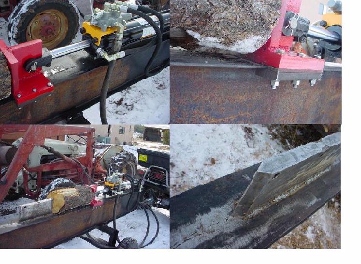

Anyway great projects. Also read and saw you are working on a Log Splitter. Attached is a photo of my Home Made Log Splitter. Made from the I beam of a mobile home tow tongue. Welded 2 of them together to get 6" width, the Cylinder is a 4-1/2" 25 ton 1.5 rod eBay special. The Knife is some 1"x6"x16" cold rolled I had in my "scrap" pile. Cut 2 -45* for the blade on the Band Saw. Nothing stops it - once cut a 2x6 across the grain just to see what it could do. I use the Hydraulics from the tractor with some quick connects. And Tow it around with the ATV.

</font><font color="blue" class="small">( I am From ~ NE Ohio - Bainbridge (Chagrin Falls area). Went to Kenston HS grad of '73. )</font>
Alright !!!! Another Buckeye ! I have a friend that's from the same area and he would graduated about the same time - you two may have even gone to school together. His name is Jonah Koslen.
Cool splitter ........ and a great mount for the control valve ! I may have to look at doing that on mine - I just discovered that I welded my valve mount about 1/2" too far forward and it is interfering with the ram plate ..... so I have to cut it off and reposition it. /forums/images/graemlins/blush.gif
It almost looks like your splitter is set up to split from both directions ...... ?
