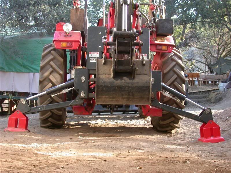

As always, nice job. Others suggested putting gussets on the feet, I think some thin walled flat plate welded to the supports to box it in completely (to keep out dirt, mud, etc) would be a better option, and would add stability (maybe more so than gussets).
/ Backhoe Feet
#32
Thank you.
Now that is a good idea to keep the dirt out and get support. I wish I would have thought of that before I put them on. I'll try them out as they are but if they fail, I'll box them in like that. Thanks for the good idea.

Which way did you attach the standoffs? Going parallel to the stab leg or orthogonal? When using my hoe, it wants to drag the tractor backwards if I'm not real careful. That type of action with your stout tractor, may test those welds.
/ Backhoe Feet
#35
I mounted them the way they are in the photos above, parallel to the leg so they don't flip over when the hoe wants to drag the tractor. But that is putting more stress on the welds in that direction. I hope they hold up and I think they will.

Nice job! My backhoe shoes throw dirt all over me too, I usually spend a few minutes 'jiggling' them up and down to try and clear the dirt off. Worst part is they throw crap all over the hyd cylinder shaft right before it makes it all the way into the cylinder, mine have scratches on them from crap sticking to them.

Yeah, that's why I want to try no support first. I'm sure I'll still get dirt thrown up at me, lol ... just not a small bucket full.

In testing them out and also the new feet, I found them plenty wide enough and they grabbed the ground solidly. A couple photos after getting the hoe on.
This shows how neatly the hydraulic hoses are routed with the check valves on the cylinders.
I know now those check valves work good. I dug a 4' x 4' x 4' hole as a test with no leak down at all. Took about 30 minutes to do that in my hard ground. The feet held up with no hint of buckling at all. Then I dug a 10' diameter about 4" deep for my water tank, but that was on all decomposed granite and it was as hard as rock. It was baked and I spent at least an hour and a half screwing around with that. So I settled for 4 " and put a steel ring up tp form the concrete base. No problems there either.
I think the feet and the DPOCV's modifications are a definite plus, making it worthwhile to get a more stable and safe operating backhoe.
