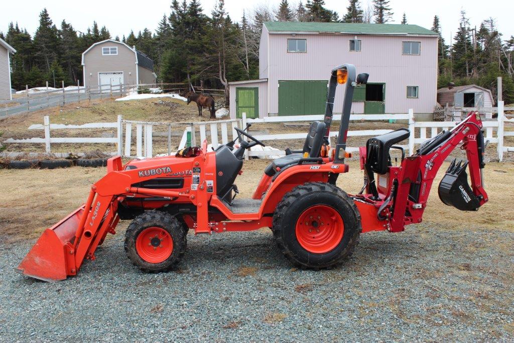

Hi Davey
I bought the Woods BH6000 for my B7510 last spring and don't regret it for a second. I went with the sub-frame assembly based on advice from this site. The backhoe can certainly throw my tractor around and I did not want the risk of doing some serious damage. I know there are 3 point units out there but for me it was 4 point. I agree with Zman, if you are use to commercial backhoes there are differences, but I have not found them to be a problem. The Woods does not use a separate hydraulic pump but ties in to the tractors. I purchased a new old stock hoe so I got a better price and did the install myself. It is not that complicated and the instructions are clear.
I have heard that Wallenstein make a good hoe as well.
Which ever way you go you will find lots of uses and can take your time and do the jobs you want when you want. Here is a pic of the hoe on my machine. IMG_2037.jpg

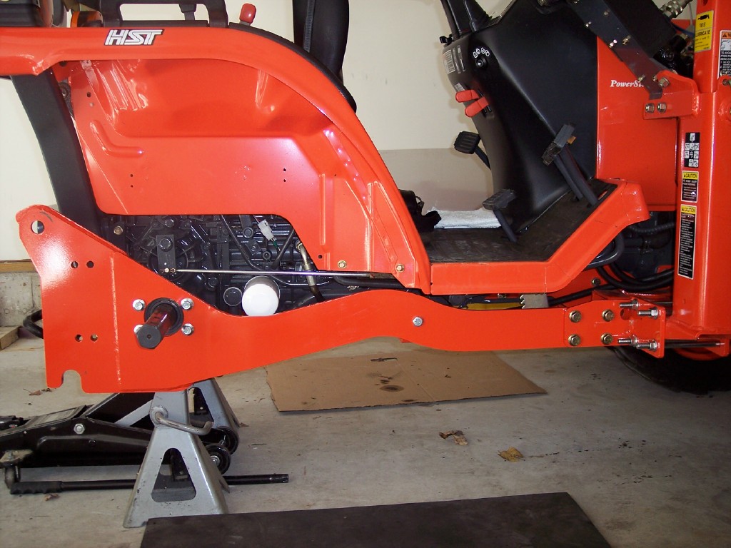

Scotty, thanks for the info. After reading some of the statements in other threads about 3 Pt attachments and sub-frames, I was concerned about damaging my machine so thought I should ask for some assistance on this site. Thanks for the advice. One question I do have is about the ground space and the sub-frame? Do you find it a problem at all? I have read that there is not much room to play with. What are your thoughts?
Thanks again,
DaveyD
/ Backhoe attachments for Kubota B7500 #6
DaveyD, you lose no ground clearance with the 4 point hitch. I will post a picture if I have a good one. The 4 point sub frame stays attached to the tractor and actually adds a nice bit a weight giving improvement when doing loader work, or when I use my 3 point snowblower.This pic shows the rear wheels removed and the subframe attached, with still lots of ground clearance.
Thanks Scotty, I appreciate the picture. It does look very stable and I can see where it would help with the extra weight. The picture shows clearly that there is no loss of ground clearance. Thanks again for the help.

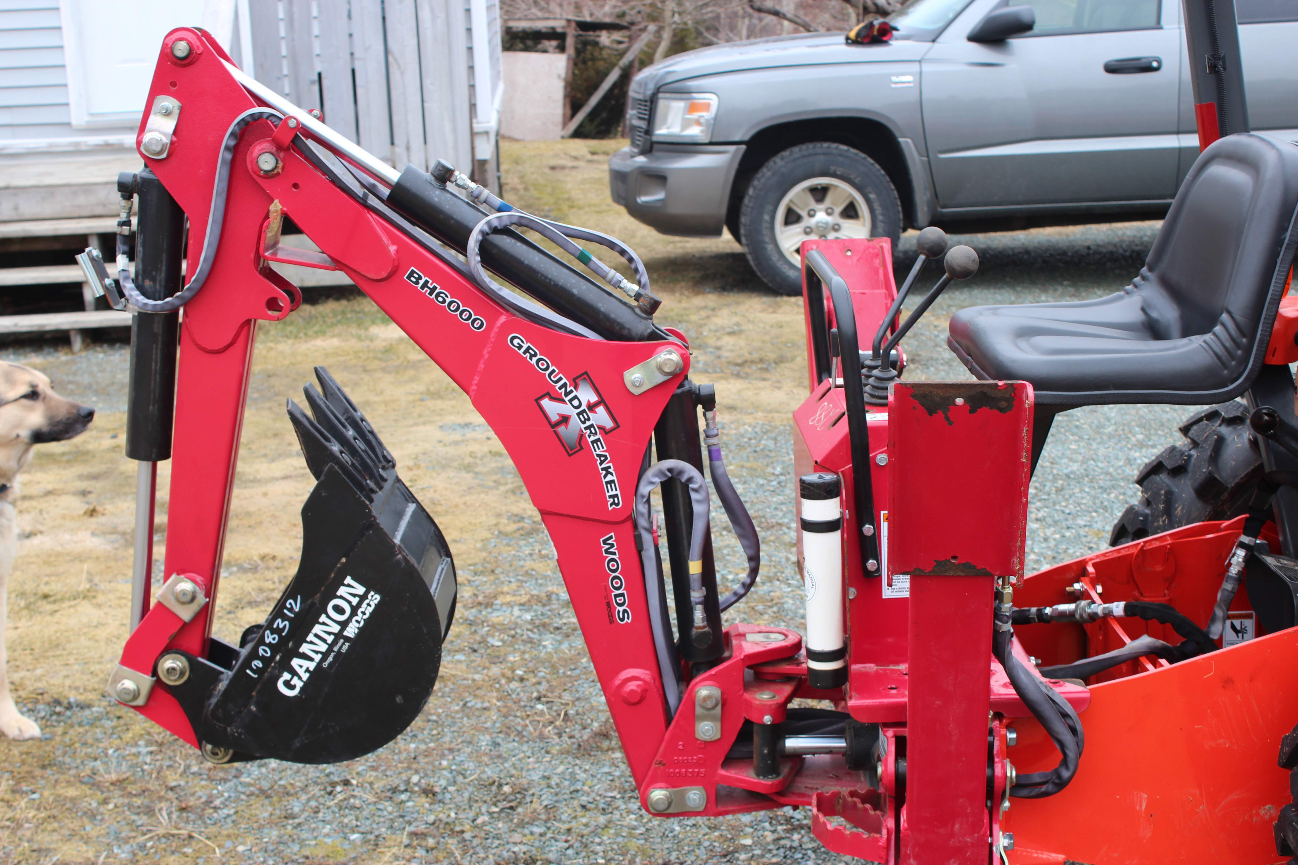

Hi Dstarr1322
The subframe kit is from Woods, model # is 1010613 for the Woods BH6000 backhoe. I could have installed the heavy duty top link but opted to go with the 4 point mount and she is rock solid. I have to keep the rpms at or below 1500 or I bounce the whole back end of the tractor around. Not sure if this will work with the Kubota 4672, but I am sure it can be modified to fit.
Lots of luck. Any other questions just drop me a line. Help out where I can.
Here is a link to some pictures and the 4 point manual, https://1drv.ms/f/s!Ag49X4J6zgBn2GAPndpmqb9GHmeM
