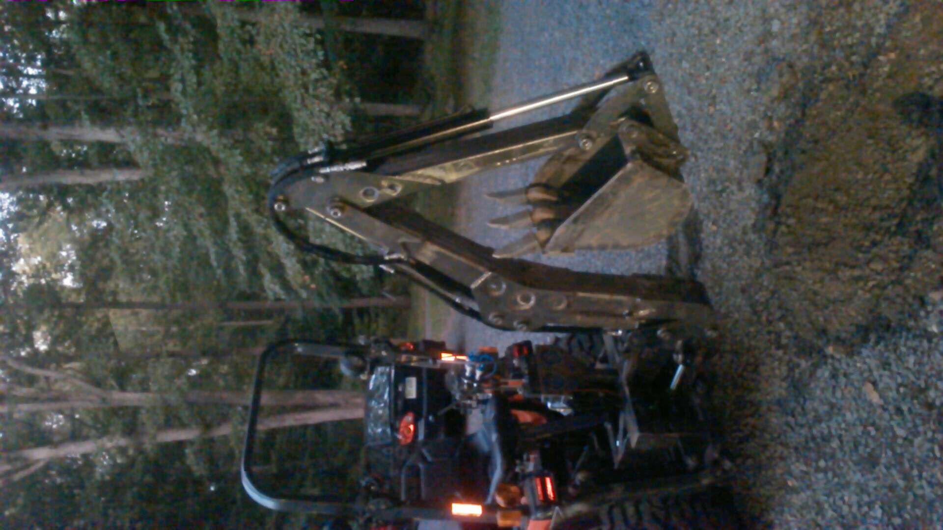

I took off the original 5hp Briggs 1.2 gpm single stage oil pump and swapped in an 8 hp tecumseh and a 11.5 2 stage oil pump. I've had the frame rewelded once when it started too split across the frame between the out riggers. The wheels can switch with the out riggers for towing behind a vehicle.
I used Northern tool to match oil pump and motor and cylinders. Very handy tool. I'm glad it is not always hanging off the tractor- hate to tie a tractor up like that.
It is the outriggers that allow a backhoe to dig. The bucket pulls one way and the outriggers resist that pull. It is not the weight or ballast of a backhoe that provides the digging power - but the out rigger resistance (unlike an excavator).
I think that depending on the hitch mount of a pick up or tractor for that resistance is asking for trouble. Those cylinders combined with the mechanical advantage can generate a lot of torque (in many directions) - more than a hitch is designed for. (That is why you don't see backhoes mounted to lift arms on tractors. They have their own sub frame.)

Yes, it can be "safe", it can also be DANGEROUS.
The difference between safety and danger is likely more a function of operator judgement than any (perceived) mismatch between machine mass and attachment forces.
It is a common situation, i.e. many/most back hoes have enough force to pull the whole rig toward whatever you hook into if that doesn't move - an example being ledge.
The machine's mass is usually the limiting factor, not the hydraulics.
Even the BIG excavators have their limits and if you watch skilled operators you quickly realize that they do a lot of work very quickly by working WELL WITHIN the capacity of the machine - not taking the biggest bites possible.
There are rocks my hoe can't lift - OK the usual and acceptable solution is to dig a big enough and deep enough hole beside them and roll them in, i.e. just bury them deeper.
