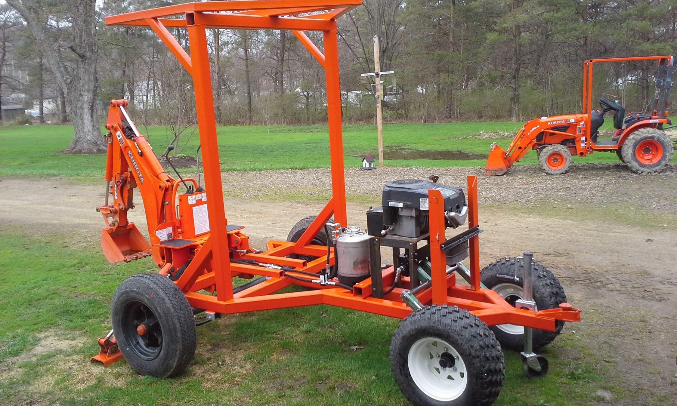

DIY towable backhoe, in the making
Hi there, I do not have a tractor but need a digger. (Don't ask why, I just need, OK):laughing:
Was looking at towable one and thinking I can "easily-ish" build one.
Then started to look at used backhoe attachment on kijiji.
Looks like I could get one for cheaper then the hydraulic and control. Not taking about material and design issues.
So wondering if anyone have the similar idea about building a trailer mounted with hydraulic pump/motor, around a "off the shelf" backhoe attachment.
This could be extended to be a 3 point trailer on which I could eventually mount any 3 point attachment, but I don't have any, and read that 3 point might not be the best for backhoe as weaker...
Since I don't have a tractor, I am free to find any backhoe attachment "size", but can someone shine some light:
1) am I stupid / pioneer (hard to differentiate sometime)
2) What size motor pump should I get? When attachment is meant for, let say a 30hp tractor, should I get a 30hp motor or power at pump is not as much as tractor rating?
You need to know how many gallons per minute of hydraulic flow the attachment is rated for and at what pressure.
Then you can use one of the many hydraulic calculators out there to see what size motor and pump you will need.

Holy smolies man, you do not need anywhere near a 30 hp motor. I kind of have what you want to build, but mine is an off the shelf log trailer that can mount a backhoe upon it. In my case a 6.5 HP with small hydraulic pump gets the job done. It can dig anything, it just does not move fast doing it.
As for being on a trailer...it has some real limitations because while I can swing my boom around 270 degrees, I cannot dig where my trailer is. So to dig a water line lets say, I have to carefully put my trailer perpendicular with where I want to dig, then dig 180 degrees to my trailer...yes on each side. By leap frogging along the intended trench I need I can get the job done, but it is a lot of maneuvering. Sometimes I have to put down planks and back my trailer over a dug trench to get where I need to. Sometimes it is a bear to get the trailer at the right spot I need to dig!
It is nice to have kicking around though, and beats a shovel, but I am not going to dig a house foundation with it that is for sure.
If you build one, make sure you can dig 270 degrees around the back of your towable unit, and just have a tongue on it. Also only put one axle on it and not two, that way it can be self movable. Just use your backhoes to lift the dead end off the ground and then by curling in your bucket, drag the machine ahead on the wheels that are in the back. When you go to dig, the frame sticks down into the dirt and holds itself there for digging. In this way you do not need to tow yourself into position everywhere. (Mine cannot do any of this).

If you are buying a used backhoe attachment initially intended for one specific machine, match the pressure (less will drop your digging force, more could easily damage something) of the hydraulics it was intended for and go with less flow than the base machine intended. The toe behind wont have the weight of a tractor on it to keep it from jumping around, so you will want to go slower for a bit of reduced violence.
on a budget, you will definitely want open centered hydraulics, because closed centered hydraulics pretty much require a variable displacement pump, and those are much more expensive than a cheap gear pump.
Once you have a flow number you want to hit, you can calculate the pump size based on that and the engine RPM (usually 3600rpm for small stationary engine like a Briggs or cheap Chinese Honda knock-off). once you have pump size and pressure, you can find torque requirements pretty easy.
here are the pertinent calculators;
Hydraulic Motor Calculations - Womack Machine Supply Company
here is an example on choosing pump and engine;
lets say you want 2000 psi and 7 gpm.
a .5 cu-in/rev pump will give you a bit over 7 gpm at 3600rpm, so lets go with that.
here is a fairly cheap .55 cu-in rev pump that can be spun to 5000rpm and can handle 3480 psi; so that will give us a generous cushion and the pump should actually last quite well in this application.
Hydraulic Pumps | Gear Pumps | Dynamic Hydraulic Gear Pump �.55 cu.in/rev | B537177 - GlobalIndustrial.com
.55cu-in/rev needs to only spin 2940rpm to make the desired flow.
.55cu-in/rev @ 2000 psi needs 175 in-lbs or 14.6 ft-lbs.
the harbor freight 8hp engine makes 14.9 ft-lbs peak at somewhere near 2500rpm, so that would be a great match for this combo when driven directly.
8 HP (31cc) OHV Horizontal Shaft Gas Engine EPA
this combo would cost $230 for the engine and $95 for the pump, plus whatever you need to splice the two together.
another possible solution would be to use a go-cart clutch and chain to attach to two. since you would get a gear reduction when doing that, you would need a larger pump, but don't get a gear pump that would be spinning less than 900 rpm when running. they loose efficiency going too slow.
you might do a belt drive and could gear up or gear down the pump. if you speed it up, you can use a smaller cheaper pump. Just be sure you don't spin the pump faster than it is rated for at full engine speed.
ETA. don't forget filtration!

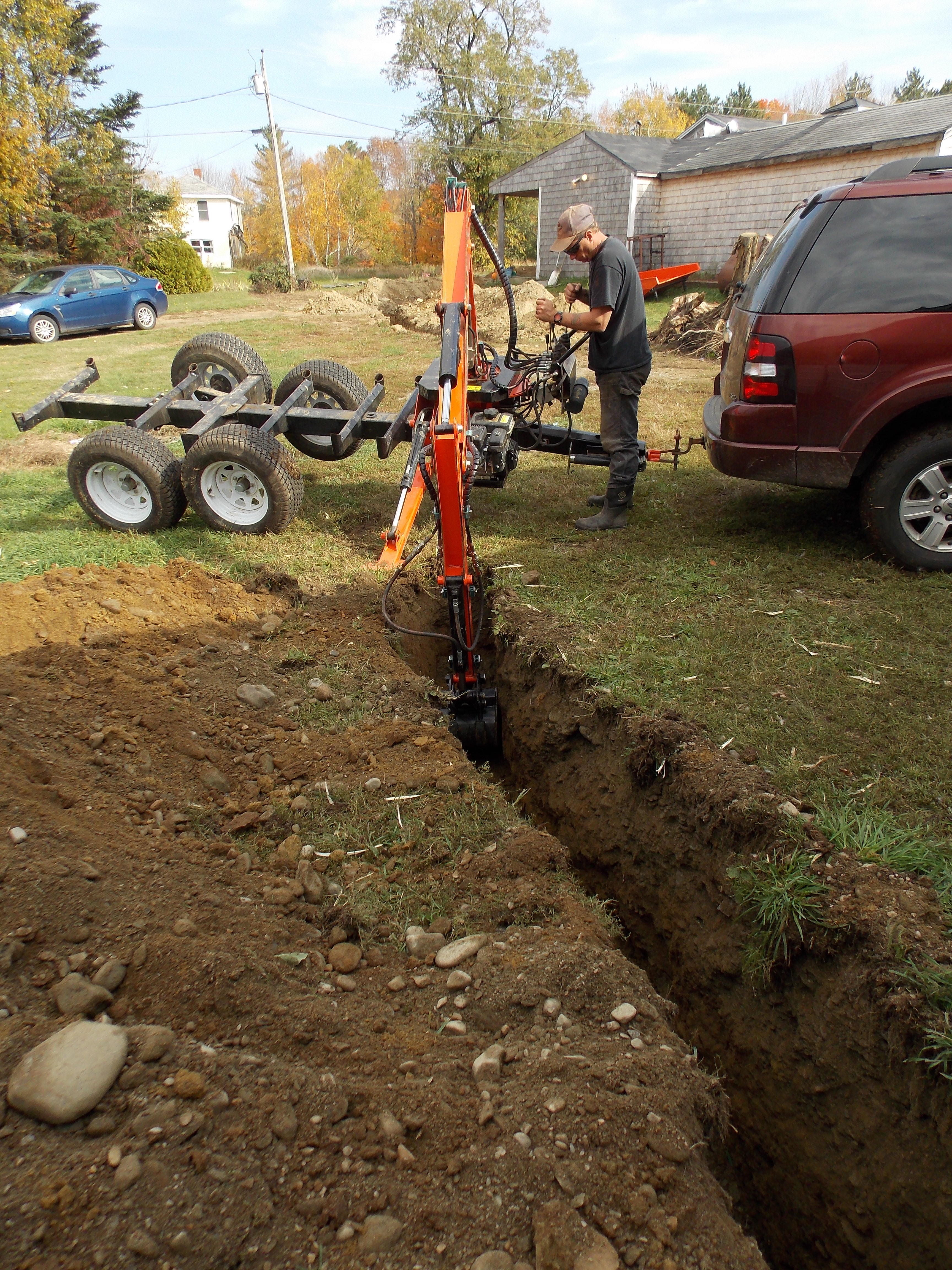

Back hoes, excavators and similar devices are able to do the work that they can do largely because they have MASS against which the bucket can pull/push.
Mounting something on a trailer would put it on (relatively) squishy wheels and you would find them flexing as they absorb some of the force - then letting go when what you are digging into comes loose.
Don't count on the mass of the tow vehicle to help you out, the trailer is is attached by a hinge - a 3D hinge (ball/coupler) at that.

a backhoe attachment likely has outriggers, so the back will be solid. If its got a decent sized tongue it would have loads of leverage against the ball. it could be easily useful. Like I said, I'd just go a bit slower with it.
/ Backhoe attachment, on a trailer. Making it a towable! #20
This is more in line what I was thinking about. I still do not see more then $3000 in it, and other than the bucket curl cylinder being too short, it is a lot more capable then my Wallenstein Log Loader Backhoe because it can go deeper. The video also shows how two wheel towable machines can be moved on their own power.
Don't get me wrong, this is no Hitachi 1200, but for the money, and ease of build, I think its a very decent machine. I think if someone spent $3000 building it, they would be happy versus that of having a spade and pick axe.
