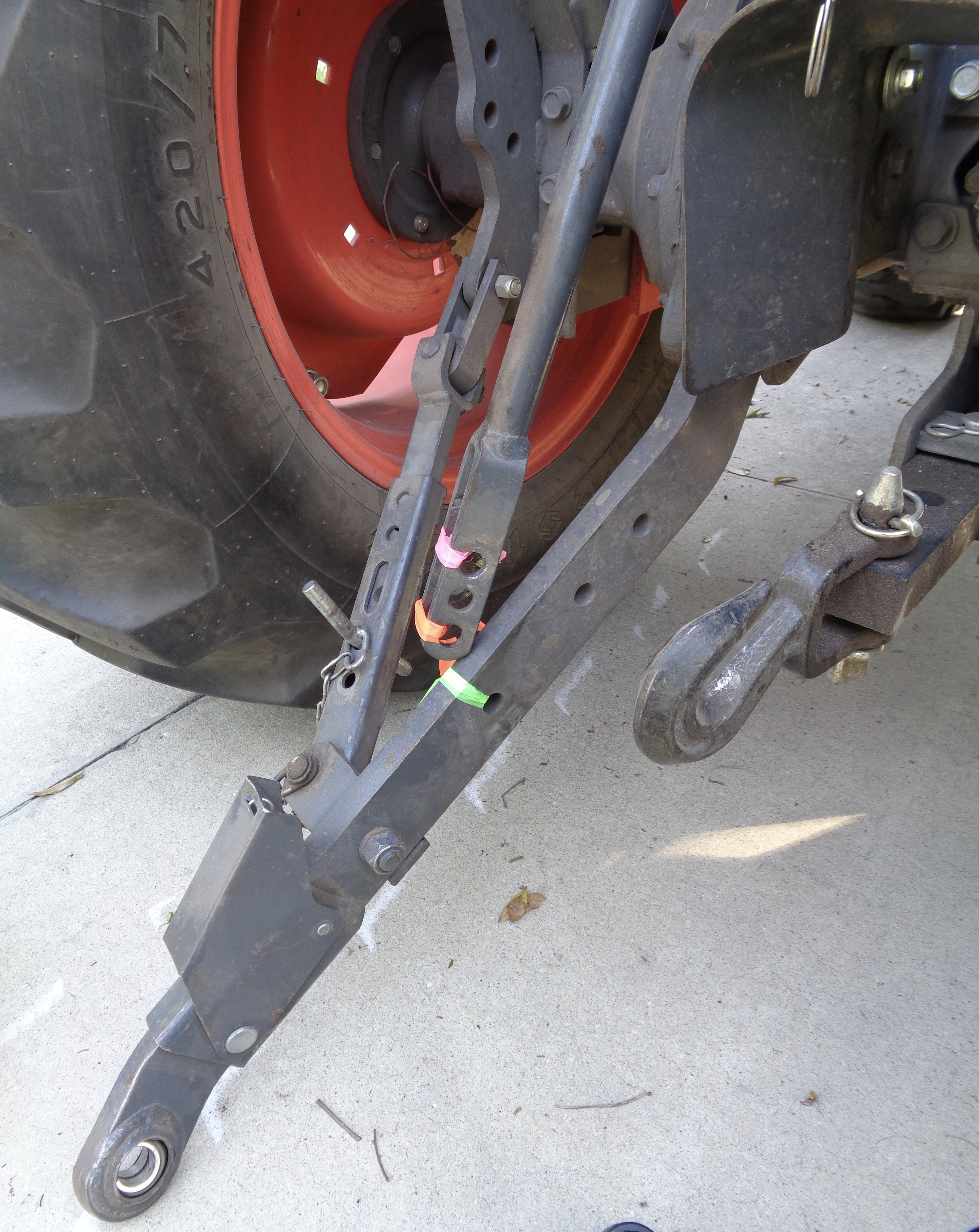

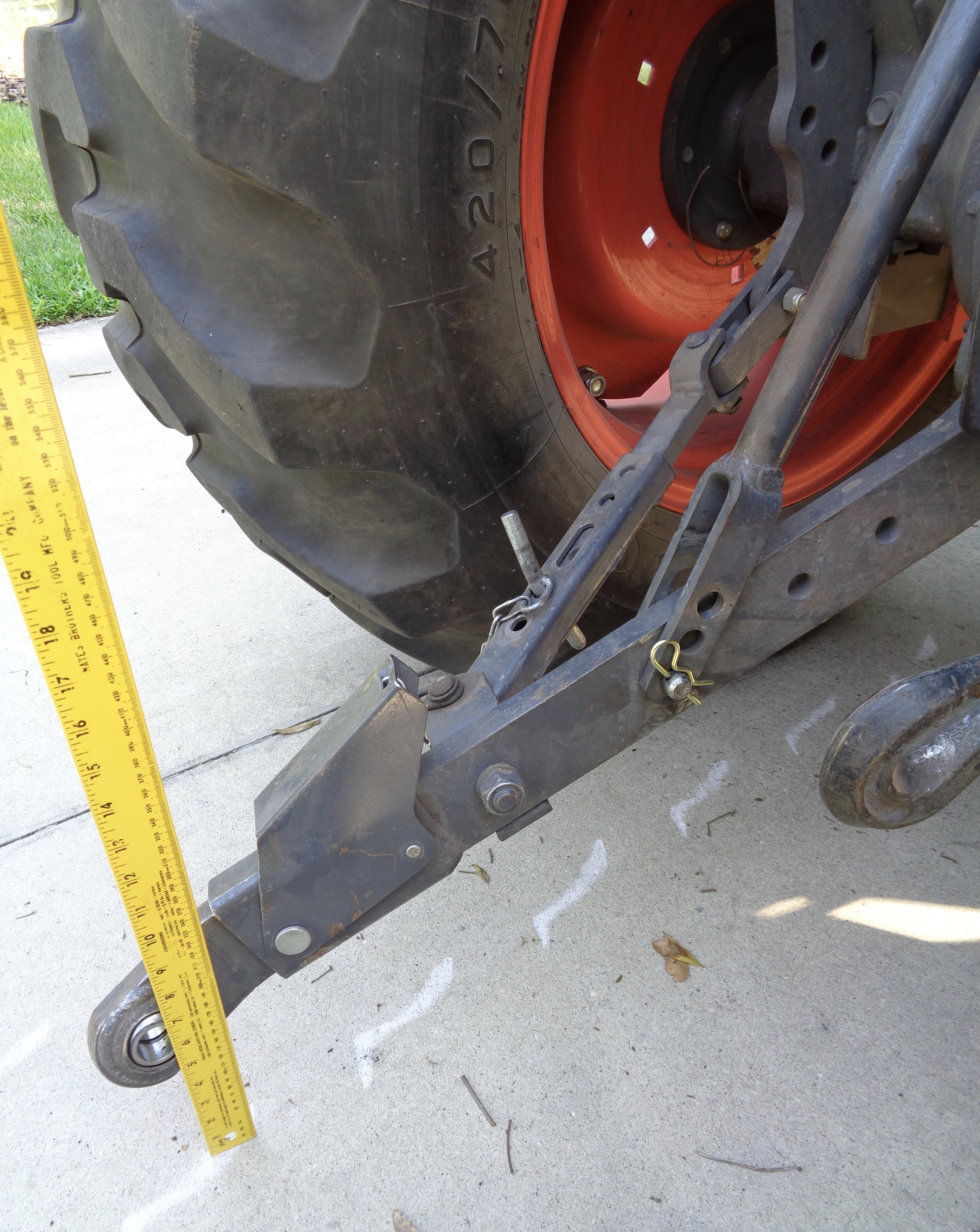

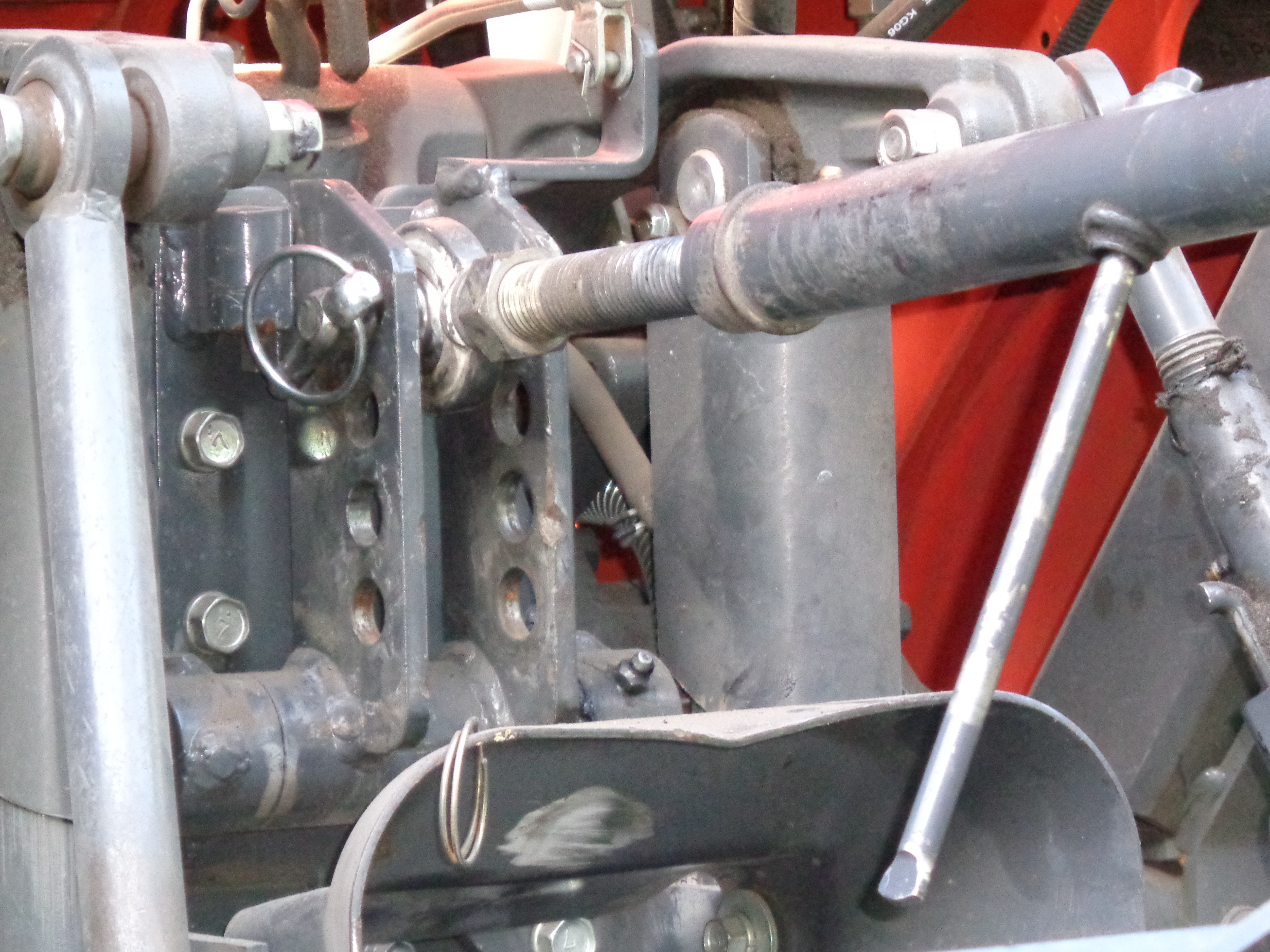

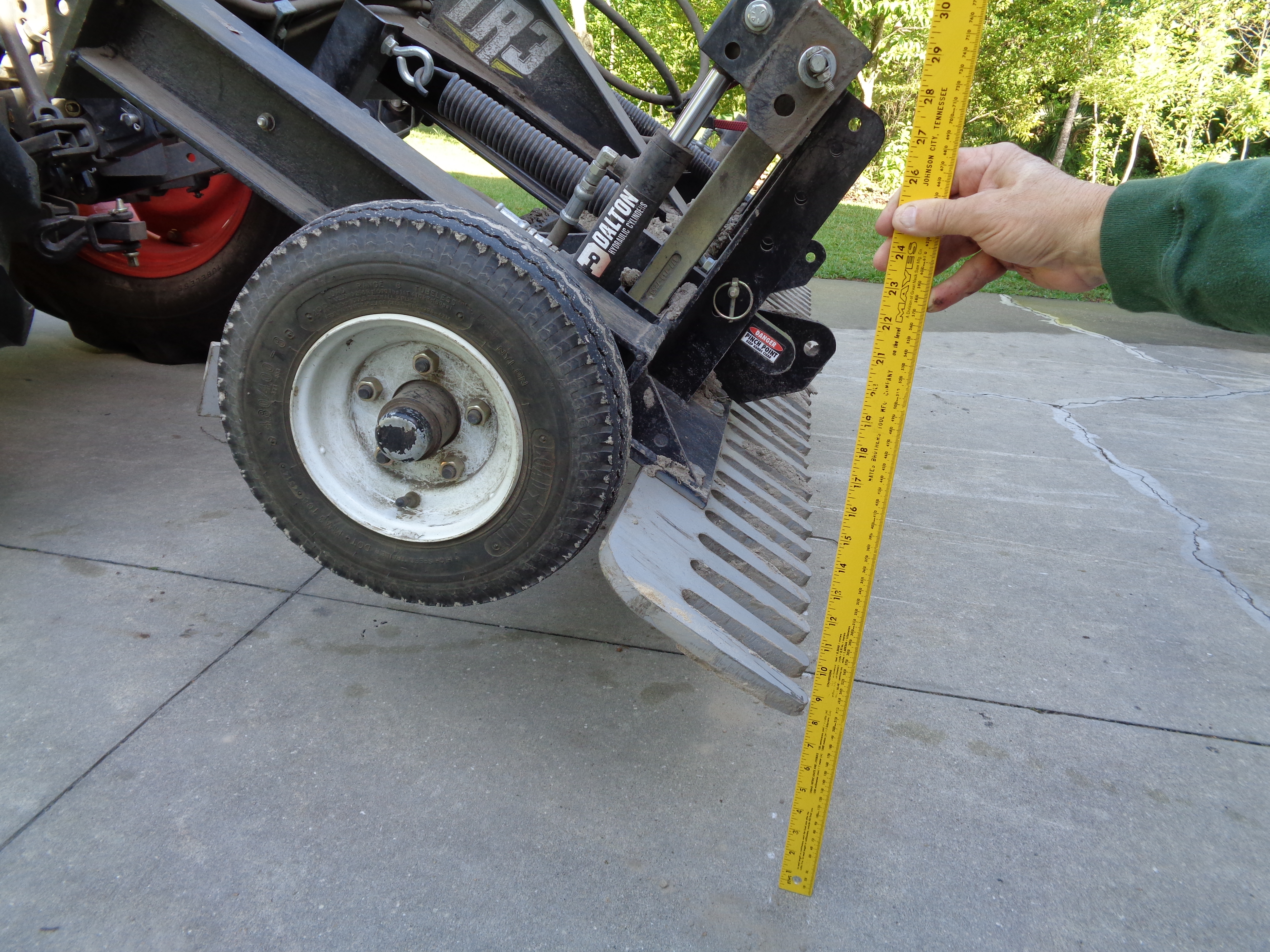

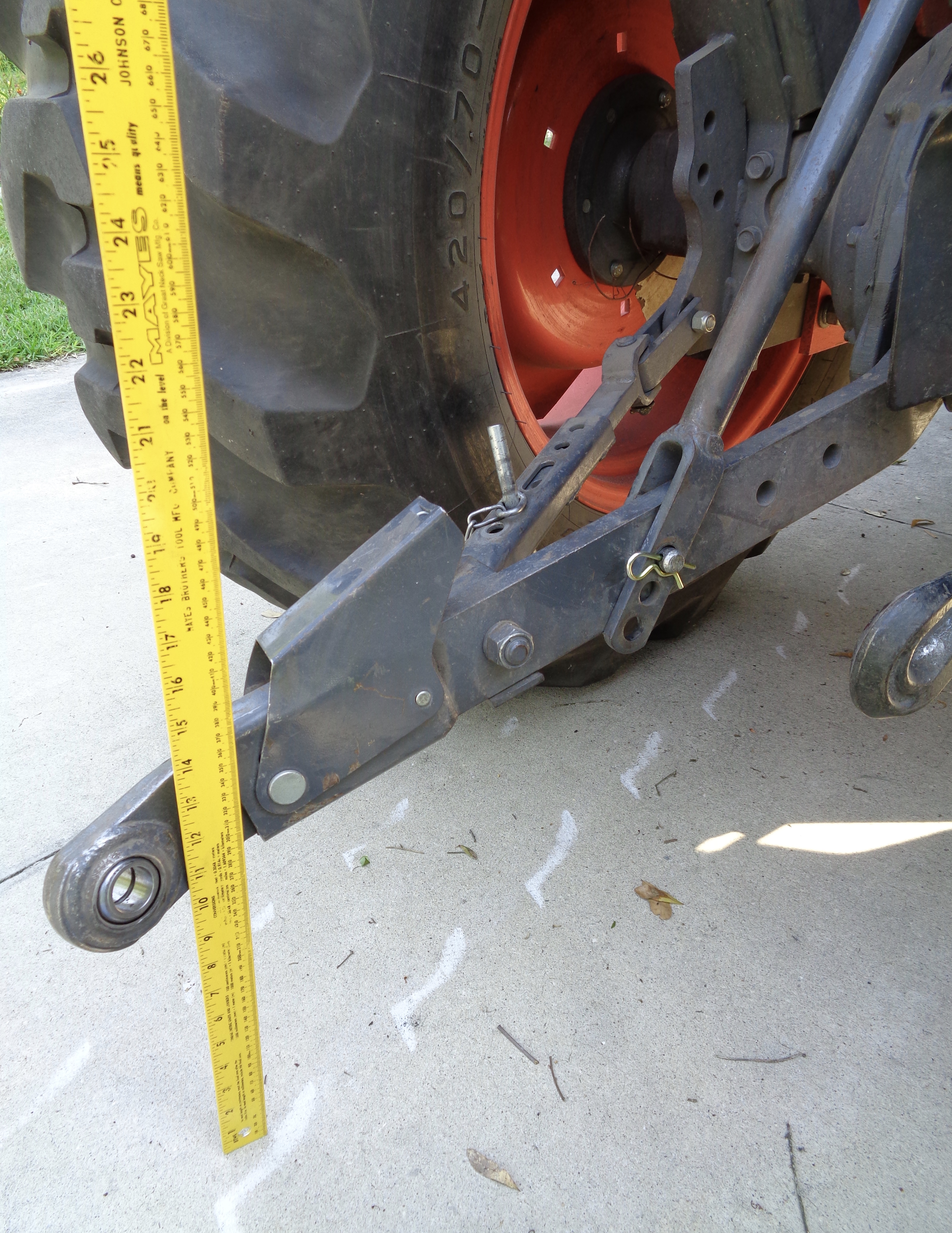

1) Have you checked the parts manual for your brand of cutter to be sure 15" tail wheel is/was the correct diameter, rather than 12"?
2) In normal operation the tail wheel should be in ground contact. Bouncing over rough ground with the tail wheel elevated puts great stress on the entire Three Point Hitch. It is possible to strip threads out of the Top Link during a hard bounce.
3) Are the LIFTING ROD stirrups pinned through the highest hole where LIFTING RODS connect to the Left and Right LOWER LINKS? Higher hole = higher lift. PHOTOS 1-2-3
4) Is the inboard end of the TOP LINK pinned in one of the lowest pairs of pin holes? Lower pin holes increase lift, but not as much as distinct pin adjustment in 3) above. On my Kubota L3560 there a four pairs of adjustment holes. Your tractor may vary.
PHOTOS 4-5-6-7
