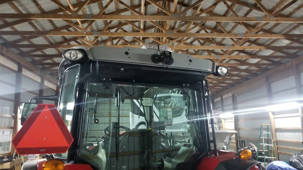

Ive been using my gopro and ipad as temporary remote video monitoring for years. Backup camera for bumper hitches on everything, gooseneck is nearly impossible without getting out of truck several times because of crew cab and tool box in bed, watching clearance on speed bumps with my boat trailer or t top clearance under some tree limbs before I sold boat.... not good for any long term usage

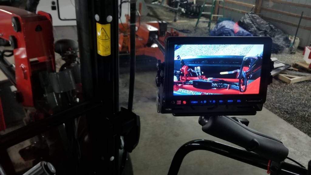

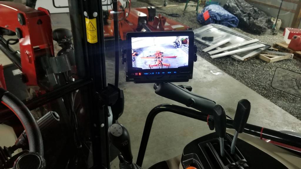

I like your monitor mount. My right hand door is worthless for trying to use so that spot would be ideal.
Thanks. It works well. I can still use the door...mount is very solid
I have a Ram mount in about the same spot for my phone. My right hand door is usable for access, just not ingress or egress. The go pedal & joystick are in the way. I could squeeze past them, but its risky. Very risky if the machine is running.

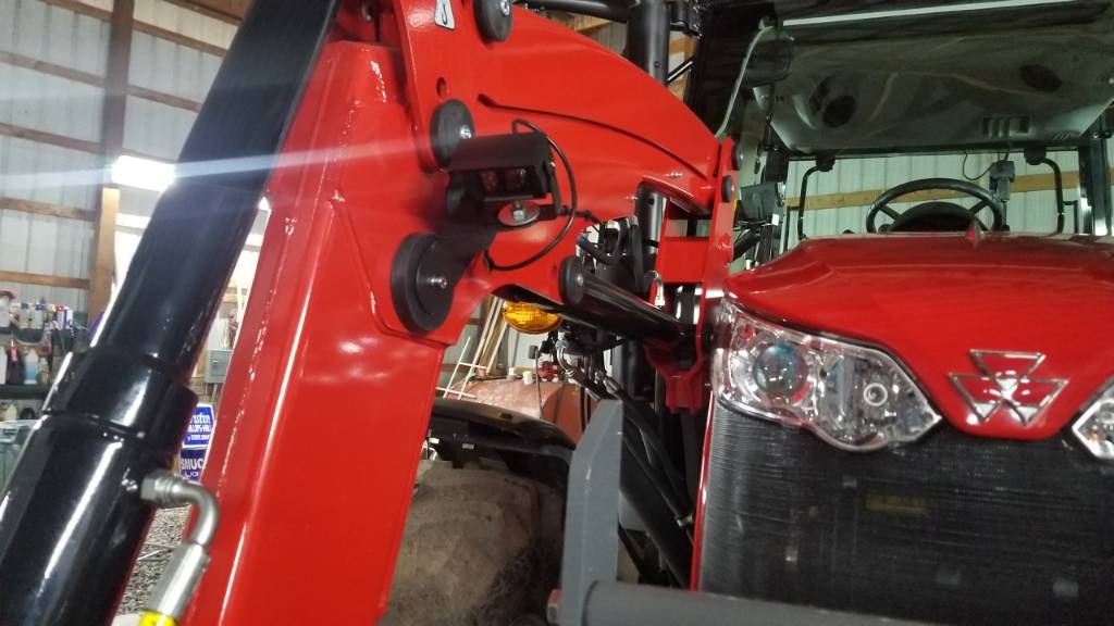

Not a waterproof display but good for a cab tractor. I got this setup over Black Friday/Cyber Monday on Amazon (it was under $200 in that sale). It has two wireless cameras and a 7" display. I've already mounted the camera for the rear to use while snowblowing and I am planning to mount the second camera on the loader cross bar so I can easily see my front QA when hooking up attachments. The cameras only require a power connection so I am wiring into the parking lights so when I turn the parking lights on, the cameras will come on.
