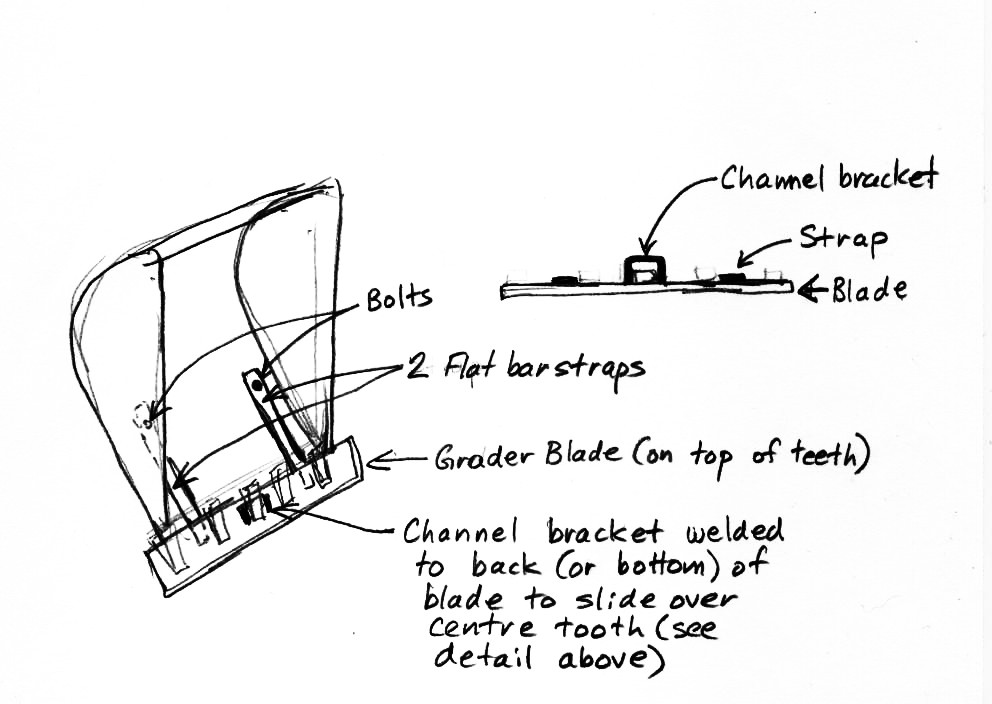

May 31, 2008 / Back Hoe Bucket SCRAPER BLADE prototype #14 R Renze Super Member Joined Oct 24, 2003 Messages 6,231 Location the Steernbos (Holland) Tractor Zetor 3011, Zetor 5718 You can make a steel one, weld some clamps that wedge onto the teeth and bucket lip, and use only 1 bolt to make sure it doesnt slip off.

May 31, 2008 / Back Hoe Bucket SCRAPER BLADE prototype Thread Starter #15 OP L LBrown59 Super Star Member Joined Oct 27, 2004 Messages 16,904 Location First organized permanent settlement in the northw Tractor 2003 Kubota BX1500/2004 Kubota Bx23/2005 Kubota BX1500 Renze said: weld some clamps that wedge onto the teeth and bucket lip, and use only 1 bolt to make sure it doesnt slip off. Click to expand... I like this idea, Thanks

Jun 1, 2008 / Back Hoe Bucket SCRAPER BLADE prototype #17 R Renze Super Member Joined Oct 24, 2003 Messages 6,231 Location the Steernbos (Holland) Tractor Zetor 3011, Zetor 5718 Willl said: Like this. http://www.tractorbynet.com/forums/build-yourself/122571-backhoe-bucket-grader-scraper-blade.html Click to expand... Allmost like that: I would only add two positioning blocks on the outer teeth too to make sure it doesnt swivel and ruin the bolts.

Jun 1, 2008 / Back Hoe Bucket SCRAPER BLADE prototype #18 herringchoker Platinum Member Joined Oct 8, 2004 Messages 810 Location New Brunswick, Canada Tractor Kubota B7800 Here's a sketch of the setup I used for many years when I was digging holes for a living. I used a piece of grader blade. Attachments GraderBlade.jpg 96.5 KB · Views: 543
