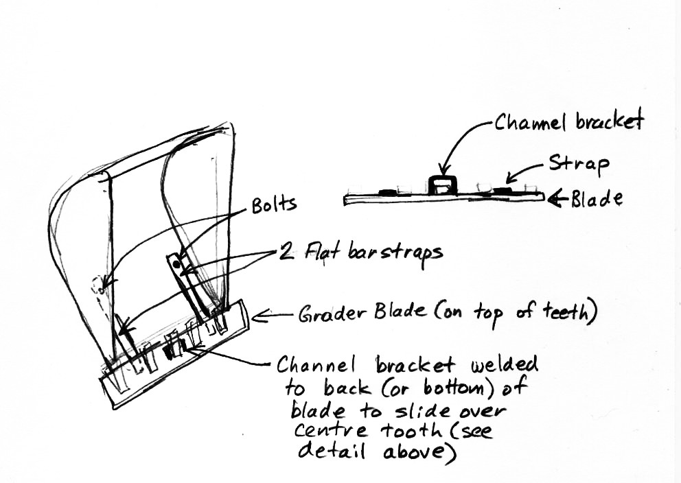

I'm thinking about maybe just taking out 2 or 3 of the bucket teeth bolts and getting a couple or 3 longer bolts and bolting a steel or wood scraper blade on that way.
B T W
Does anybody happen to know what size those bolts are?
Are they Standard or Metric?
/ Back Hoe Bucket SCRAPER BLADE prototype #10
The bolts are 1/2" diameter (Takes a 3/4" wrench).

You can make a steel one, weld some clamps that wedge onto the teeth and bucket lip, and use only 1 bolt to make sure it doesnt slip off.
/ Back Hoe Bucket SCRAPER BLADE prototype #18
Here's a sketch of the setup I used for many years when I was digging holes for a living. I used a piece of grader blade.
