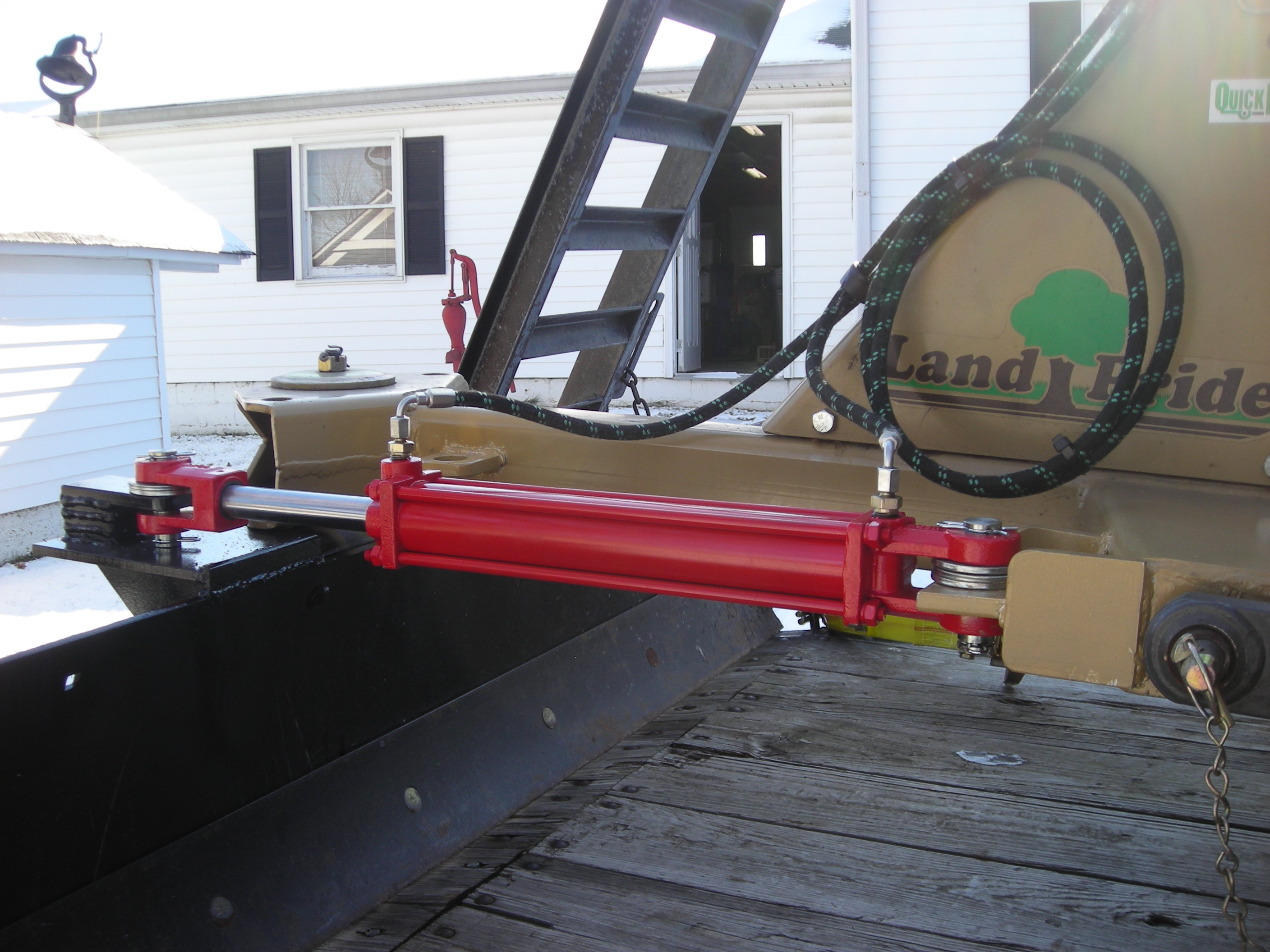

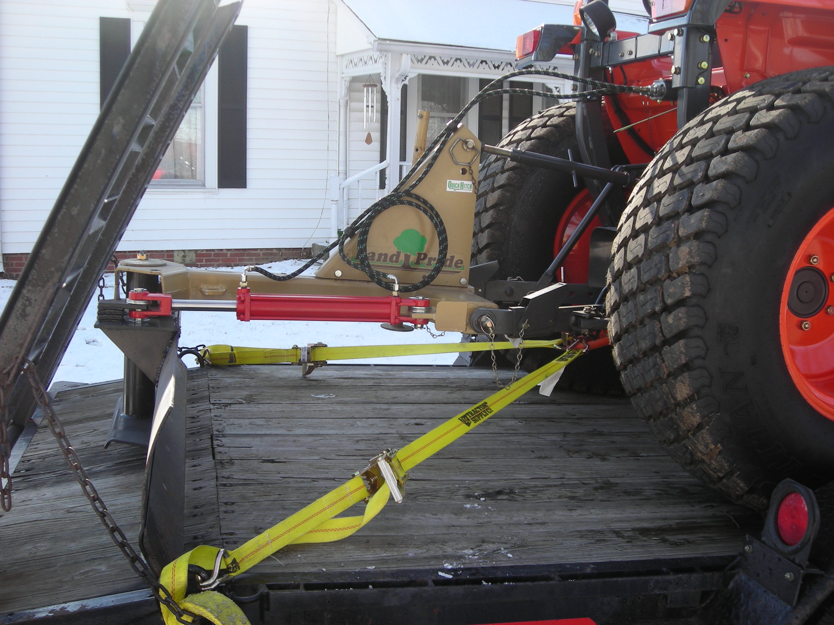

You will be happy with your decision. I have been very satisfied with my RB1584. Let me know if you want to add hydraulic angle and I will send more detailed pics. Philip.

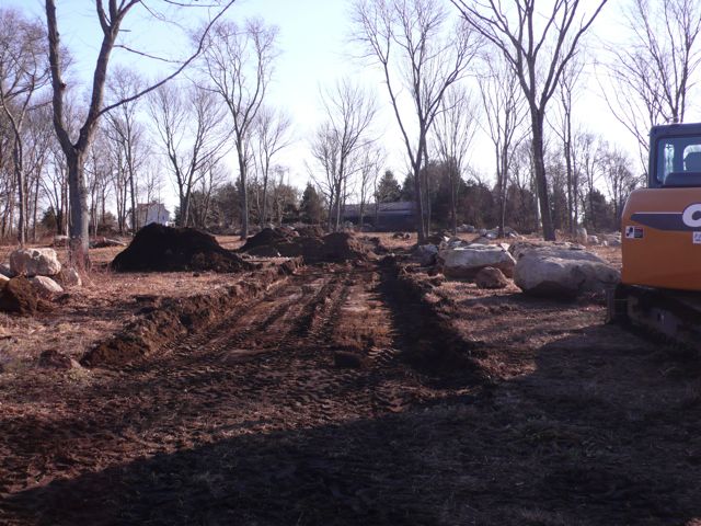

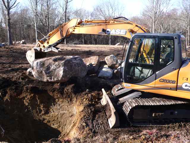

Hi Brian - The landscape rake is as beefy as they come and has been a terrific help in spreading stone and collating limb and vine cuttings from a 1000ft shared driveway. No TnT yet but I've got it figured for taking in off the power beyond. I'll get some pics together when i can get back at it. Everything is snowed in right now. I have a road project that I started just before daily freezing temps followed by heavy snow....very unusual year for us. Here's a couple of pics from that start........Cheers, Gary

Gary, thanks for the update and the pics. Your place sure looks nice. :thumbsup: I'm assuming that the Case is rented?
/ Back Blade - KingKutter vs LandPride #32
Brian - Yep. I have it in my mind to rent it again for a month in Spring/Summer. ....Gary
