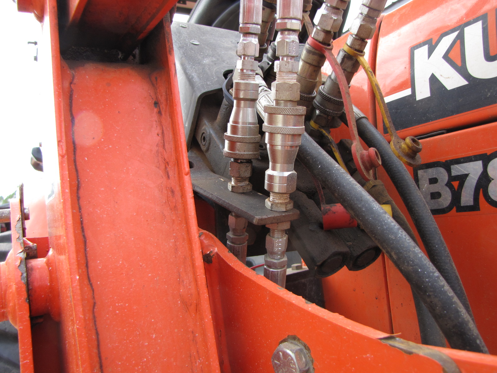

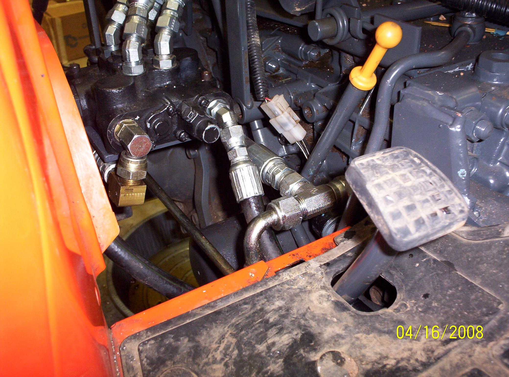

Picture #1 & 2 is the plate for the valve. The valve on there now was changed to a 2 spool late.
The valve is a danvoss ( spelling ? ) with load checks, and with the by fitting. It's has #6 oring ports in and out, also work ports are the same. I would guess it to be a 6 to 8 GPM valve. It's about 4"w X 6"L X 2" high nice little valve. I think the valve is off of JD garden tractor. I got it off of ebay and when I bid on I thought it was 1 spool valve, but when I got it there was a 2 spool valve also. The listing was for 2 valves and didn't read that part, so I got both for $40.00.

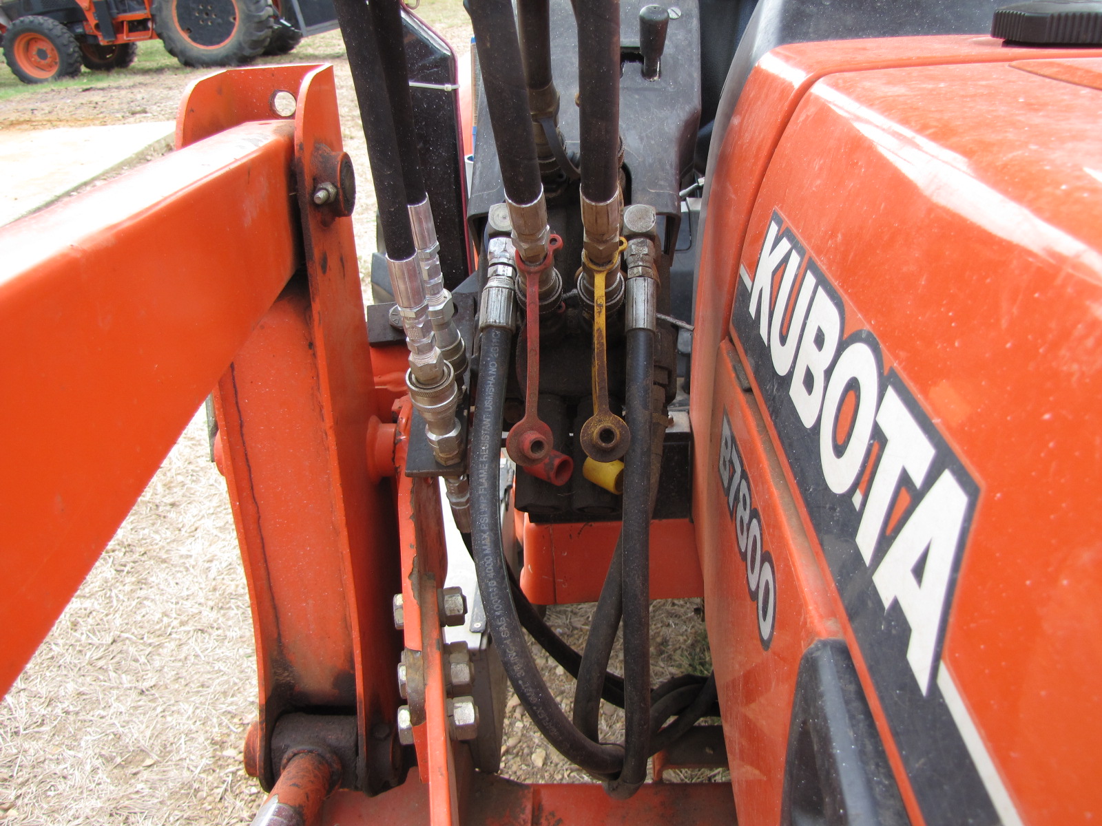

Picture #3 you can see the plate and the Tee for the return.

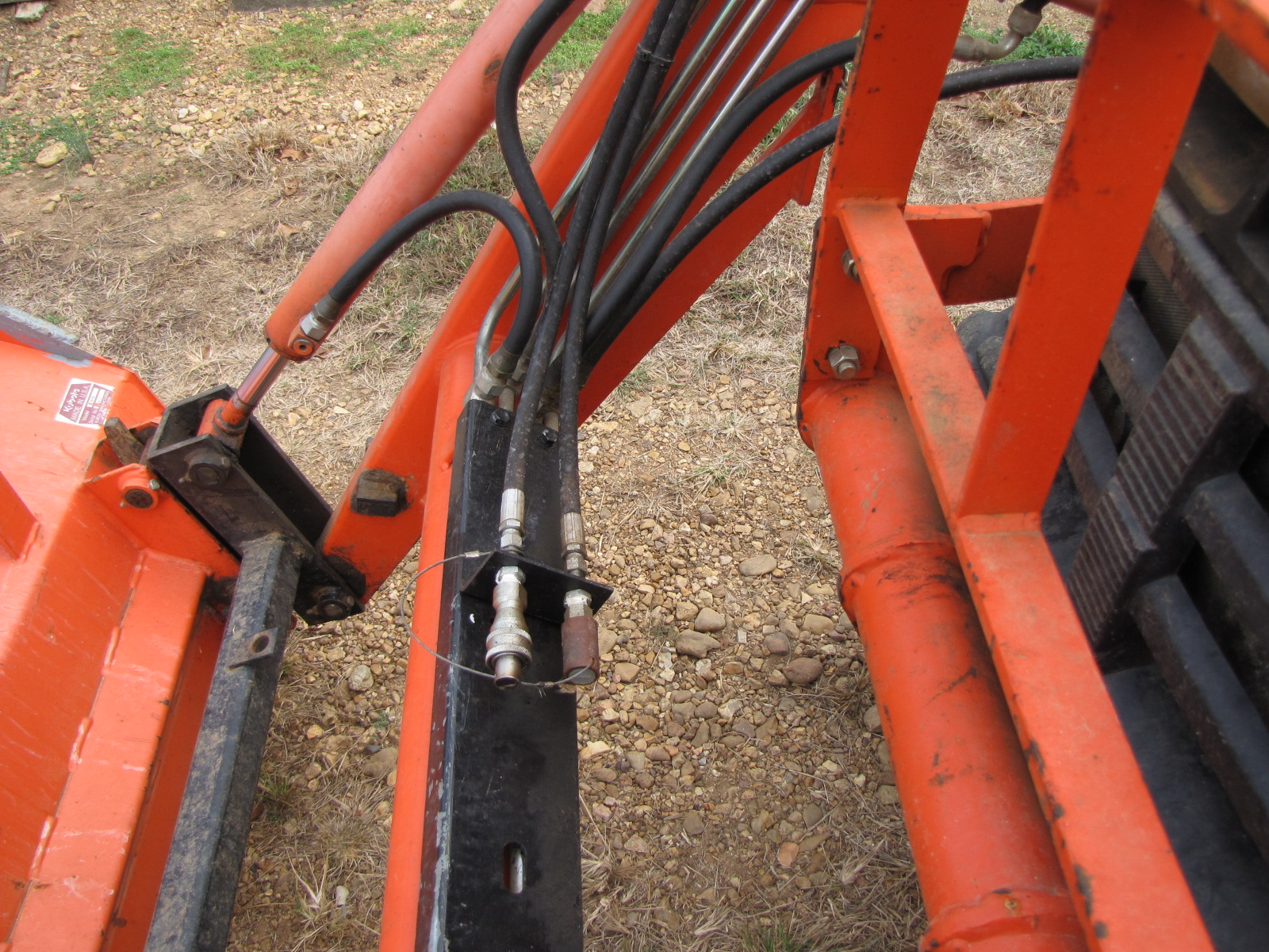

Picture #4 is the rear couplers and you can see the Tees in the other work port lines to run my front remote.

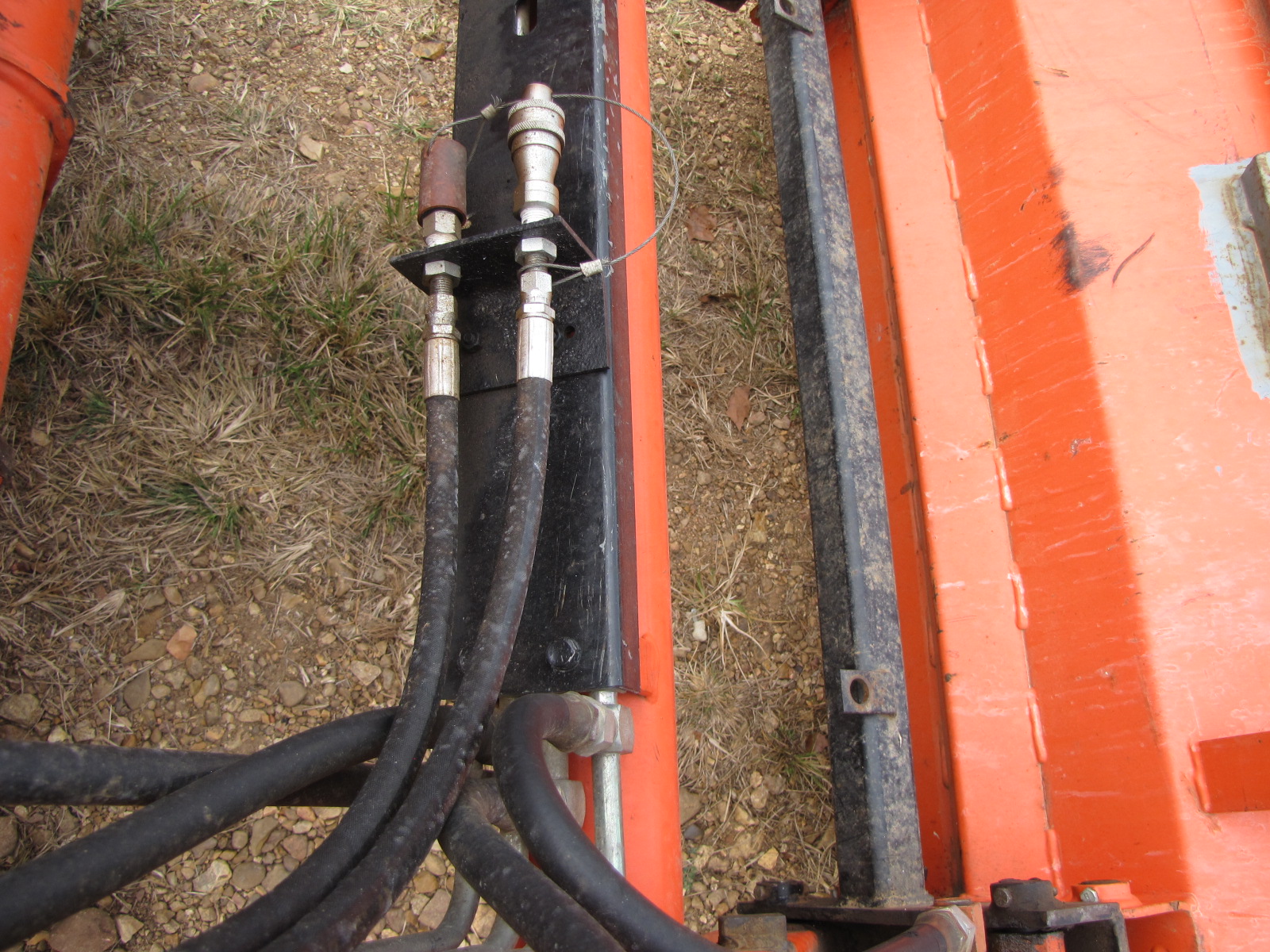

#5 are the handles coming up and that is a peace of bake-a-lite keeping the handles from hitting together.
