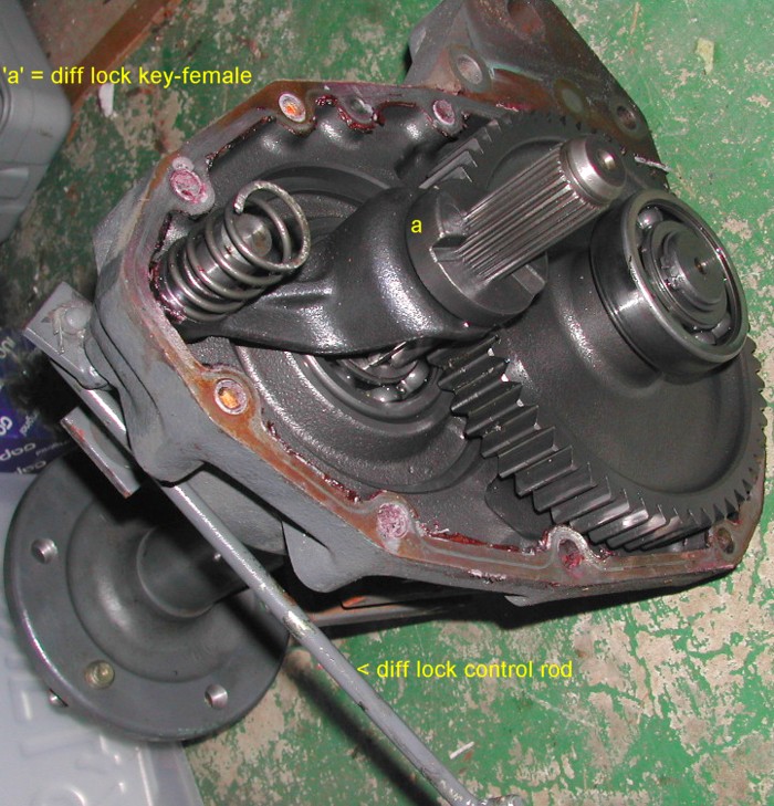

Well, CAPT, I hope you prevail in you warranty dispute. It certainly seems
to be covered.
The diff lock from my B21 looks very similar internally, as does the linkage.
There was virtually no wear detectable in this unit with 2350 hours, but
there is no telling if the previous owner used DL. My JD, on the other hand,
used inferior materials for the diff lock, and it had lots of wear.

Thanks for the picture! its going to come in handy tomorrow when I talk to the service rep. I looked at mine today at the shop, they finished the tear down, I guess they did it assuming it will be covered?? Anyway my shift fork is VERY worn. Its chewed way back in and it looks like its only allowing the locker to engage maybe 1/8th of an inch at the very most. Still need to determine why this happen but again, were making more progress. And now the best news so far, kubota sales department gave me a credit for the troubles I've been having and Pristows made me a super duper deal on a new L3400. So after I talk to the service rep tomorrow and inform him he WILL be fixing my 7800, no more BS, I'll be purchasing me a new l3400.

The warranty rep said they would fix it. It wasnt without a little bit of a fight though, the conversation started off with him attempting to explain to me how the excessive wear on the shift fork was due to misuse or excessive use and that it wasnt allowing the pieces to engage properly. I asked him to pretend for a minute that I knew as much about what we were looking at as he did and asked him to start over. I was an a#@ but I simply wasnt going to hear the misuse thing. I could see there was a problem with the quality of the component and what I wanted to hear was what we were going to do to diagnose the root cause and fix it. We soon got on the same page and it was agreed that they will fix it. From what I gather though is that kubota warranty wont cover it but he has a budget of his own to cover certain things. I think he will expect my dealer to eat some of the bill which I told the rep I felt he shouldnt have too. I consider my warranty a contract, I just think the dealer should be paid as he would by warranty directly. They can work that out, my part of the battle is done. Anyway, the shift fork was worn about half through and where the roll pin pushes it it was worn as well. I dont know if worn is the right word for the pin area though, it was more like the metal was just pushed away in a pile. It was obviously soft, maybe didnt get heat treat or something??? I'm sure the vast majority are better quality. The collar part of the locker that the fork shifted had shown no wear but it was cracked where it was only engaging a tiny bit. I'm so glad to be done with this. I did the shopping, looked at deeres and others but I still think kubota is the better tractor and mine was a rare problem. So I own a new l3400 now, kubota sales gave me a credit and the dealer made me a real good deal on the L3400 or I would own a different tractor right now simply to get away from kubotas warranty department. I dont know how well the 3400 will be suited to my uses, its kinda bigger than I need since I have a wheel loader I use for heavy work but I'm hoping for years of service. I hope Kubota can get on the right track with warranty stuff, even though I think most of us wont need it, its import to know you can count on it when you do. Boo warranty for being D-bags, yeaaaaa sales and good dealer for keeping a customer!
