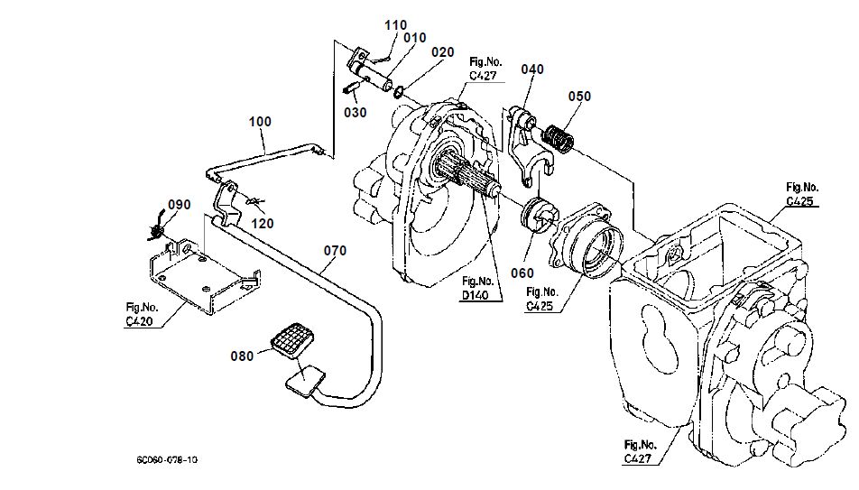

I looked at my shop manual last night and there really aren't any adjustments on how the locker engages. The only thing that could affect its engagement would be a bent foot pedal or engagement fork.
The way it work is there is circular plate on the carrier that is pretty thick with a big notch (about 3/8 of the circle.) On the right hand axle shaft there is another plate with the matching tooth that locks into the cut out when slid into place by the engagement fork. When they lock together it locks the right hand axle shaft to the carrier, which therefore locks the right hand side gear and spider gears which makes the other side turn. Its nothing like any of the automotive based lockers I've seen before, but it does look pretty stout, especially since its upstream of the final gear reduction. If you don't mind post up some pics of the failed parts when you get them, I would be interested to see exactly how they failed.

Thanks for the input. I looked at the linkage and had seen there was no adjustment. Its kind of a poor design IMO and I can see from looking at it that the linkage is at least part of the reason its hard to press compared to the older b2150. Once its fixed and the warranty is out I'll definatly upgrade the linkage to at least have some sort of bushings where it piviots. I'll put a little leverage on it too to make it easier to operate.
You wouldnt have an exploded view of the locker by chance would you? If not, no biggie dont go out of your way because I'll just pester my dealer to get me one. Where is there a gear reduction past it, if there is a gear reduction after the locker it should in theory be pretty strong under torque. I think the L series looks like it has the reduction after the locker but looking at mine together I cant see any obvious place where there would be one.
My pedal isnt bent, it has plenty of room to travel but the fork I cant comment on yet. Again, thanks.

1. You wouldnt have an exploded view of the locker by chance would you?
2. Where is there a gear reduction past it, if there is a gear reduction after the locker it should in theory be pretty strong under torque.
1.You can get a pdf parts manual for your tractor at :
TractorSmart.com is your online source for Kubota online parts.
I have one for the B7800, but being a computer dummy, I can't figure how to pull out specific pages for you. If you get a pdf file, the exploded view of the locker is in the REAR DIFFERENTIAL and DIFFERENTIAL LOCK PEDAL sections. It's pretty much as Verticaltrx describes.
2. The REAR AXLE section shows the gear reduction outboard of the differential case.
Hope this helps.

I looked at the other B tractors on the lot at the dealer when I droped mine off today. They had b3030's, 3200's, 29xx, 7510, etc. All the tractors there had a very different linkage and a MUCH better feel to the locker. I'll get some pictures of my linkage, its a pretty crappy set up compared to the others I looked at. I would assume this is a b7800 thing or is it possibly a model year difference? If I would of actually seen this (its hidden pretty good) before I bought I would of went with a different tractor. Its like something you would expect on a lawn tractor from the walmart. I hope theres an upgrade by now. There was a 7510 there sitting outside with the rear torn apart. The diff was covered with plastic and I assume it to have been a customers so I didnt mess with it but I really wanted to get a look at its guts.
/ b7800 locker problems #17
PM sent to you. I can send you a parts manual in PDF or click here (below on the thumbnail picture).

Thanks crbr. I'll save you the time on the manual, the pic you posted gives me a good idea what I need to look at. I do appreciate the offer though, I just hate to take up anyones extra time on this. I Imagine it would take a little effort for you to attach and send it and the pic gives me a good idea of what I'm looking at. The locker itself should be self explanatory when I see it. Again thanks for the offer, mighty fine of ya.
