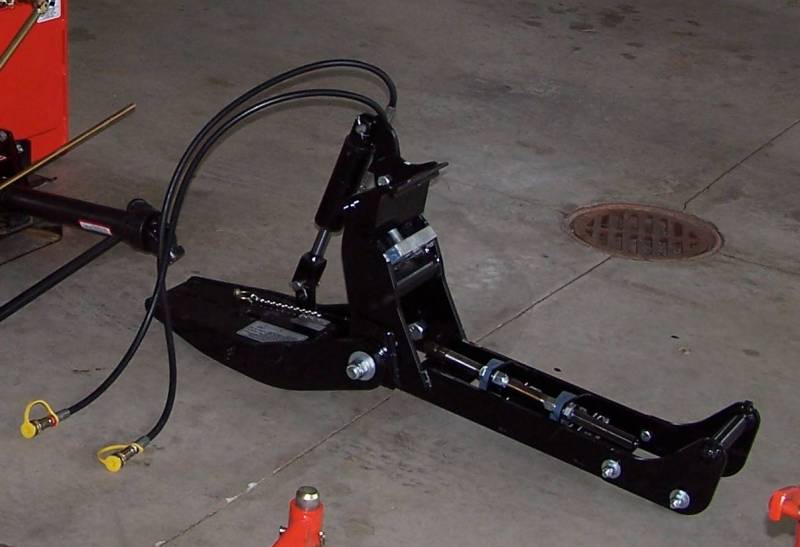

<font color="blue"> </font> Killer_B <font color="blue"> </font> : Do you have to remove the front hanger bracket for your MMM to be able to install the "quick hitch" subframe? If so, how long does that take? Is your MMM the RCK60-24B?
   / B7610 and B2765 A Front Blade
#22
Hi Rusty,
No, you do not have to remove anything other than the deck itself. All the other MMM related stuff stays put. My deck is a 60 incher. I can't recall the model name and number.
When I first got the quick hitch, the only implement I had that used it was the snow blower. I decided to time myself just to see how long it took to hook everything up. With the tractor "naked" it took 6.5 minutes to hook up everything, including the quick hitch, the drive shaft that goes to it, the hoses, the chute crank and the blower itself. I did not rush anything, but worked steadily. The blade probably hooks up even quicker since there is no drive shaft or chute crank to mess with.
Attached is a photo of all that is needed to make the blower work. It really is a snap. The only thing that is even slightly strenuous is moving the quick hitch around the garage. It’s a real chunk.

Here is a close up of the QH itself.

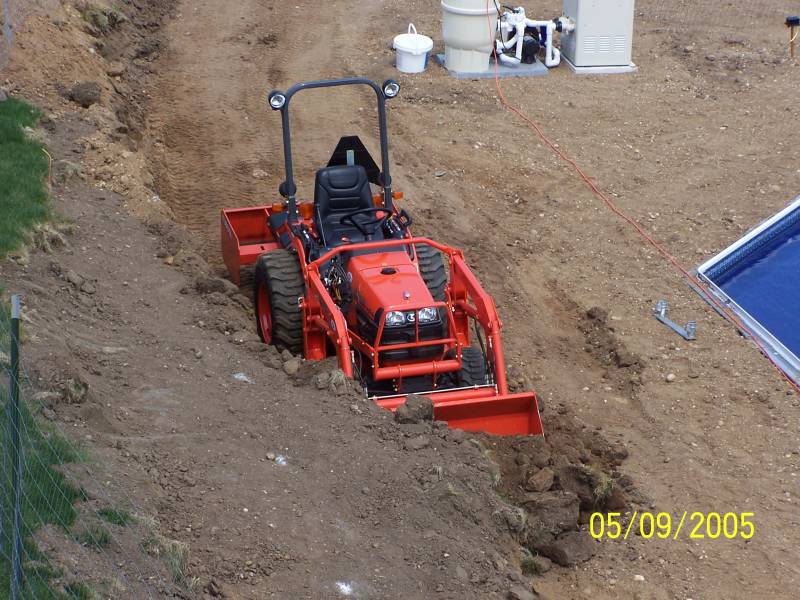

Junkman,
I find myself entirely unable to level loose soil with the blade while moving forward. It just wants to dig right in, which makeds a nasty rut. In reverse it works much better.
What is the trick to making it work while moving forward? It can't be all in the wrist.

Yea, I had it off the driveway once. But the tires got dirty so I put an end to that. But I did take the attached picture first. If you look real close you can even see a speck of dirt on the hood.

Keep it up and don't allow it to go into float. Back blade until it is closer to level. I have never liked using a blade for leveling on a tractor, for all the reasons that you have experienced. A dozer is the tool of choice for ground leveling. It has enough weight to compact the ground that you are working and enough weight to move the earth that you need to move. A good bulldozer operator is worth his weight in gold. It is something that you have to develop a knack for doing and that takes time. Some never develop the talent required. The more that you do, the better you will become at it.
