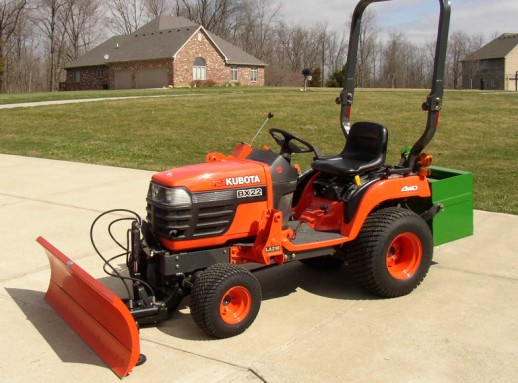

BX2763, it's a 60 inch blade with the replaceable/reversible blade point, trip springs and skid shoes.
I can't help much as far as how much it will actually handle as I have had it two years this October and We have yet to have a snow over 3 or 4 inches , I never even used it last winter as We hardly had any snow at all.
This pic isn't too clear as it was taken with a disposable camera. /forums/images/graemlins/grin.gif /forums/images/graemlins/grin.gif /forums/images/graemlins/grin.gif
My wife says it was a waste of Money!!!!!!!! /forums/images/graemlins/grin.gif /forums/images/graemlins/grin.gif /forums/images/graemlins/grin.gif

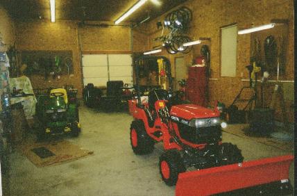

Here is another pic that was taken of RLW'S , his is the same as mine and a better pic as well. /forums/images/graemlins/grin.gif

Thanks for the pics, Tom.
Your shop looks cavernous. We should all have such a fitting home for our schtuff.
