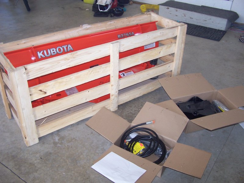

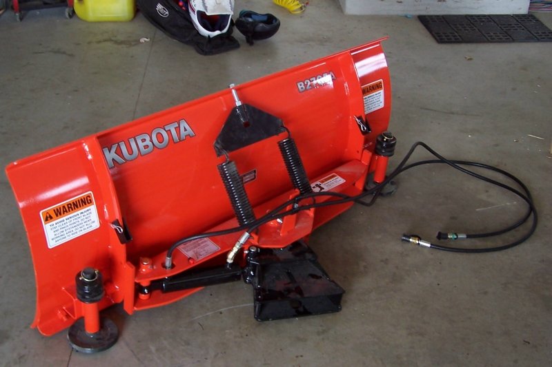

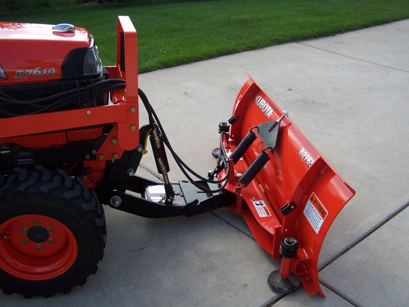

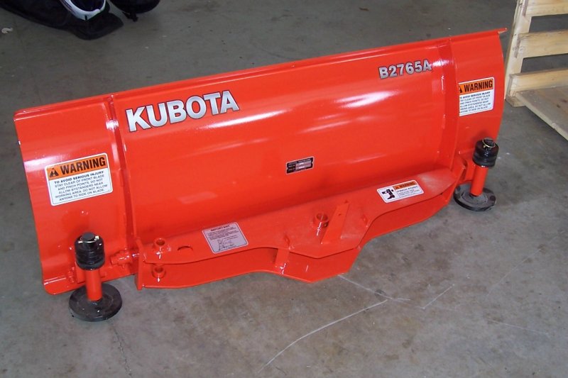

I recently purchased a B2765A front blade for my B7610. It痴 a 60 incher with power angle. I already have the quick hitch and front loader with the proper valve. Thus, all I needed was the B2765A. It cost me $1,400.00 out the door. Photo of the crate is attached.
What is the appropriate sub-frame for a B7610?
