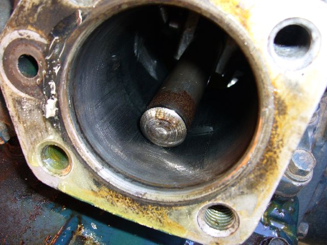

FYI...just replaced mine last weekend and followed the instructions on the link above.
However, I didn稚 have a magnet strong enough to pull the piston out. I was able to remedy this situation by the following:
I disconnected the stoppers (I don稚 know the correct name), but they stop the 3PT hitch from going up or down to far. Now I was able to raise and lower the 3PT hitch by hand to the max. I raised it all the way so the piston was at the top. I then slowly lower the 3PT hitch so the piston stayed near the top. You can稚 see this, but the rod then drops down (see pic) and when I raised it back up the rod pushes the piston out into my hand.
I know it sounds confusing, but I was able to complete the whole process in 2 hours without any technical skills :D

I just replaced the 3pt lift piston o'rings on my B7100 and the drooping lift is gone. Used IL4now's method of getting at the piston as I didn't have a magnet either.
Want to thank charlz for a brilliant post and excellent pictures.
I sourced the O'rings through a local seal specialist. Total cost was AU$ 3.65, and a skinned knuckle, which sure beats the hundred of so quoted.
