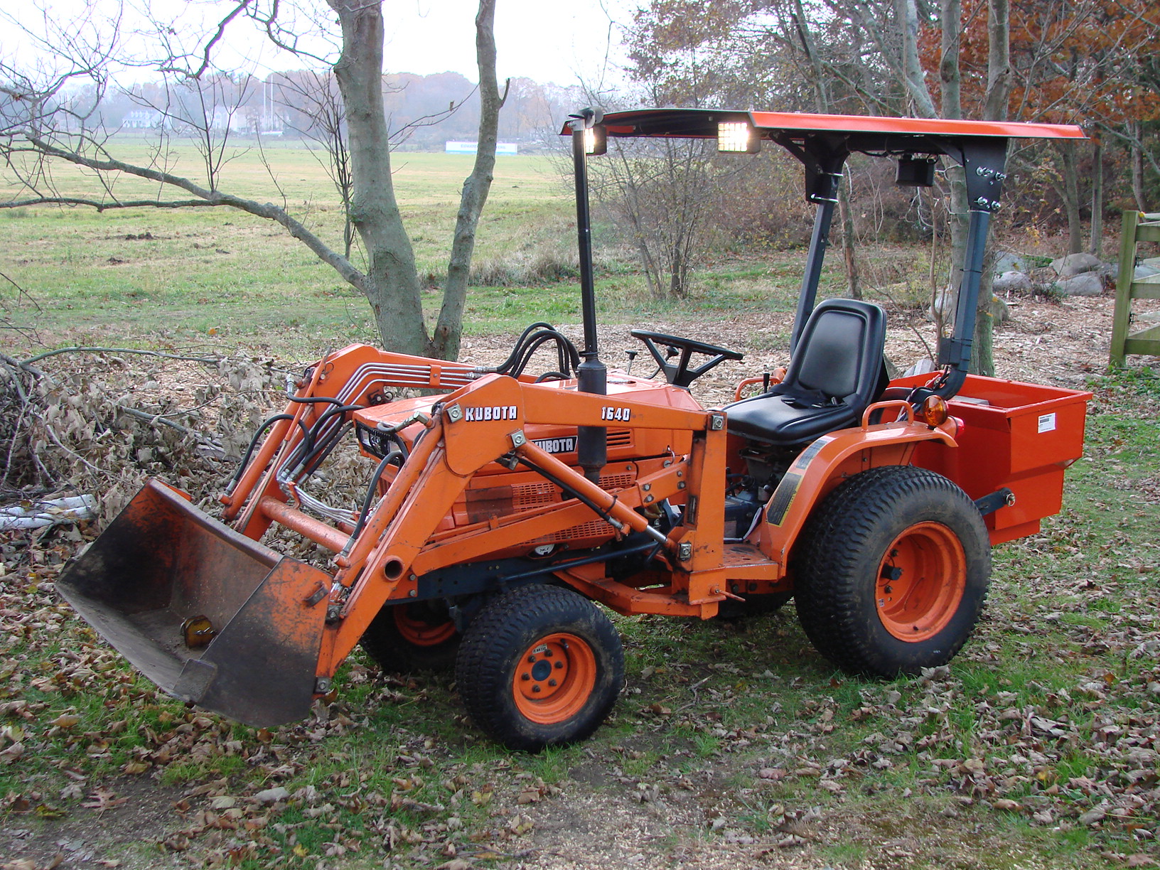

I found the turbo on E-bay. I did a little research and found that there are only a couple of turbo's that meet the requirments of this small displacement engine. I think im right about .74 liter. the garrett gt12 is a match and the kkk kp31 off of the euorpean turbo diesel smart car. I chose the KP31. There is a bit of machining and welding that has to be done to get it to mount to the manifold. it probably will take a better part of 10 hrs. to do all the machining, welding and placing. Then replumbing all the air and oil. But i think it's worth it. Ill attach some pic's of my little Satoh S370D that I turbo'd Then you will get a little better Idea of what all goes into it. I had to build a header on it. The Kubota I will be able to mount right to the manifold.

Waaaahooooooo. The turbo's here. Now the fun begin's Started doing mods tonight. Building flanges tomorrow. This will probably all fit under the hood too. Most excelent.

This is my first Bota also. I try to find used tractors that need TLC then fix them up and sell them. But this little tractor is in great shape. So I think I will keep this one. I have a full plate right now. My water jet cut parts for my backhoe got deliverd today. So Im going to be working around 3 different projects at once here. Pic's come as I remember. So please bare with me. Most people really dont need a turbo. And I really don't need the turbo. Butttt!!!!! (evil grin) Diesel's with turbo's are soooo cool. And this little 13 hp 3 cyl. is just ripe for getting pumped. Plus I can say... Hay look under the hood of my bota. Bet you never seen that on a little tractor befor. With 6 psi of boost from the turbo I should be able to make right around 22 hp. and a bit more torque. This perticular turbo is made for an 800 cc 3cyl turbo diesel in a smart car. It produces about 65 hp. but spinning alot more RPM. I'm around 720 cc's and 3 cylinder's. I dont think I can push more that 8 psi. and really dont want to go that high anyway. Ya start breaking stuff, and you have to start adding inner coolers and blow off valves. That takes all the fun out of it. I will keep you all posted as I go along. Im just in the design phase right now. So it could be a week or so before anything really starts to happen.

Wow you really have to keep on your toes in this group. You loose your spot in the posts if you dont keep writing. Pic's are still on the way. just finished up a scraper blade for the tractor. I know... I could have just bought one. But why, when I can build one that better and stronger. So Im ready for the snow again. The tractor projects will be somewhat on hold for a week whild I get my boy's snowmobile finished. The things we do to keep our kids happy... As for the tractor. I have finished up drawings for flanges in Solidworks (3D cad program) I've started machining the turbine housing for the retrofit to the flange mounts. The one thing I don't like about this turbo is that the turbine housing is none turnable. So your kind of stuck as to two positions that I can mount it. (facing forward or backwards). If I wasn't so cheap I would plunk down 800 bucks on HT12 turbo then I wouldn't have to weld any flanges and I could mount it any number a ways. But for now the muffler will be removed and the manifold capped. I will machine in an opening just above and infront of the existing opening. then weld in the flange to mount the turbo to. Then I will start the plumbing. I will T- off of the oil pressure switch to provide oil to the turbo. The turbo will be sitting high enough in the hood that I will be able to return the oil through the valve cover. I think???? Then I can start the ducting to the intake and air filters. I will try and plumb the exhaust back out and near the existing side cover hole in the cowling. It should look factory when I get it finished. Hopefully it will preform much better than factory.

Hey... Anyone need snow. I got some if you need some. Spent 7 hrs this morning cleaning driveways. This little tractor has more balls than my ford or Satoh. And is only 13 hp. Whats up with that. Were can I pick up a small snowblower for this thing. I need like a 42 to 46 inch wide one. Any Idea's?
The trubo project is still movine ahead. I got my flanges from the machine shop and have milled the turbo housing to that I can weld the turbo to the flanges. Im having trouble figureing out were to run the exhaust once it's been through the turbo. There's just not alot of room under that hood. I might have to put the turbo out side. That wouldnt look to cool. But I might not have a choice. Ill have to get a used side panel and do some fab work to cover the turbo up. Anyone know were I can find a used left side panel? Well enough for now.

Well the last one I did, I didn't bump the fuel up at all. But it really cleaned up the exhaust on that one. This little three cylinder runs pretty clean so I'll probably have to run the fuel up a little bit more. I would hate to burn down a set a valves or a piston. But untill I get it installed and can put an EGT on it I wont know. Ill take any advise anyone has to give though.

I could have run the Satoh with out a muffler, It was pretty quiet. This little three cylider is pretty quiet the way it is too. **** I dont really even need the extra power.. This tractor is a stud just the way it is. But the turbo makes me hot... The problem with these small turbos is that you loose the whine of the turbine once you get past half throttle. There spinning so fast that the sound cant keep up with it.
