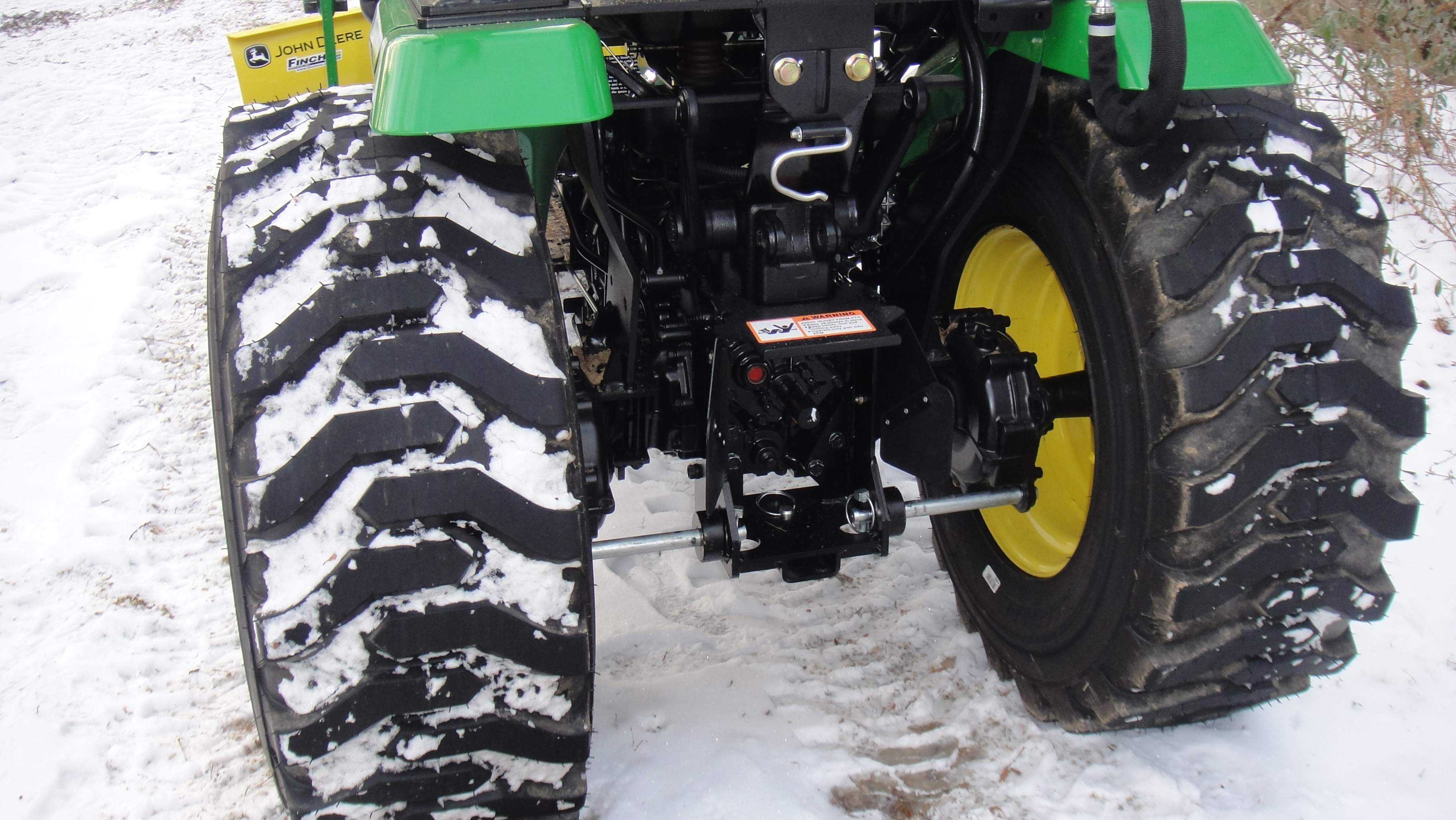

The axle setup is a little unusual but very strong. I am only aware of one post where a guy broke it and the general consensus was abuse. I believe he had the old style 3PH arms, narrow tires and a loose implement that drove the arms into the tires. Classic immovable object and unstoppable force.

For those of you who are not familiar with 2520 and 2720 rear end axle set up here is a picture. Instead of an axle coming out of the transmission the axle is attached to an external housing with a reduction gear.
