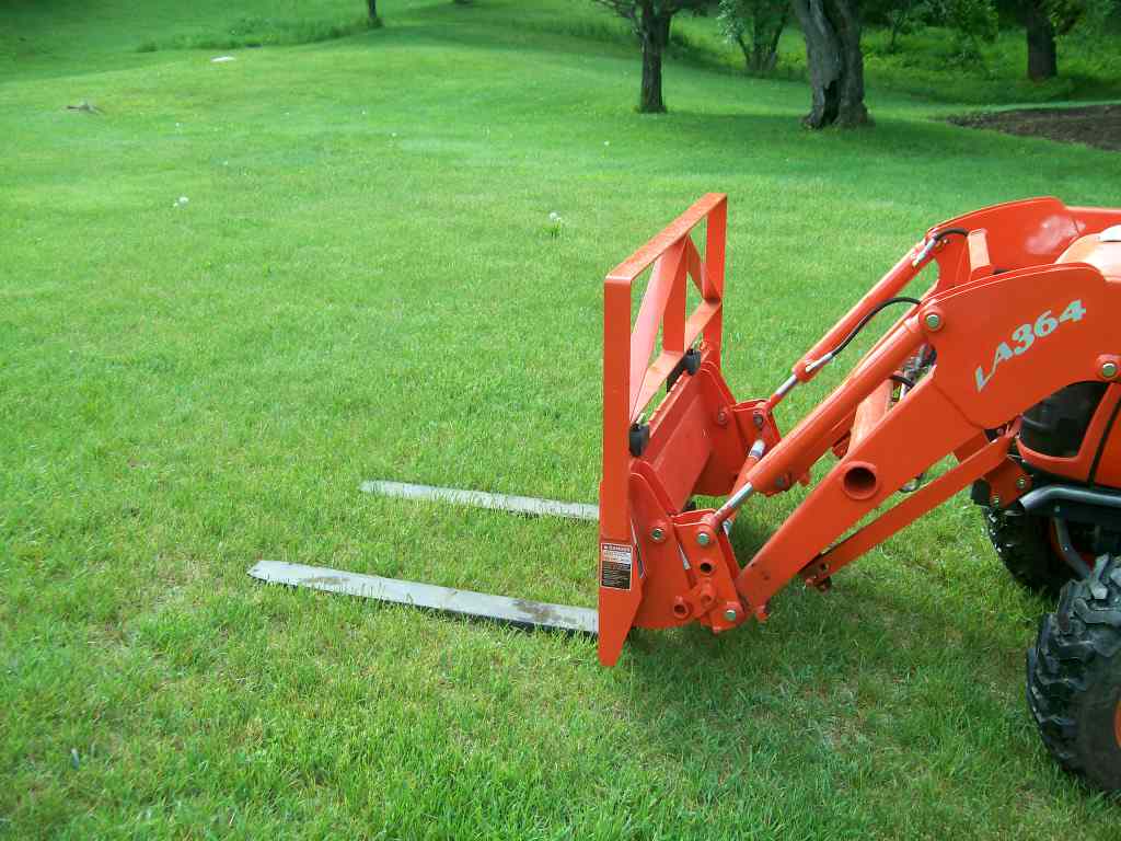

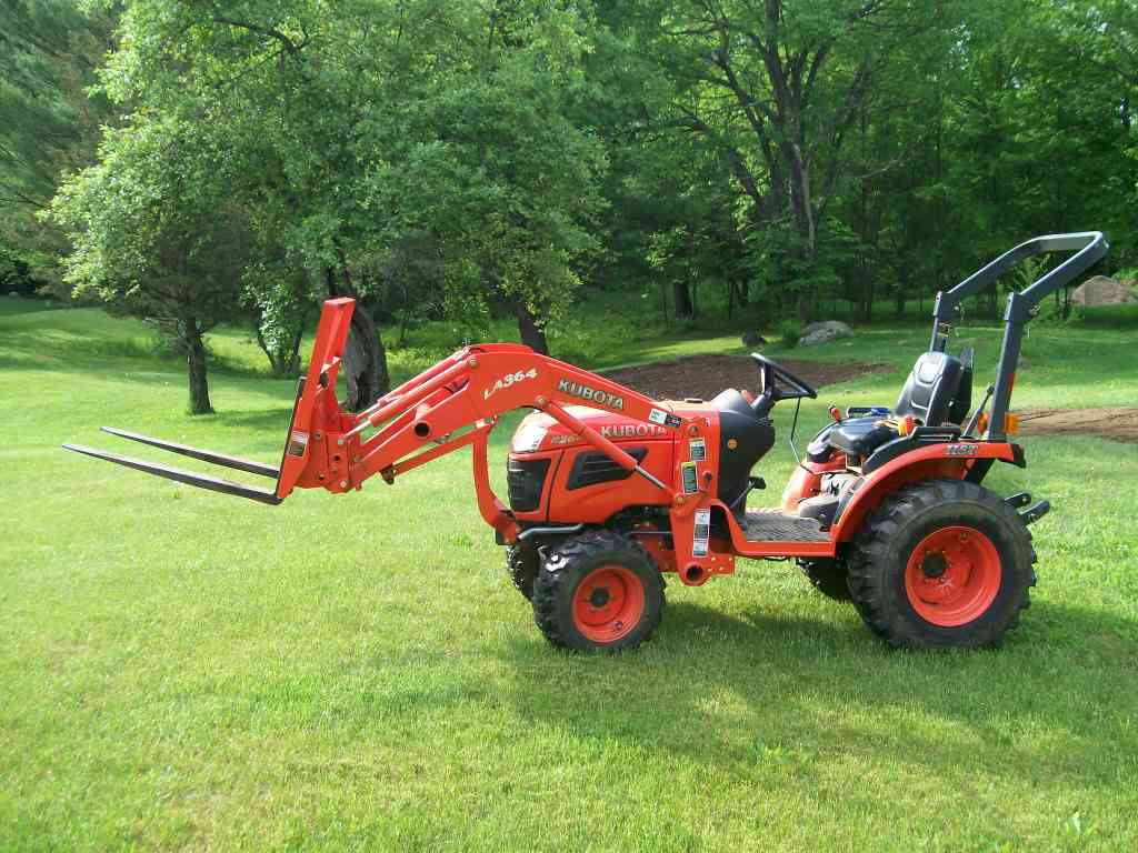

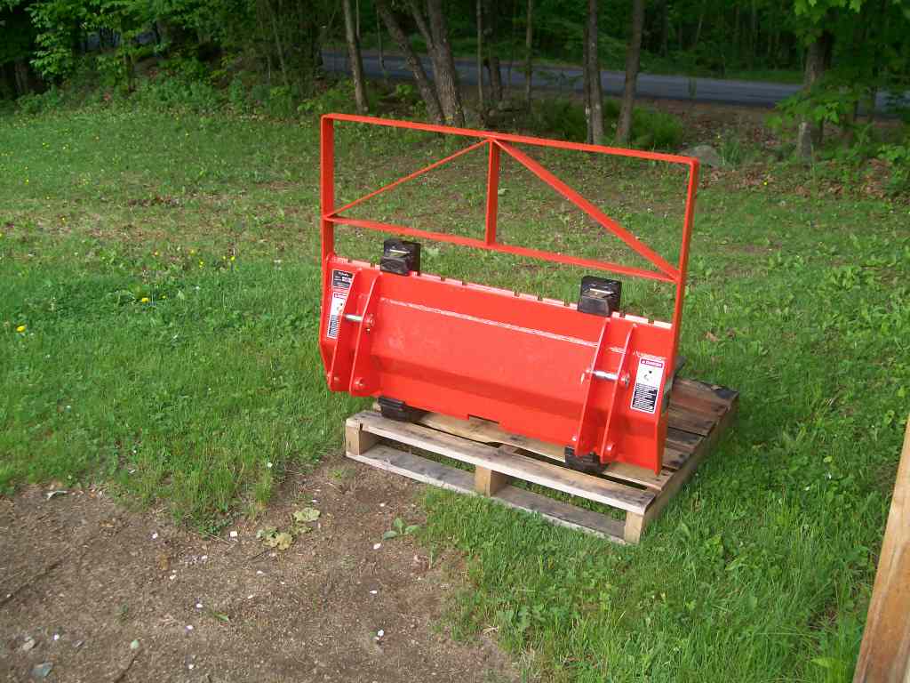

For those that might be interested, I did purchase the B3200 loader QA, and install it on my B2620 with no problems. I bought the Kubota forks, and everything fits, and functions fine. The forks seem to be a very good size for the tractor though having the BB on back besides the loaded tires is a good plan. I moved a couple of logs, a couple of big stumps, and some brush with the forks just to try them out, and it sure was easier than trying to do that stuff with the loader bucket.

I'd be curious to see what the forks look like if you could post a couple pics.

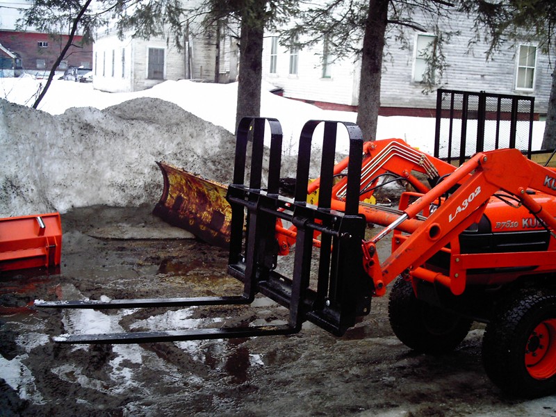

What did you come up with for measurments on the quick hitch? I am going to the dealer to try out a new b3200 with quick hitch on Wed and would like to bring my pallet forks with me to see how well the tractor lifts stuff. Mine are set up for a 7510 now but are adjustable. The forks are made by horst mfg. The 7510 uses 3/4" pins and I am asuming the 3200 will be 7/8"

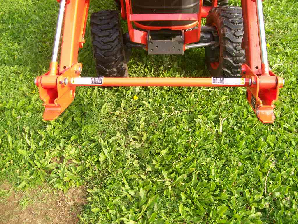

Rob, the pins are 1" dia. (or maybe 25mm) they are 7" apart, and the distance between the arms is about 31 7/8".

Stu, The forks were $940, and the QA was $270 though you probably can do better where you are.

Here ya go:
They seem to be a really nice size for the B series tractors. I was surprised that I could lift a couple of stumps that I had been unable to lift with the loader. Even though the QA moves the pivot points ahead, you can get the weight back much closer to those points with the forks when it is something bulky like a root ball, or long like the old logs I moved. I'm glad I got the BB at the same time since that extra ballast is needed.

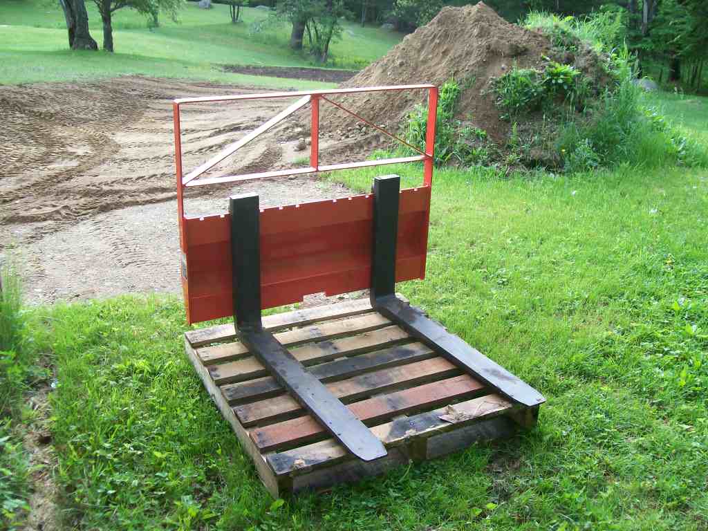

I really like those forks. The assembly looks pretty light, compared to most. Some of the lighter forks I've seen have the tines made out of channel (which I wouldn't be interested in). I certainly don't have any need for 4000# forks on a tractor that lifts 1000#. Thanks for the pics !:)

Ductape, Yes, I was struck by the nice size when I saw these on the dealer's porch when I went to get some parts for my Simplicity. They are somewhat smaller than the common ones I've seen, and are still very rugged. That trip for my $5.00 part sure cost a little extra, but I do really like the forks so far.

My 7510 is 7" as well can't remember the width. I am glad to here the pins are so big.
What is the length of the forks you have? mine are 42" and am glad they are.

Hmm, can't tell you how long the forks are. I think they are over 36" so 42" might be about what these are. I doubt that they are longer than that. Raining here now, and it's time for some lunch, I'll check later sometime.
Edit: I did check Kubota's web site, and they say the forks are 36".

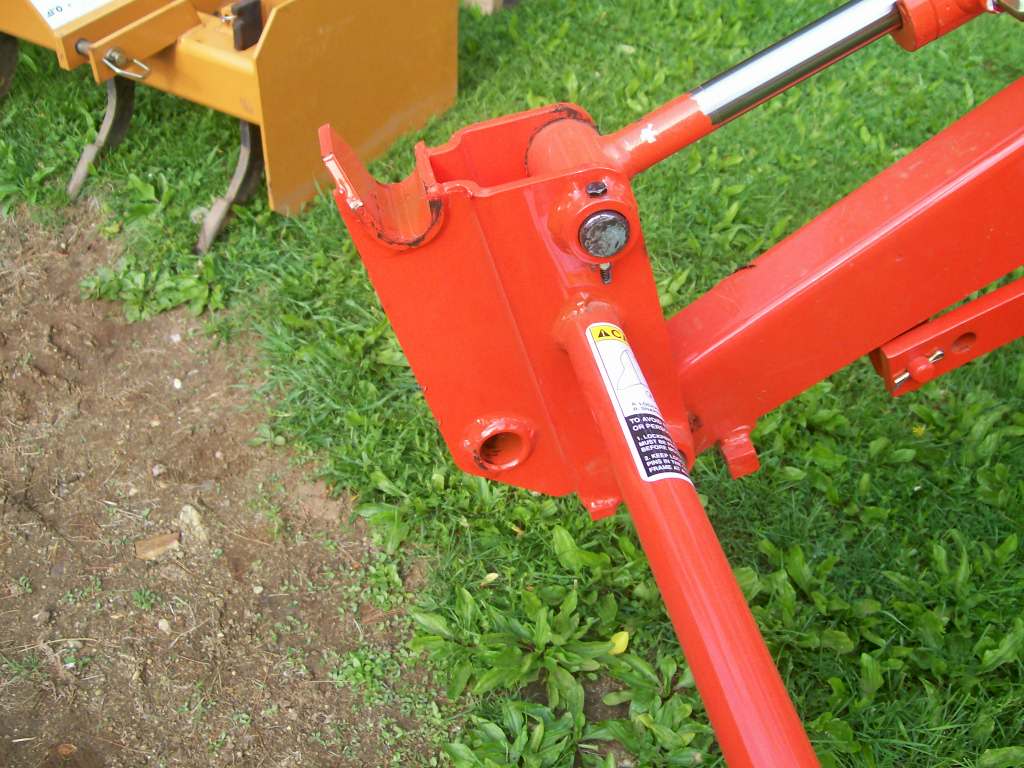

Did I miss seeing them or are there no grease zerks on the pins holding the QA bracket to the laoader arms/cylinders? :p

Yes, strangely, there are no grease zerks in the pins that come with the QA for where it mounts to the loader arms. You do end up with a couple of extra pins from your existing bucket though, and I think I will install those, and perhaps get a couple more.

:D :D Hmm, My son was visiting while we installed the QA, and it didn't occur to me that we needed to move the pins without the grease zerks to the bucket / forks side of the QA. We just installed them the way they came. There is no pivoting going on between the QA, and the attachment........ DUH :confused:

I'm thinking about this setup for my b2620. Pardon my stupidity but how does this QA work - you drive up, hook the top pins then manually insert bottom pins? I have just used the QA on my friends L35 with the levers. Also does moving the pivot point ahead have much effect on how much weight the bucket can pick up?
