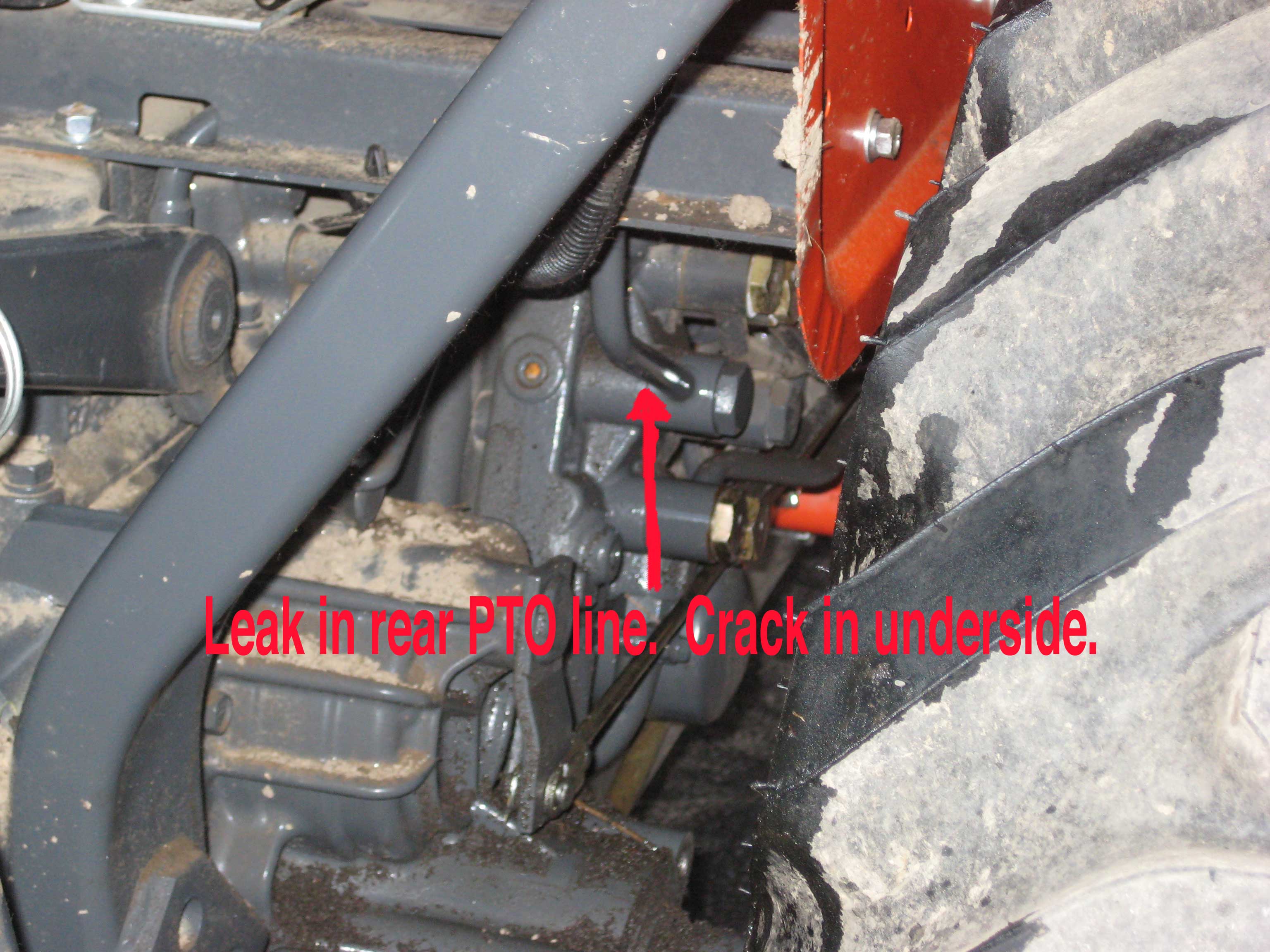

I've been using my tiller the last few days. All was going fine. This afternoon I was running threw some dirt and a bunch of it kicked way up. It was sort of weird. I got off my seat and I see fluid spraying against the rear inside tire :(. My jaw dropped....only 20 hours and not even a month old yet. I didn't hit or run over anything that would have protruded up into the bottom of the tractor. I felt the fluid and it definitely seems like transmission fluid. I cannot pinpoint the leak, but it's underneath near the rear sort of by the filter. It's looks like all the hose are on, but I just cannot tell. I hope this is not an omen of things to come with this tractor. I've got a bunch of work to do and now I'm stuck.

For one reason, or another, my garden tractor has one filter that will sometimes loosen even if it is installed carefully, and properly. Before you go any further reach in there with your hand, and make sure the filters are at least as snug as you can get them by hand..........

Thanks, I just checked it and it seems like it's snug.

Well, my neighbor came over and helped me diagnose the problem. It seems that I have a crack in my rear PTO line. Maybe a bad braze to the connector portion? I've been using my rear PTO a lot with the tiller work I've been doing, but this should not happen. When I tried to lift the tiller, it lifts, but oil shoots out of the crack in the line.

My dealer is good and that's why I bought from him. I've been told that this is somewhat a "known" situation for this model. Maybe a bad batch of hydraulic lines. They picked mine up today and told me he will fix it so it will never happen again. I think he's putting on some sort of custom line.

So you have a hydraulic drive tiller-thats the issue, you have pin hole leak in one of the the rear remote steel lines.The pressure lines should be deigned for at least three thousand PSI shock loads in any case. if the leak is at a bend the piping was not bent properly with bend forming equipment used to bend hydraulic lines made of the proper steel-No, normal pipe bending equipment does not work properly nor is it designed to bend steel line made for hydraulic fluid pipelines.
If the lines are not secured using steel line brackets with rubber cusion mounts for the pipe thats a NO NO.

Just had some pictures sent to our dealership today- rear hydraulic line had a pinhole right by the banjo fitting, spraying oil everywhere. This line runs from the loader valve to the hitch. Ordered a new one- same tractor, B3200
