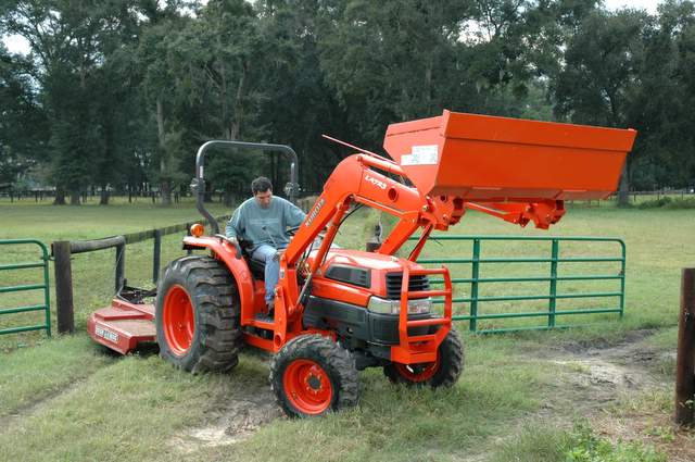

Well here is a pic of the new toy, thats me trying to figure out what I'm doing. Manuverability is amazing. now I'm trying to figure out how to use the box blade. I've posted some questions elsewhere on this site.
GL3830HST
LA 723 FEL
Bushhog model 286 72" rotary cutter
Bushhog SBX720 Box blade.
Thanks again to all.
Ernie
