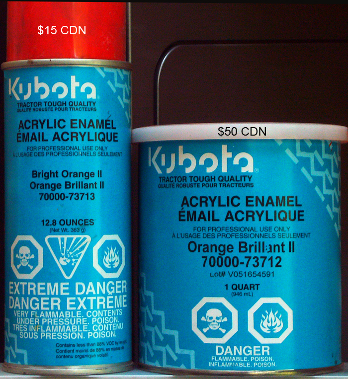

The paint is Kubota 1 qt acrylic enamel p# 70000-73712 ($50) from Island Tractor in Duncan. I had a local body shop spray the new 4N1 (disassembled) after I welded on the chain hooks. There were only a few ounces of paint left in the can.

For smaller projects, you can also try spray cans of Dupli-Color Engine Enamel, DE1620 Chevrolet Orange. I tried it on a small spot on my tractor, and it matched perfectly. It can be found at auto parts stores for at least half the price of the Kubota orange spray cans. I also used Rust-Oleum 7784 Charcoal Gray on my light brackets that I mounted to the ROPS.
I have a can of each of the Kubota orange and grey on hand just in case. I have a landscape rake that I need to repaint because it is painted Case red, so the Dupli-Color will be perfect for that. I hear the Kubota paint is very high quality, but it's too expensive to use on certain implements, so the cheaper paints should work fine for those.

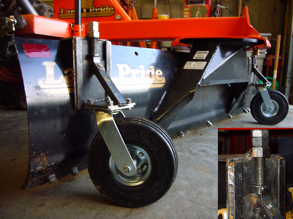

I just realized that I have neglected to post my results from this thread :eek:.
I purchased the Land Pride 2572 rear blade last winter and only got to use it once albeit with great success. Twice already this winter and it still works like a hot **** :thumbsup:.
I have "top and tilt" hydraulics on my 3 point with full float on the tilt. When I'm plowing I adjust the setup below using the top cylinder for gravel clearance of about 1" and lower the 3 point position control all the way to float and the tilt cylinder to float as well.

I am looking to add wheels to my blade. I have a set on my rake so I just need to add the mounts to the back of the blade. I bought skid shoes but they still tear up the ground. Maybe this will instill some urgency in my project!! Or, maybe not!!

In response to a PM that is worth sharing: "Saw your comment about wheels on a blade for snow removal. Where would I look to purchase something like that? I have a Land Pride RB15 blade."
Reply: "You'll have to make your own mounting bracket as I did but much simpler than mine since it doesn't need to be adjustable, just tilt your blade to adjust blade edge ground clearance. Weld on 2 horizontal plates with a vertical support struts to the back of the blade and you are done. Set the caster height to give 1" blade edge clearance with the blade vertical. The wheels (STY103-***-SS-T) came from Algood Casters in BC Canada, page 24. The original wheels and pneumatic tires eventually self destructed so I switched to rigid, sturdy steel wheels and they work."
Word of caution: raise the blade before backing up or you will bend the caster assembly. Alternatively, you could extend the mount rearward with a longer and stronger bracket so that the caster can make a full rotation without hitting the blade ;). The down side of this is there will be more scalping on uneven surfaces and changing grades as the distance between blade and wheel contact increases :confused2:.
