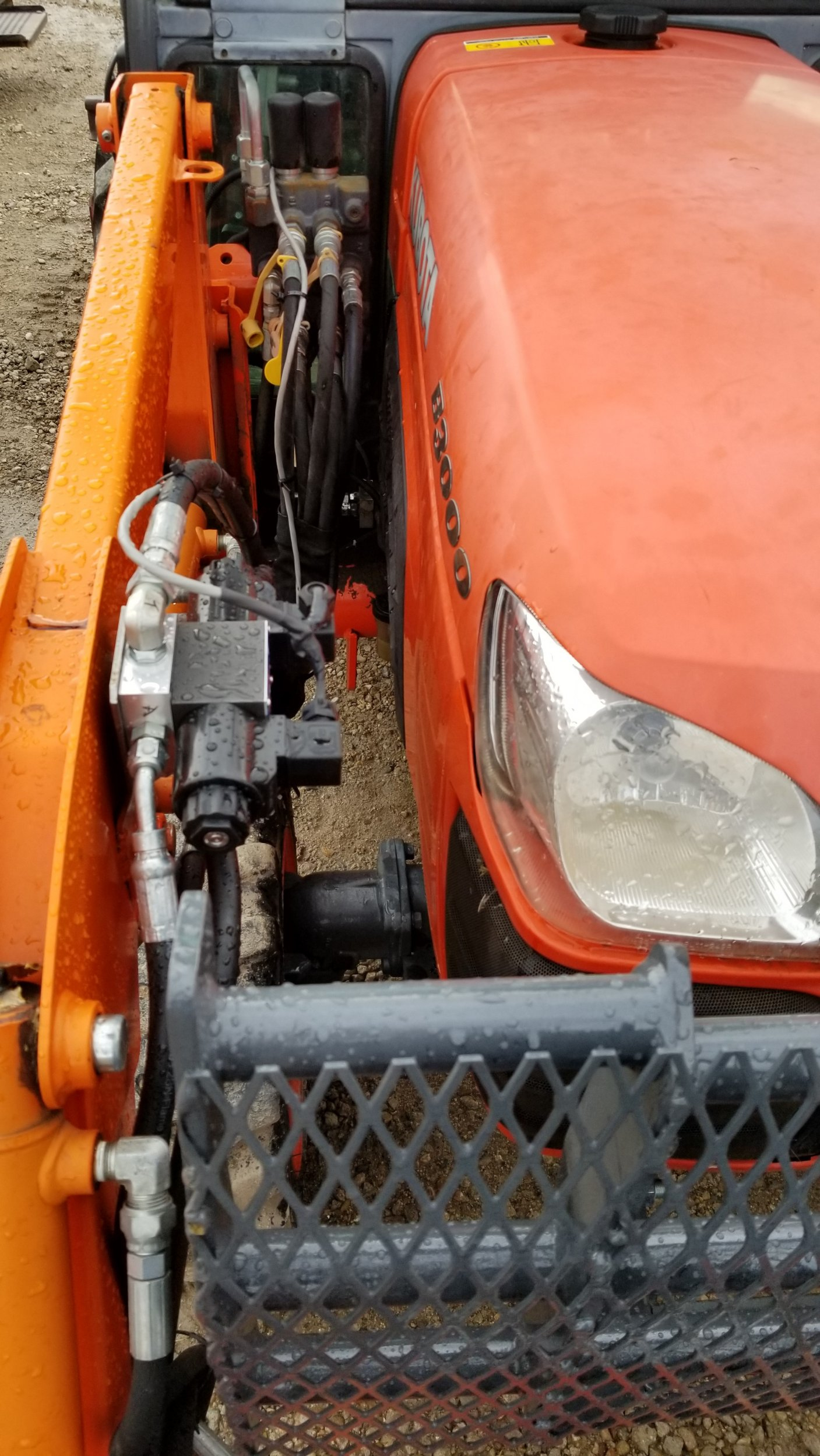

Hi , I have a b3030 with cab that had no hydraulic provisions for operating front end equipment. I bought the b2325 hydraulic kit , having trouble figuring out how to mount the unit to the tractor. I have the joy stick mounted in the cab , but the main unit is giving me mounting problems. Not sure if I have the right brackets , can't find much info online about it. I'm sure I'm not the first person to run into this problem , looks fairly easy to do once it's mounted. thank you

I assume you are talking about mounting the third function hydraulic valve! I have a B3000 and I mounted mine on the inside of the FEL arm with the quick disconnect mounted on the cross bar for the FEL.

I'm mounting the kit right beside the fuel tank and directly in front of the cab window. It looks very similar to yours that I can see in the first picture. My tractor didn't come with it from the factory , so I bought the kit . Doesn't seem like I have the right brackets for that location. Thanks
