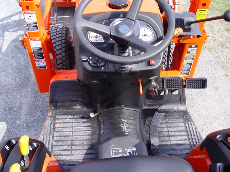

The last one is a view from the operator's seat.

Stef,
Thanks for taking the time to post the photos of the controls and floor...
I was surprised to see that silver thing (steering wheel adjust release) on the floor. And I assume the parking brake set lever next to the key. Had it been me, I would have switched the functions and put the parking brake set lever on the floor like the BX has. I set the position of my steering wheel once on my B2910 when it was delivered and forgot about it...For some reason I like foot operation better than the hand lever for the parking brake. Probably because when I push hard on the brake pedal on a hill, when I bend forward to set the brake, I slide back in the seat...
The cruise control on the B3030 sure is nice being out of the way like that. With the B2910 when I twist and look back to the left side, I always push the cruise control lever with my hip, and that causes the hst pedal to resist going down in the reverse direction. I like the B3030 better in this respect.
Only two speed ranges? With our hills I doubt I would like that. I generally keep my B2910 in mid range, and shift to low range when needed. I rarely use high range...and find low range too low to want to use it when grunt power is not needed. I would miss having the mid range gear selection...I notice with my BX I tend to keep it in low range, again probably because of our hills.
I see there are no detents in the slot for the PTO engage lever. How do you find it works when it engages? Are you able to feather it so it comes in smooth similar to what you could do with a foot clutch? Or does it come on with a jerk/suddenly perhaps similar to your experience with your former BX? Don't think there is an issue here, just curiosity...
Thanks again for the photos. They certainly give those of us who have the B2910/2710/7800 a feel for how the B3030 operator's station differs...

Henro, it has 3 speed ranges. The angle of the lever covers up the M in Stef"s picture. I learned something the other night about the cruise control. I got off the tractor, while it was running, and my jacket got hung up on the cruise lever. The tractor started moving towards my garage door. I got it stopped about 6" from the door. I won't make the same mistake twice.
   / B3030 arrival #36
<font color="blue">Henro, it has 3 speed ranges. The angle of the lever covers up the M in Stef"s picture. </font>
That's good to hear. I thought that might be the case...but got thrown off because my range selector has a "N" position on both sides of the middle range position... /forums/images/graemlins/blush.gif

Henro,
I use the steering wheel tilt pedal all the time. It's very convenient. /forums/images/graemlins/smile.gif
I'm sorry for the pic. As Bow said it has 3 speed ranges. Since I'm able to start the tractor when it's geared it doesn't bother me to have only one neutral. On a BX23, you must be on neutral to start the engine (that's a major point that I dislike the most about BX).
So far, I've used the mid pto only (MMM). All I can say is when I engage it slowly it's very smooth (if I engage it rapidly the engine doesn't stall but it slows down a great deal for a second). I'll be able to give you a better appreciation when I'll use a PHD or a tiller. In fact, BX and B3030 hydraulic PTO clutches are very similar. And yes, there's a detent but it's smaller than the one on a BX. It gives more room to slip the clutch.
