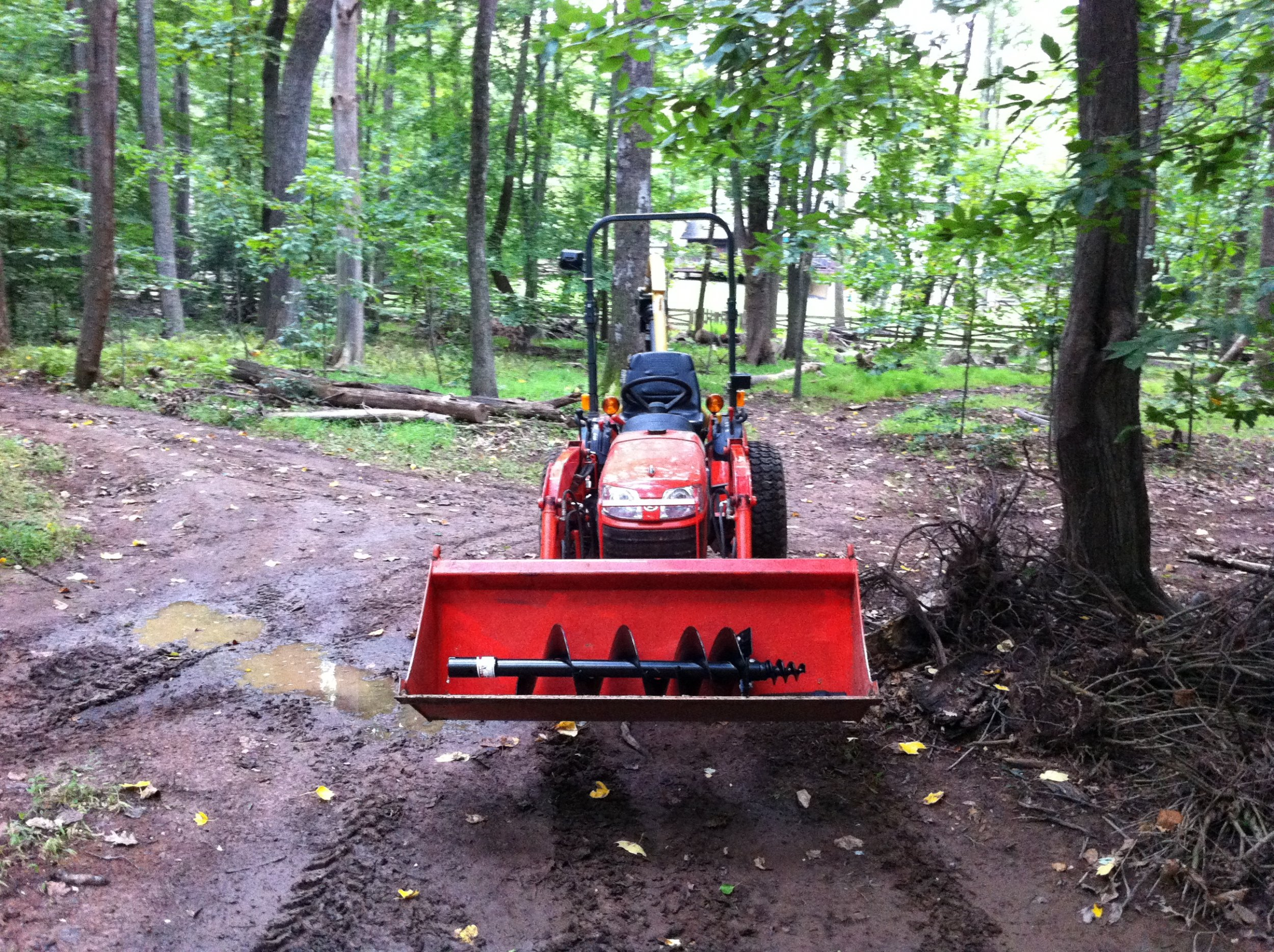

last night i was pushing some leaf piles back a little - zero load on the tractor and the rpms fell off , it barely ran then it stalled. i let it sit, it turned over slowly but wouldn't start. i let it sit longer and it slowly started then ran close to normal , then it was fine. scared the crap out of me because this unit has been flawless. any ideas on what may have caused it? other than bogging with the PTO chipper its never done anything similar. any ideas?
