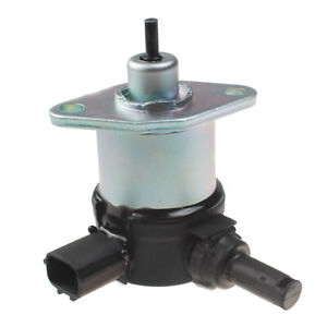

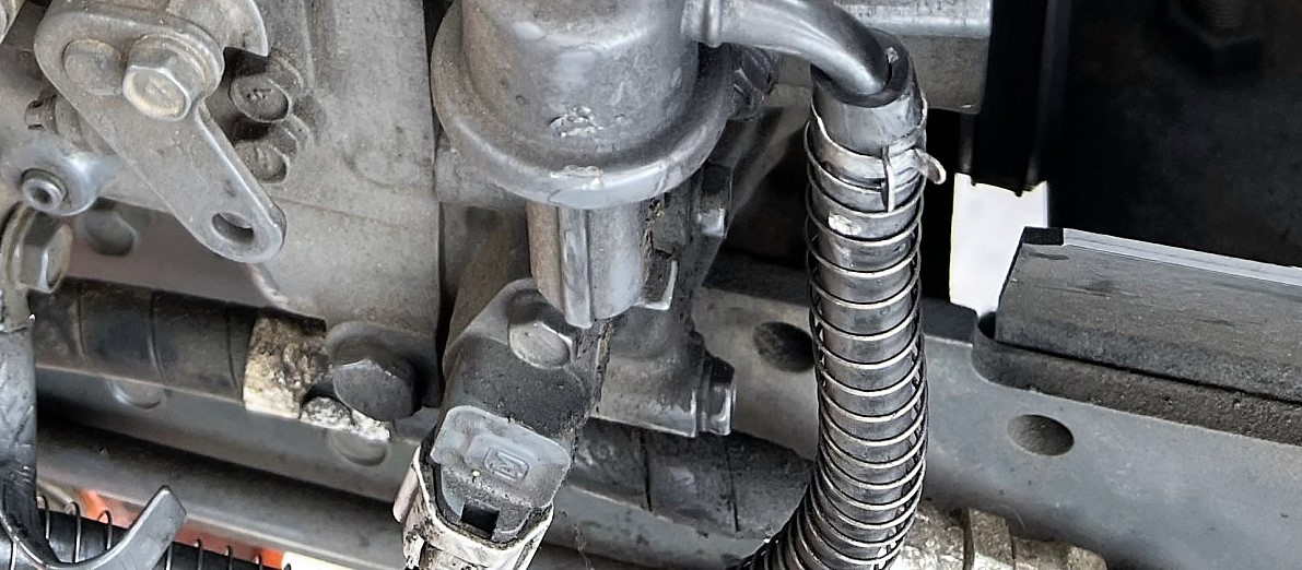

This looks like the solenoid.
   / B2650 stopped and won’t start #66
2nd picture is solenoid..
1st picture is supply pump.
To add a bit: if the solenoid has 1 wire.. it means it grounds thru the body..
So the body has to be touching something metal.. for it to complete the circuit.
No I was saying the bottom of the first picture looks like it. And this is his picture so that's all I had to work with.
