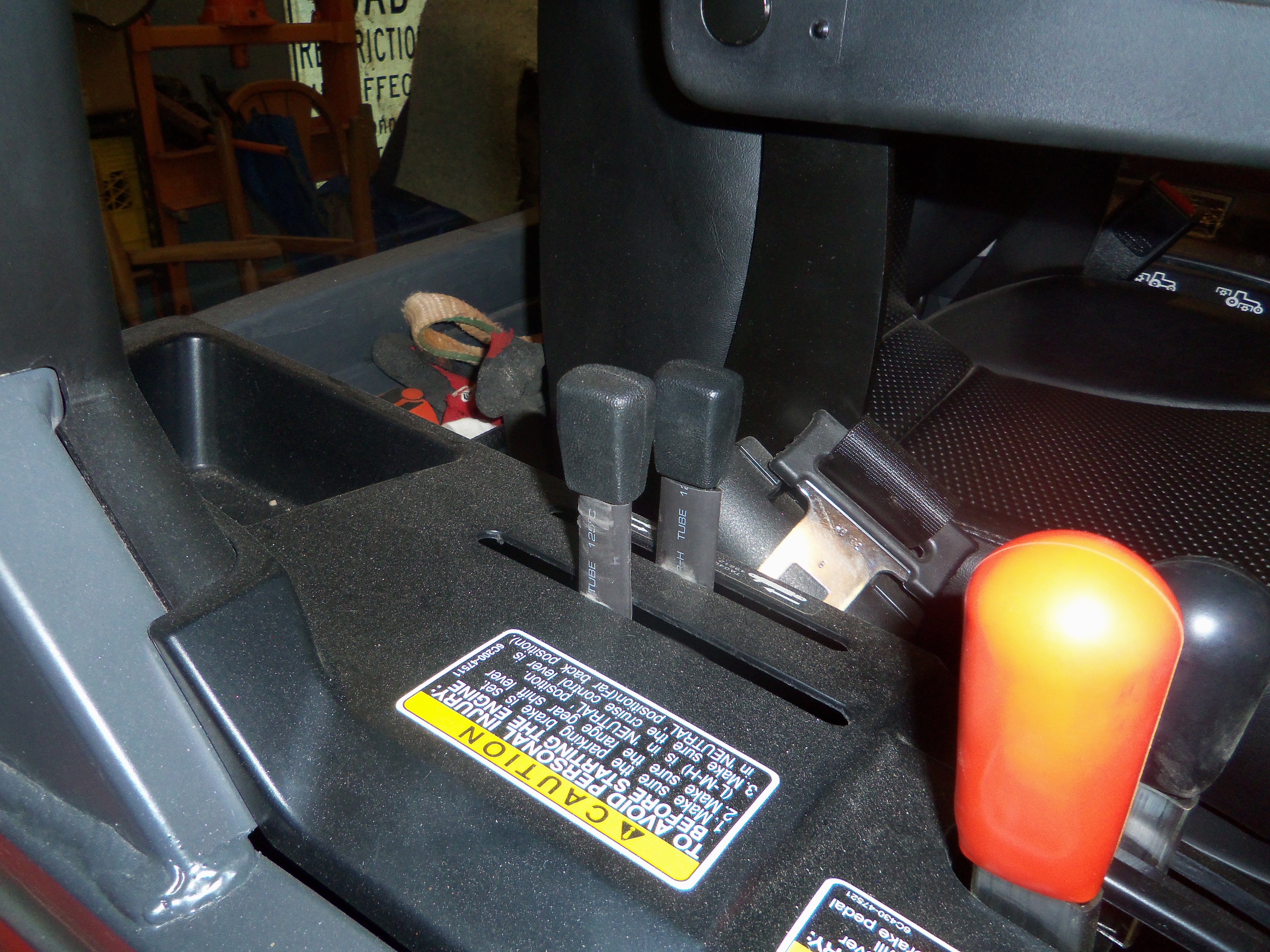

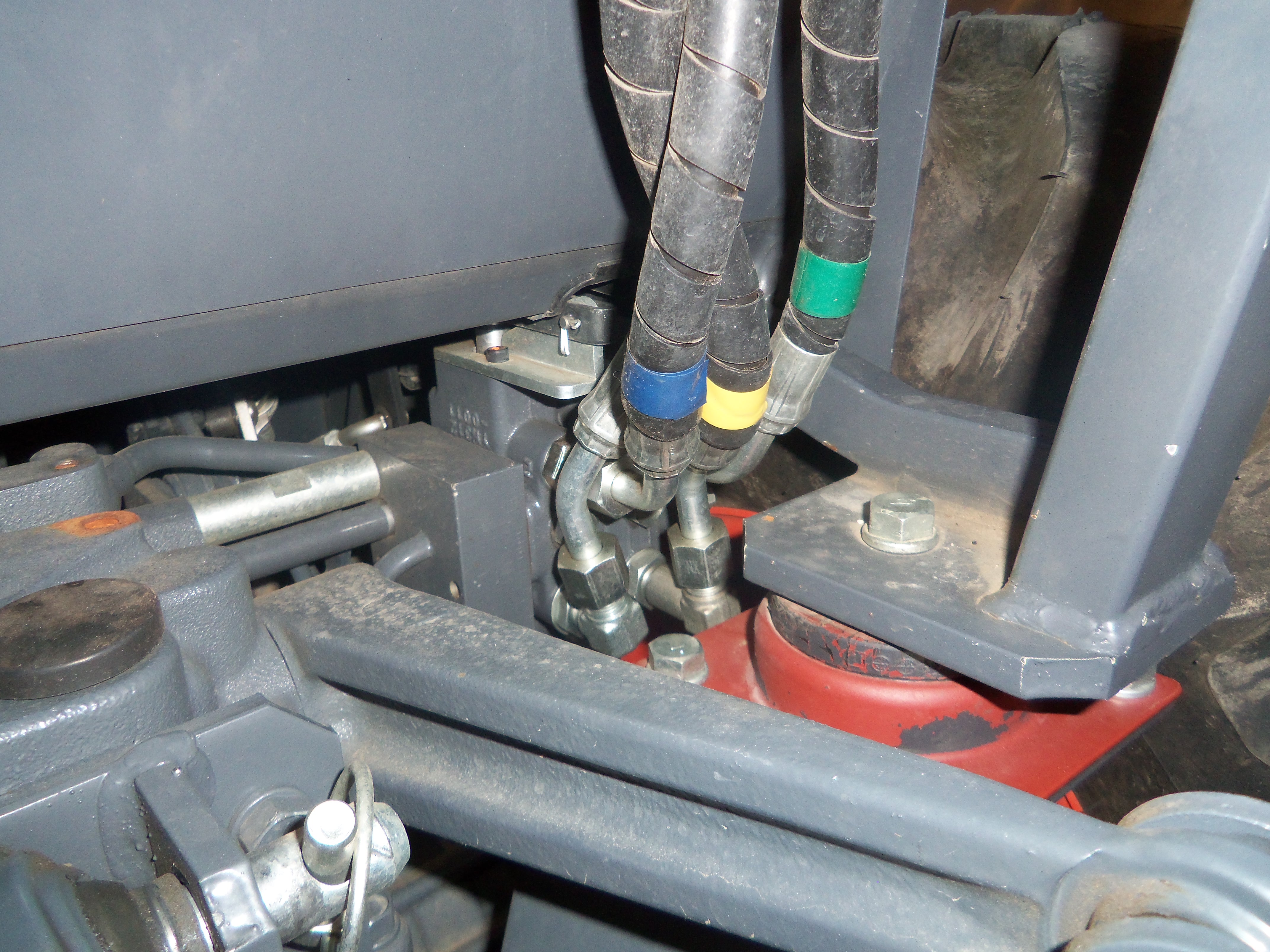

here some pic this is from my b2650 .This was installed but the dealer hope it helps you . The two small black leavers in the cab connect to the valve below. You see the 4 hose come up to the back conection .

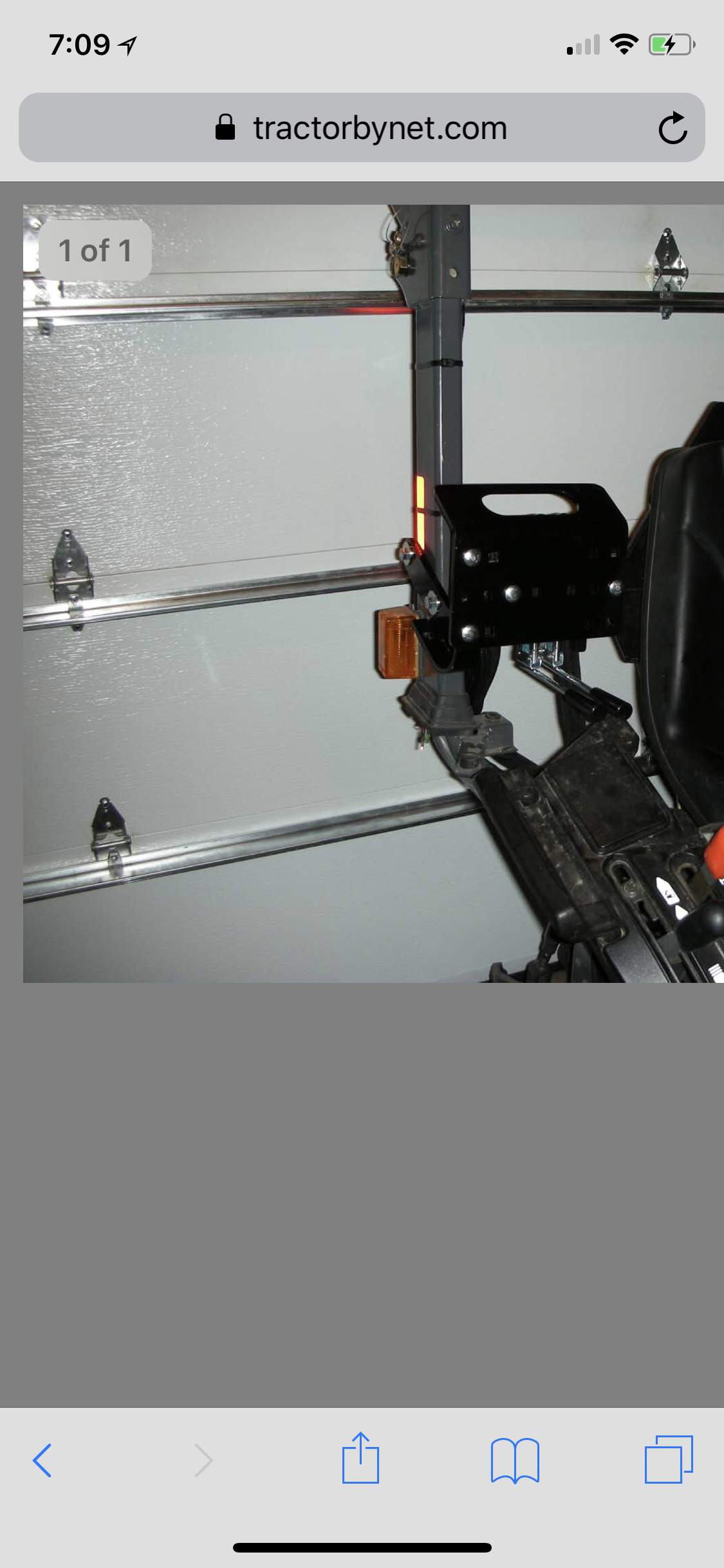

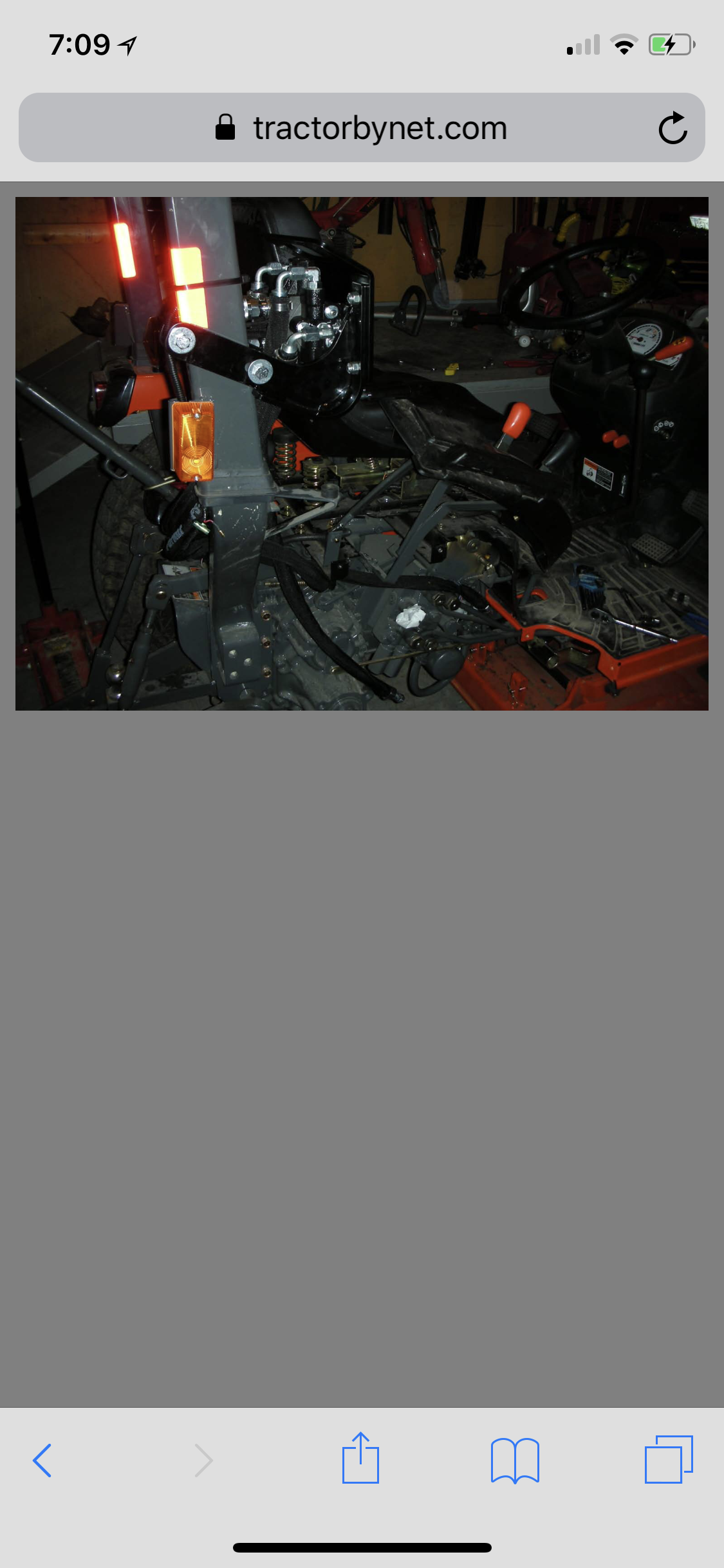

/ B2650 Remote hydraulic valve kit #7
This is what it will look like
And it痴 actually over 1200 with tax
/ B2650 Remote hydraulic valve kit #11
Oh my goodness! I have a BX2380 and an L6060 with rear remote hydraulics and they are very well designed and tidy looking. The set up in the picture looks like the Russians hacked into the designers brains! Thanks for the link to the picture. I can see why Kubota doesn't show that anywhere in there information on the B2650.
Yep it don't look good .

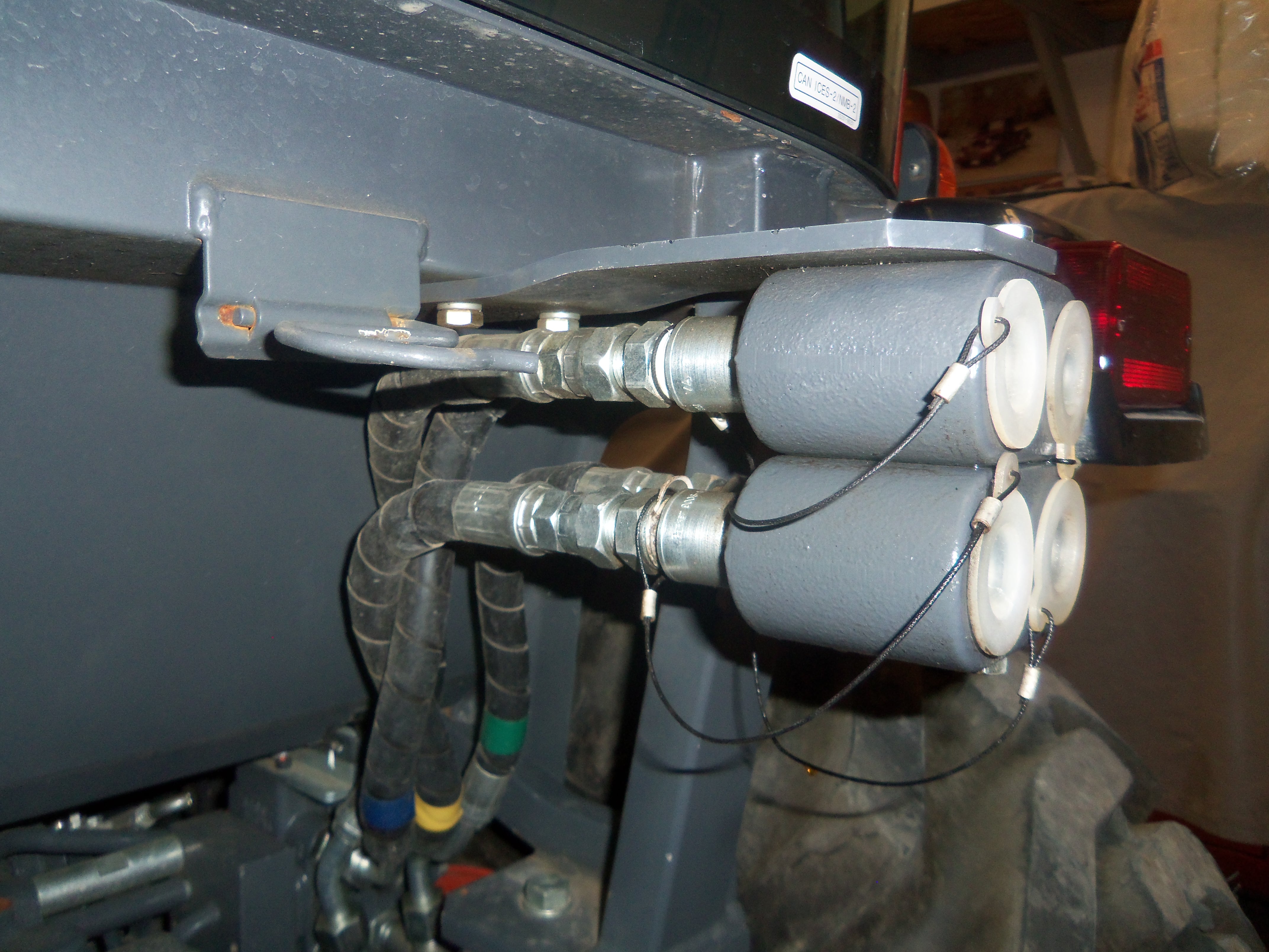

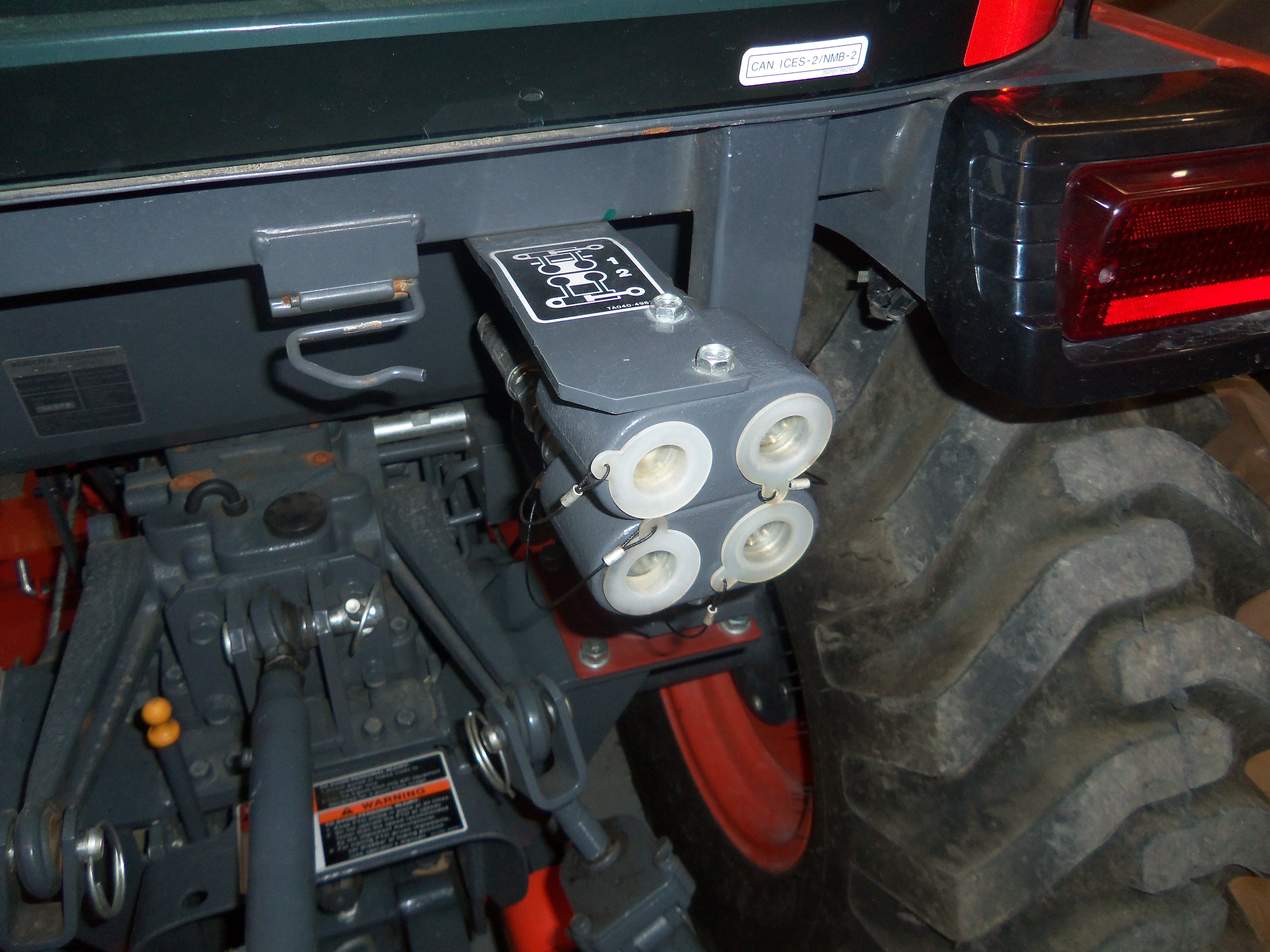

I do not know why it isn't engineered for adding the remote hydraulic valve kit. I have a picture that shows the coupler location and the operating levers, the valves are mounted on the right hand side of the transmission housing behind the rear wheel.

Thanks LT, I have seen the outlets, but the I was wondering if you had any pics of the actual valve under the fender area on the 80 series. Is it the same kit as the 70 series? It is cheap enough that I would entertain getting the kit and and then working though the hose/pipe issue and having the outlets come out the right side of the ROPS and maybe space out the lights an inch. I could integrate a light guard and put LED bulbs in, which should alleviate any vibration issues from the valves actuating. I am going to have to look under and take pics of the area under mine, as there isn't a lot about that area on the BX23S.
