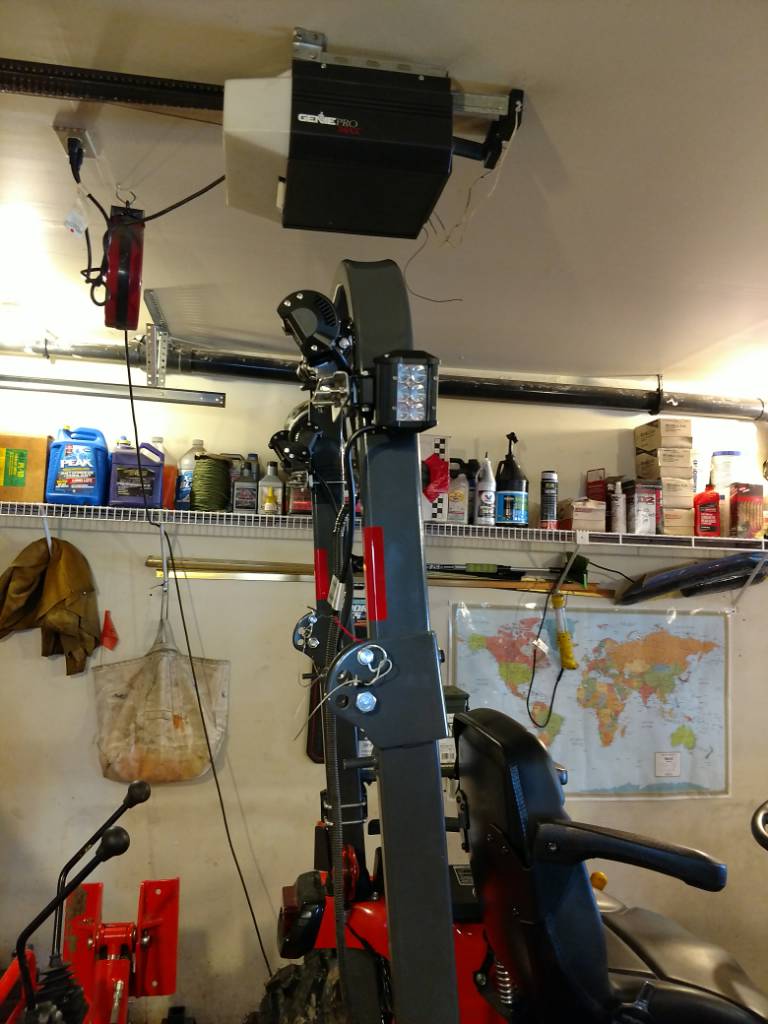

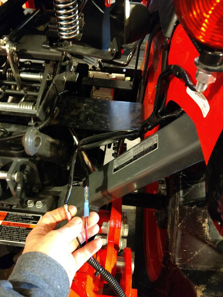

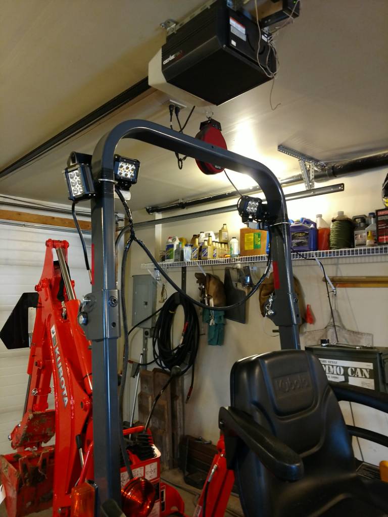

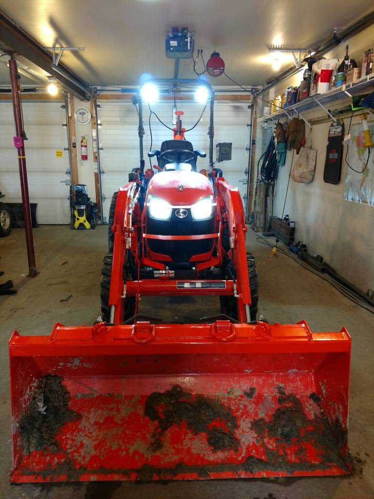

Dan, I swapped out the 23 watt/ 2 amp 1156 bulbs used in the headlight, flasher and side marker lights with Amazon LED versions that consume 0.17 amp each. So that is six bulbs, 1.9 amp each, so I removed 11.4 amps of bulbs and put in 1.02 amps of LED bulbs. Let's say that I made back 10 amps.
Now I am installing 6 x 18 watt NiLight LED cubes, 1.5 amps each, or 9 amps total. I'm actually ahead of the game by 1 amp compared to stock.
There is a 10 amp fuse circuit at the rear right side, you'll see the labeled tag sticking out of the wire bundle there, you'll peel the tape off to free the male and female terminals and run them through a toggle switch. I'm mounting the switch on my right side plastic fender cover, right beside the little cell phone pocket.
So I'll be able to hit that switch and pass the 12 volts up to the 6 cubes that will be creating a 360° halo of light around the machine.

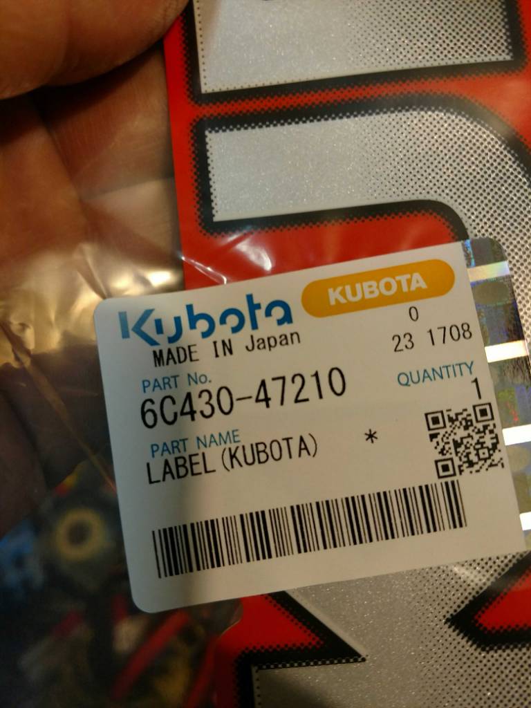

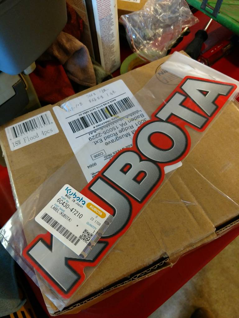

Oh, and if you want to order some stickers, this part number shown in the photo is for the hood of the B2650, there are 3 versions available, each with very different price. This sticker happens to be a dead ringer for what I have on my machine and they are under $3 each, so I ordered a dozen! My implements that have been repainted Kubota orange will be getting these, also I'm putting one in the back window of my truck. For around $2.75 each, heck yes.... I'll take a dozen! IMG_20180203_114931134.jpgIMG_20180203_123458178.jpgIMG_20180203_131919079.jpgIMG_20180203_131942773.jpgIMG_20180203_133321117.jpgIMG_20180203_133218819.jpgIMG_20180203_133231550_HDR.jpgIMG_20180203_132016950.jpg

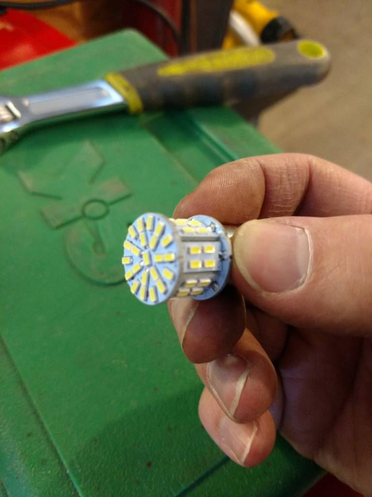

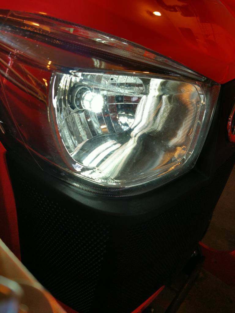

The red tail lights are not. They are smaller globes over what looks identical to an 1156 base, but the 1156 LED will not light up in the socket. But the other 6, headlight, round flashers, and yellow side markers are all 1156. There is no marking on those smaller bulbs in the red tail light housing, do I'll have to get time to Google around looking for an LED solution to those. If you beat me to it, please tell me.
I'm attaching a close up the EFoxCity 0.17 amp LED bulbs I'm using.1517685038735.jpg

Oh... And check it out! The stickers are total kick butt! Grab that part number from the package and tell them to order you a half dozen, should be around $14 for a half dozen.1517685128296.jpgIMG_20180203_132016950.jpg1517685228147.jpg
