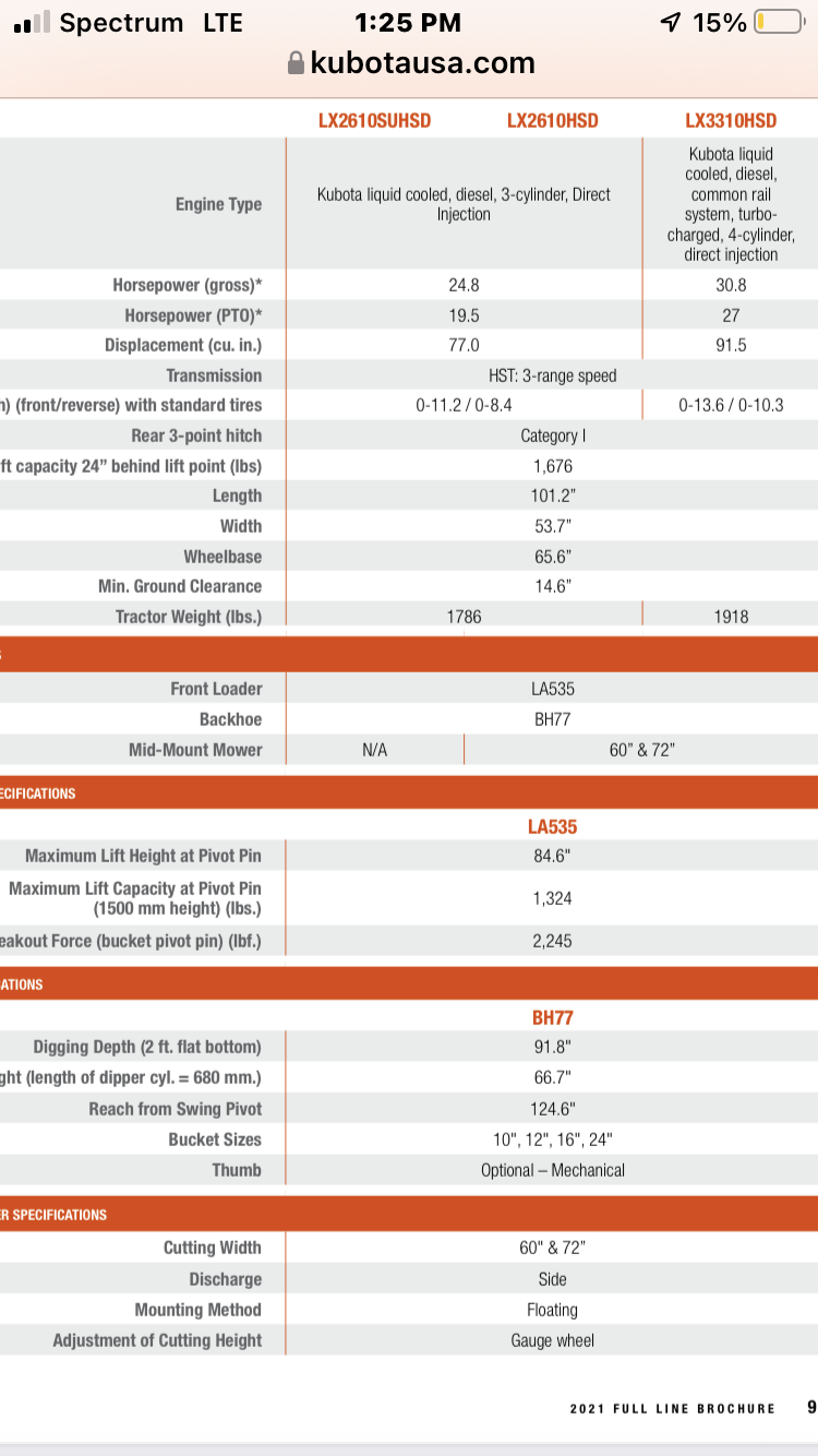

Thoughts on the LX2610hsd which seems to have the lift and the mid-mower option?
/ B2601hsd for small horse farm? #9
Thoughts on the LX2610hsd which seems to have the lift and the mid-mower option? View attachment 734781
It will lift 770 pounds at 19 inches but you will want additional ballast on the three point to handle round bales. If you store your winter's supply like we do, you can put the heavier bales on the bottom. I think it would be a good compromise with the caveat that you get a substantial ballast for the three point hitch and loaded tires. With heavy bales you will be operating the tractor at or slightly over its designed limits.
